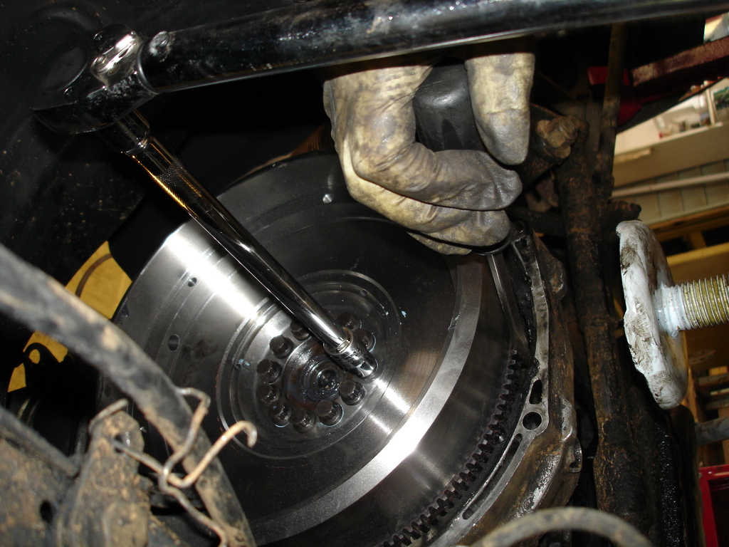

I am using the 300GD FW in my car with manual trans from 240d.
http://www.superturbodiesel.com/images/benz/w123%20clutch%20upgrade/
[Image: Rolf%20019.jpg]
If anyone goes with a 300GD FW on a W123 I recommend splitting the difference in weight at the machine shop. My off the line torque increased and my top end HP decreased.
