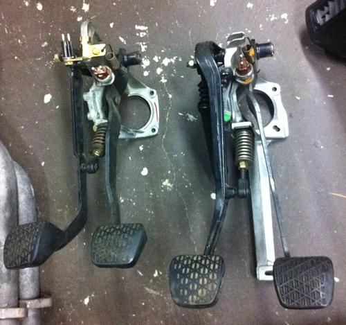

300SDL 4 speed swap?? - Nick - 10-22-2011 Anyone heard of or seen this swap done? I found an 300SDL with the 617 turbo and I already have a Getrag 4 speed, clutch kit, pedal assembly, etc.. I've just never seen this done before.. I've been searching the net for weeks, opinions? RE: 300SDL 4 speed swap?? - aaa - 10-23-2011 http://www.peachparts.com/shopforum/diesel-discussion/276987-installing-new-engine-manual-transmission-my-sd.html I'm wondering if your driveshaft would be different. Or what driveshaft is even in there, 300SDLs didn't come with 617s to start with so somebody rearranged stuff. RE: 300SDL 4 speed swap?? - willbhere4u - 10-23-2011 usually the 300SD came with the om617 and the 300SDL had the om603 I am currently putting a 6 spd manual in an 300SDL with om603 The hardest part was finding a manual pedal set they only came with manual transmission in the European hotel cars. some people have said you can modify the w123 pedal set but its quite a bit different I'll post a pic of the differences w123 to the LH / W126 to the RH |
