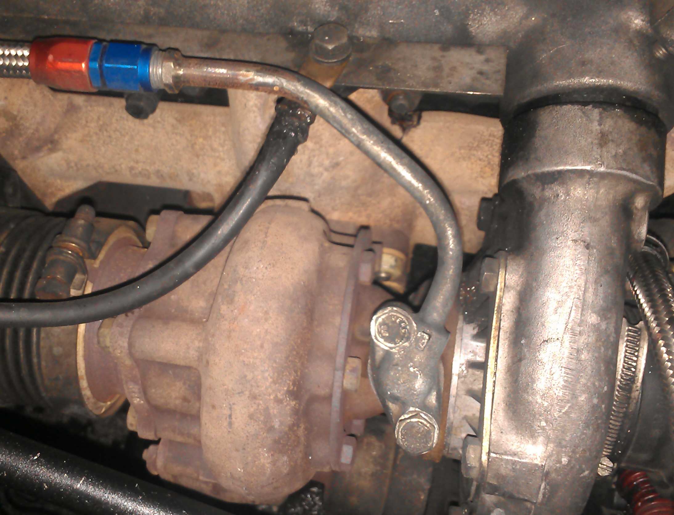

RE: DELETING the OEM Oil Filter Housing - wagonfreak - 12-14-2012
Hello new to the talking part of this site but be readding for years i was just wondering surfrodder if u can show how u connected the hose to the turbo im building about to build a setup like this since my oil filter housing is cracked dont know how that happened just glad i caught it before i ran out of oil in the motor that would suck any who just going to plead for more pictures and what size are the fittings for the oil cooler
RE: DELETING the OEM Oil Filter Housing - SurfRodder - 12-14-2012
(12-14-2012, 03:04 AM)wagonfreak can show how u connected the hose to the turbo
I got a spare fitting from the wrecking yard and had a AN-6 weld on fitting welded to it... then ran the -6 hose and fitting to T-adapter fitting on my block-off plate...
all the other oil hoses are -10... I probably would have run -12 personally, but I didnt find a -12 oil filter adapter...the site I linked for the t-stat has a -12 version.
Anyway, after seeing the diameter of the oil ports on the block, -10 is fine... if I ever to a full teardown on this engine, ill probably tap the block for pipe threads and eliminate the block-off plate, at least the pressure part of it, likely still have a thin one to keep dust and water from getting in.

anyway, ill try to remeber to take a pic later of the fitting, but its pretty simple, a steel weld-on AN -6 fitting/nipple welded onto a junkyard turbo feed fitting/tube... they probably even make something a little more elegant, like directly from the turbo feed to -6, but I have a turbo upgrade in the works as well, so I went with what was easier to make happen (for me at least, YMMV)
update: here's a pic, I've gotta final today so I likely will forget to do it later:
