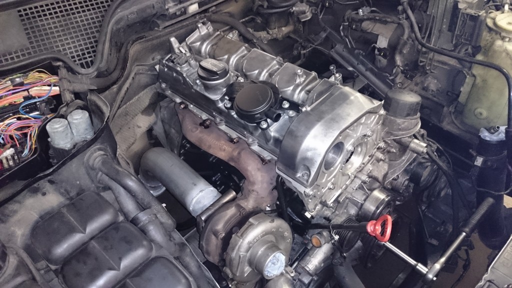

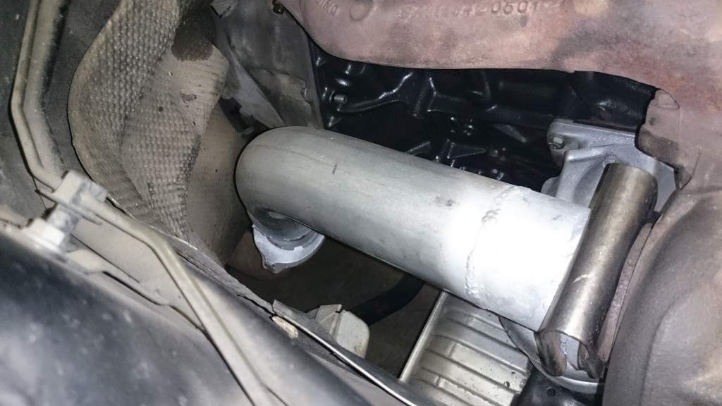

RE: Big exhaust on your Mercs! PICS - Sultzi - 04-24-2016
4" downpipe to 2x3" Smile Overkill? Yes, very much for the 2x3" section, downpipe better to be big enough than too small..

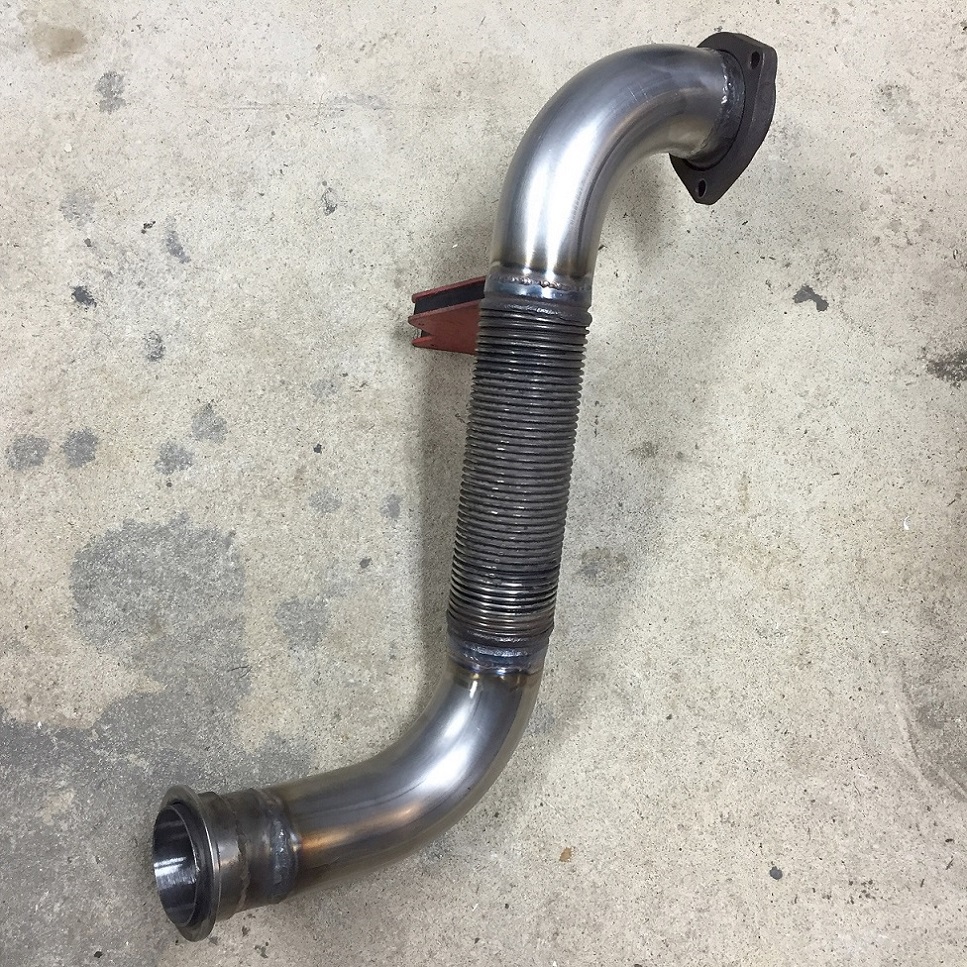

Not big by any means but the I redid the downpipe on my as the stock MB DP was hitting the bulkhead.
I took pieces of the stock DP (turbo flange and flex section) and added 2.5" SS 90° bends.  The rest of my exhaust is 2.5" mandrel bent stainless with V-Clamps.
Maybe down the road I will do 3" but even the 2.5" is close to the bulkhead and the front driveshaft.
