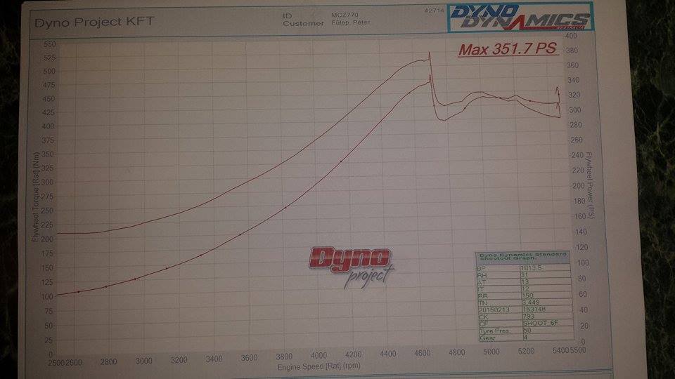

Yes, the max rpm now is 6000. That sound! 9out10 thinks its an Audi 2.2 turbo until they see it Big Grin
Remap changed everything. Spool now starts at 2600rpm in 3rd gear and 4000 is full boost. I am so relieved... I was afraid it is gonne be usless piece of sh_t and now it has turned into holy sh_t Big Grin
Cant wait to make new videos but in this weather, it spins the wheels even at motorway speed Confused

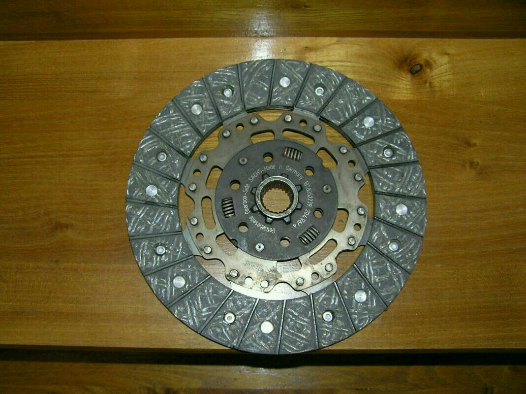

visor, what clutch kit are u using? still with the stock 5 speed manual?

Stock 5 speed manual and the clutch is what we call cevlar (actually made of the material like truck clutches). My friend makes them mostly for TDI models but can order any size I guess. It is good till 500-800Nm (depending on diameter) and costs around €30.
(01-29-2015, 05:04 PM)raidaru visor, what clutch kit are u using? still with the stock 5 speed manual?

Do you maybe mean kevlar?

Yes kevlar. But it is not actual kevlar, because thar proved to be bad in city traffic. Looks like this (this one is in my Golf)

02-13-2015, 11:28 AM #73
I had the time today to put the car back on the dyno. Still lack of fuel in the upper rpm region but I am satisfied with the numbers still.
351 HP / 510 Nm
GRAPH: http://postimg.org/image/sqxb38dnv/

02-13-2015, 01:28 PM #74
The maximum boost on the dyno was 1.8bar?
bruno_pinho
seanyt
is300d He351ve
279
02-13-2015, 02:45 PM #75
Why the fuel drop at 4700rpm
Is there still a torque or fuel limit in the ecu map?
seanyt
ViSoR
34
02-13-2015, 05:41 PM #76
(02-13-2015, 01:28 PM)bruno_pinho The maximum boost on the dyno was 1.8bar?
Yes.

ViSoR
34
02-13-2015, 05:43 PM #77
(02-13-2015, 02:45 PM)seanyt Why the fuel drop at 4700rpm
I think thats the end of the pump. No more fuel. Upgrading from 6mm to 7mm gave +90HP
Is there a stronger OM605 with Kontor 7mm elements?

seanyt
is300d He351ve
279
02-13-2015, 07:14 PM #78
Looks too sudden for pump fuel limit.
Looks like the ecu or maybe lift pump is contributing.
I'm more thinking ecu as it seems to hold the fuelling at a set limit. After that point.
It also coincides with mantaheads limit on his edc at 4700rpm
seanyt
bruno_pinho
166
02-14-2015, 06:13 AM #79
Why you did not do a dyno with 2 bar of boost? See smoke for that.
bruno_pinho

ViSoR
34
03-03-2015, 08:45 AM #81
If I remember correctly, the exhaust is 55/65mm.
Bruno: 1.8 bar was the max what we could squeez out, almost closed WG. From 4000 rom there is only a bit of smoke left.

bruno_pinho
166
03-03-2015, 01:28 PM #82
I do not understand because it does not more pressure ... with closed wastegate had to do more ...

Ksteen2
304
03-05-2015, 05:19 AM #83
I think you have to small exhaust and need a new manifold, thats why you did'nt get more power.
hansebanger77 did 414hp in 606 with 7mm 120cc ppd pump.

Larotj
5
03-05-2015, 03:05 PM #84
well he got already more horsepower per cylinder (414/6=69 and 350/5=70) pretty impressive numbers for an 2.5l diesel.
i hope you figure out where is the problem right now, do you monitor backpressur from the exhaust?

Update:
We have remapped the ECU, the vehicle is a beast! Smile Revlimit is at 6000 rpm now.
Unfortunately I was right about the exhaust. Upgrading from 60mm to 76mm, didn't do anything! No boost pressure change, no power gain, no faster spool, no nothing. A bit quieter I guess... I give you my word, an open 60mm exhaust is far enough till ~350HP!
Next week I will make you new a video, I couldn't get the car from the mechanic yet because it starts badly. The fuel flows back from the pump to the tank, because some fuelvalve fault since the element change. Fix that, and than I will go to dyno again.

ViSoR
34
03-13-2015, 06:00 PM #88
(03-05-2015, 03:05 PM)Larotj well he got already more horsepower per cylinder (414/6=69 and 350/5=70) pretty impressive numbers for an 2.5l diesel.
Phil
Oh no, we did not monitor anything. But with these sizes I dont think too large emap is the problem. You ccould shout thru this turbine thats how big it is Smile

Turbo
489
03-16-2015, 07:41 AM #91
the dyno graf show maximum 5500 and not 6000, why is that?
what MAP-sensor are you using, Manifold Absolute Pressure,?
what is the fuel pressure before the injectionpump?

03-19-2015, 06:09 PM #94
(03-16-2015, 07:41 AM)Turbo the dyno graf show maximum 5500 and not 6000, why is that?
We measured the car 4 times. Maybe the dyno guy didn't rev it on this graph till revlimit, because there was no more power gain over 5000rpm. We even measured without the €10 sport air filter, the powergain was 0,5HP Big Grin
Everything is OEM. Sensors, manifold, cooler, piping etc.I dont know anything about the fuel pressure, maybe that is way the power drops at high rpms.
This post was last modified: 03-19-2015, 06:35 PM by ViSoR.
