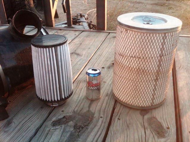

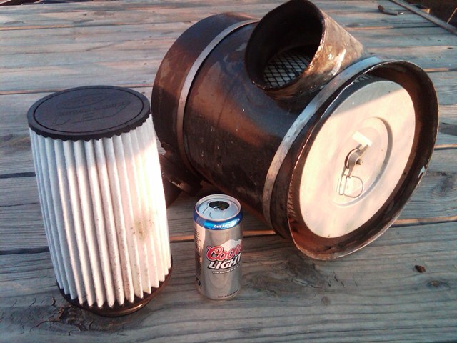

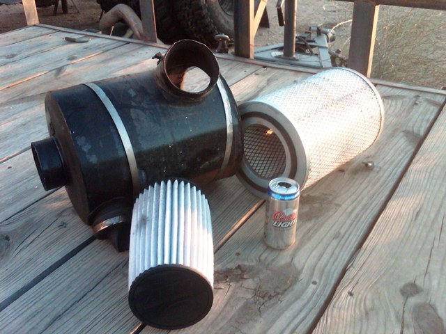

07-23-2010, 04:42 PM #29
w115 NA intake.
This is the big ass filter I plan on squeezing behind the right headlight. The top of the airbox has to be the hood and the walls are going to be a bent sheet of aluminum with weatherstripping on the top and bottom. The outlet is 4", I do know it's overkill. But who has fun following the rules now? It will be accompanied by a Mann-Hummel Provent 200 and some tubing.
[attachment=3195][attachment=3196]
This post was last modified: 07-23-2010, 04:45 PM by rdirtycar.

07-23-2010, 05:24 PM #30
I'll will post my big ass filter when I get home. i think I got you beat lol.
Ps I want an intake like that one! its super clean!!!!
07-23-2010, 10:31 PM #31
Lol, Air filter wars!
Umm the big ass one on the right is from a '92 Hummer H1. Measures 6" Diameter
The other on is From My Sprint, a nice AEM dry filter...
