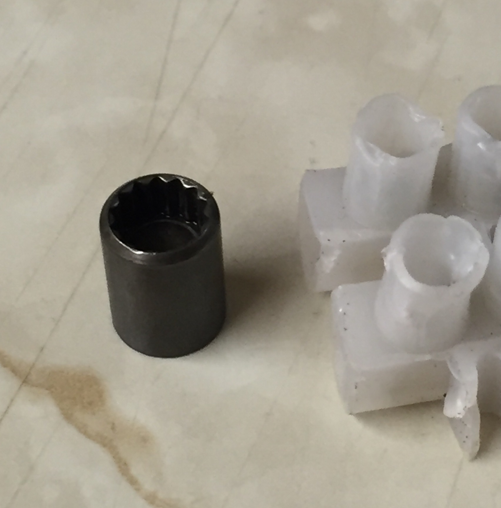

Ok... So I pulled the pump apart this evening, and the Spring was nothing at all like the one above, it was 50mm long and the valve system didn't look like above at all, so I took 1.5 coils off the spring and put it back in.
If my power steering works, great, and I'll have reduced the pressure to a point. If it doesn't work, I'll just have to get another spring. We'll see what happens.
Also, Baldur, I really hope this is the piece you were talking about,
(the connector block is just for scale) between the PAS and SLS pump, because if not I'm in trouble! Another think, DO NOT open the back of the pump when it's in a bench vice, the inside of the pump will fall out all over the workshop floor and you'll spend 15 mins looking for the 10 little pieces of pump internal, before cleaning them and trying to put it all back together!

Yes that's the right bit. I did the same, bits fell on to the garage floor goo mixture of swarf, sawdust & axle grease.
