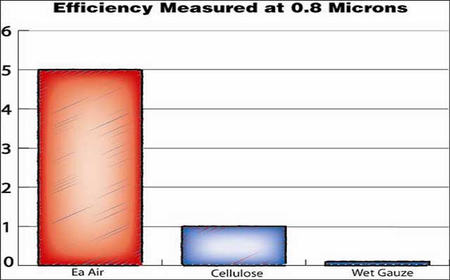

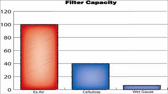

I've been looking at this filter for a while. Their marketing material has me sold on it. But I would still like to see some independent tests.
I've been contemplating using a modified form of this filter in a '85 Cali box.
Amsoil claims better efficiency.
Amsoil claims better holding capacity.

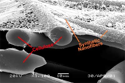

01-23-2010, 10:39 AM #4
Its a rip-off of the material used by Donaldson in their Powercore filters. The big difference is the PC filters have more like 100x the surface area of that cone.
