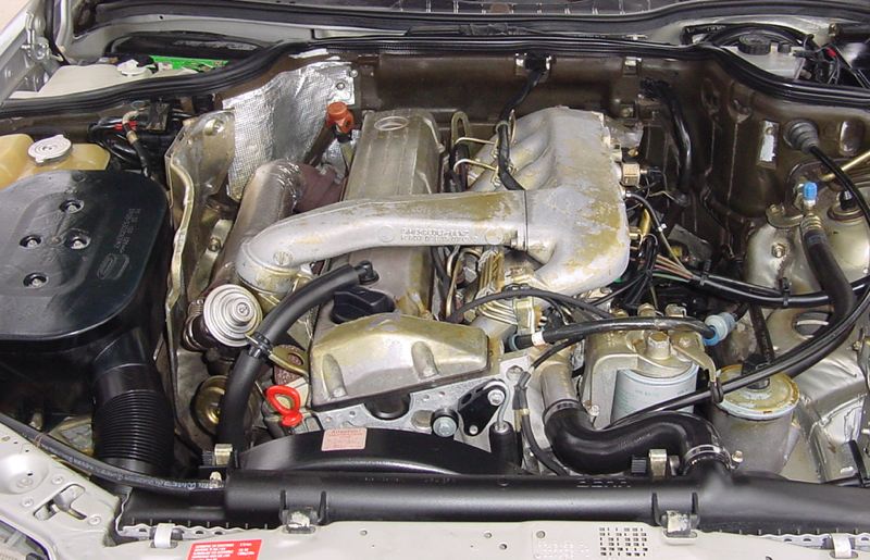

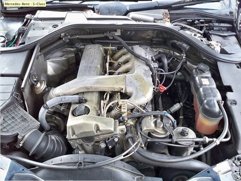

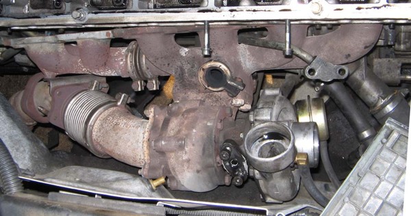

02-15-2010, 06:10 PM #6
Yes. Here you can see the difference.
W126 and W124
W140 3.5L
The manifold itself.
