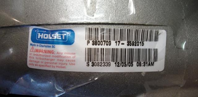

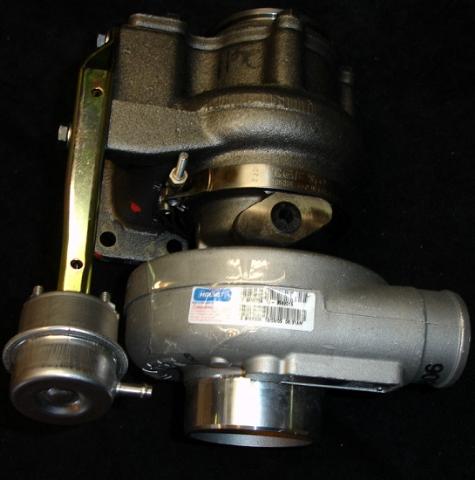

(04-06-2010, 01:39 AM)ForcedInduction
(04-06-2010, 01:32 AM)Deni What cars are these turbos used on?
They are only used on Cummins engines.
Which cummins engine, or truck, was the HX/HY30 used in.
Thanks
Deni
1992 Mercedes 190D 2.5 turbo 5sp manual. EGT+boost gauges. Boost controller set to ~14.5 psi. 1 1/4 turns on full load adjustment. LPG injection.
[Image: 3803751914_8fdca63138_o.jpg]
Deni
04-06-2010, 03:24 AM #16
Thanks
Deni
04-06-2010, 03:29 AM #17
It was an option on the 4BT, 4BTA, 4BTAA and ISB3.9. Rare though.
This post was last modified: 04-06-2010, 03:31 AM by ForcedInduction.
