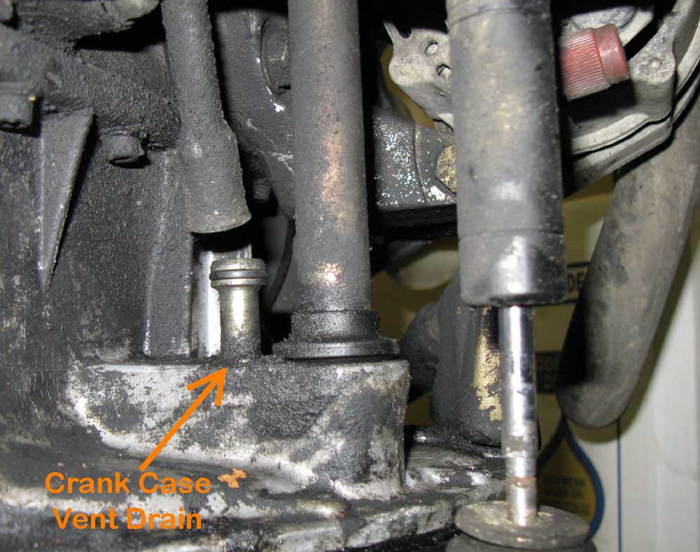

Another note is if the '85 is a Cali, it will not have a drain hole for the crankcase vent oil separator.

There is a RPM sensor on both the front balancer and flywheel. You can use the front sensor just fine with your '83. For the rear, remove the sensor at the flywheel and make a small plate to cover up the hole. That sensor is a magnet and will collect debris if left there.

DV- what's the extra oil drain port you refer to? Would that be in the cast pan next to the turbo drain? I'm planning to tap a hole there for my separator to drain into

Yes it is next to the turbo oil drain. See pic I took of the drain. (Sorry, I need to clean this motor)
