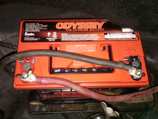

09-08-2010, 02:36 AM #36
more battery woes. put a fresh battery in today. replaced the ground strap, confirmed good ground (almost zero resistance between battery negative and the body). but the battery is not charging at all - driving around with the headlights on drained the battery down SUPER low. no voltage change when revving the engine. i replaced all the belts today, and tensioned everything real good. went ahead and left the a/c belt off for now since the climate control unit isnt working anyway.
going to try and replace the voltage regulator even though i looked and the graphite contacts are totally fine. if that's not the issue, then idkwtflol.
emailing back and forth with propigskin, going to probably pull the trigger on those springs with 2.5" extra length, and then order some bilstein HDs. right now my rear end is LOWWWWWRYDERRRR status. sucks going over anything at all. even driveways.
got a pair of hella 700ff driving lights, which i'll mount as soon as i can actually power them without killing my battery.
soon as kragen gets my zerex g-05, going to do a citrus flush and fill up with fancy proper coolant. also replacing all the fuses, and doing an oil change, once my package from partsgeek arrives.
stan

09-08-2010, 04:40 PM #37
tracked down a voltage regulator at the highway robbery price of $44.99. it didn't fix the problem though, still not charging while running. i think i'm going to crawl under with the engine running to see what the voltage is on the alternator contacts
yargh!

09-08-2010, 08:42 PM #38
That is ridiculius you can get an alt for not much more. Did you measure voltage off the alternator?
stan
328
09-08-2010, 09:20 PM #39
looks like the alt is dead. with the new voltage regulator in, the alt is not doing shit. to see if it was a grounding issue, i connected a jumper cable between the body of the alternator, and the negative terminal of the battery. no change. put one probe on the negative battery terminal and then probed the wires at the alternator, still just battery voltage. so it looks like the thing is fucked. i was able to return the voltage regulator, thankfully.
now i'm looking at ordering a bosch al129x alternator so i can get 115 amps instead of shitty shit 55amps. this means i will have enough power for MANY LIGHTS lol. soon as the wiring issues are sorted, i have to figure out where to mount the pair of hellas i already got. i'm thinking in front of the grill but it pains me to drill holes in the bumper.....
still deciding whether to buy sls delete springs (225) and bilstein HDs (140ish) or dick around with the SLS.....
stan

09-10-2010, 09:16 PM #47
got the alternator! it's all shiny and coooool!
next order of business is the harness for it. i need to get wiring to connect it direct to the battery, and i am also going to use a junction since my car does not currently have one. with the junction i will connect the stock connectors in (so my battery light works). i will also use the junction box to connect to any new wiring (driving lights, amps, etc) so i can leave the stock fuses alone and not add extra load to the stock harness. this is good because it means no permanent modifications to the car, and it will be very beefy and over-engineered.
is there a good way for me to go about connecting 2 things to the battery's positive terminal? i'm looking at getting a connector so i can just use 2 wires, unless there is a better way....

09-10-2010, 09:35 PM #48
Get marine battery posts...
Or a marine Battery...
Or a battery with side posts...
