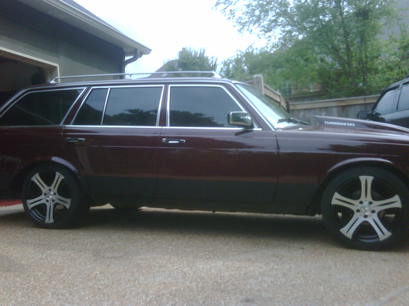

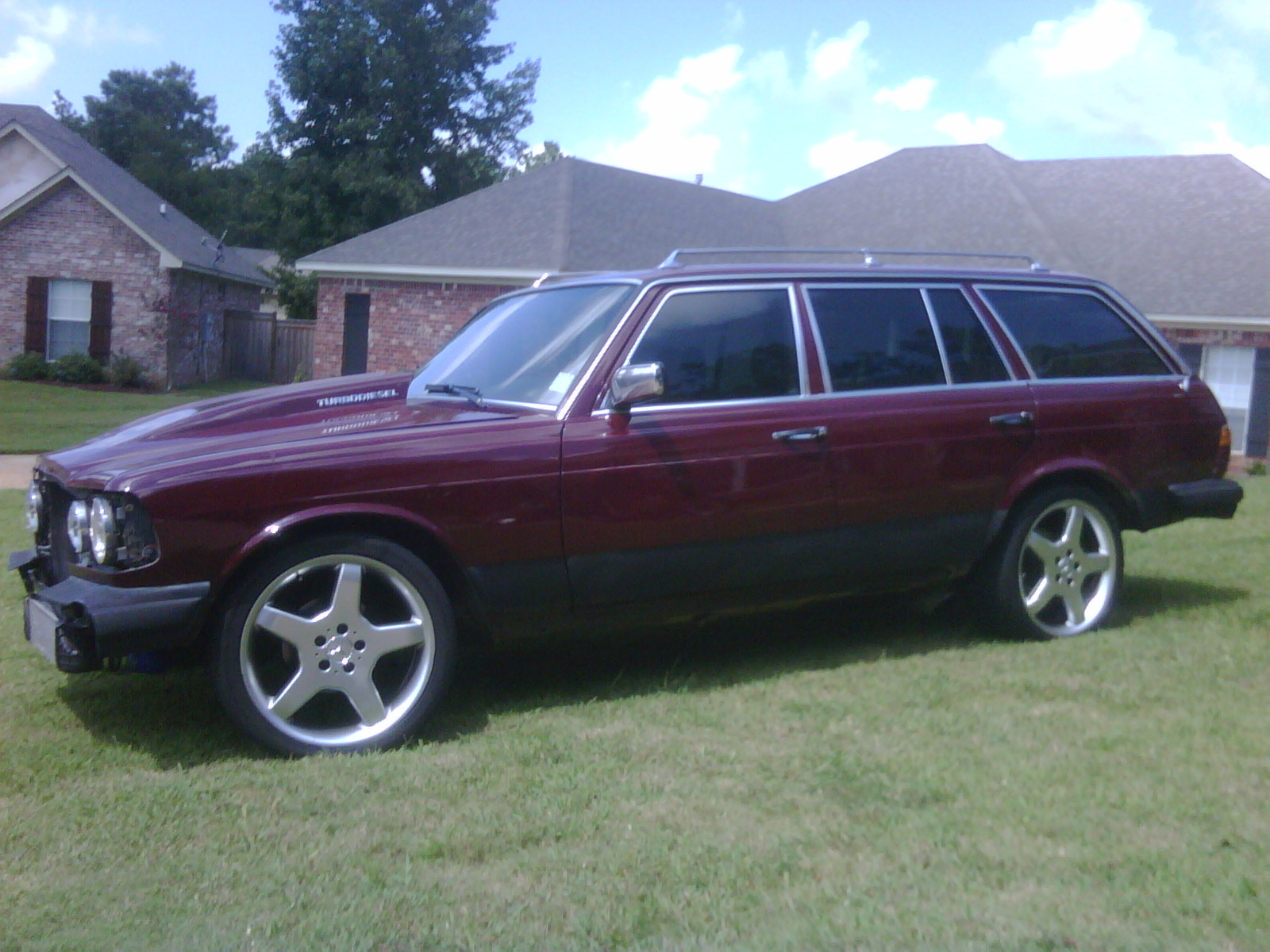

MB TECH
188
10-13-2010, 08:24 PM #5
Picture of wagon with 19s
Or a pic with 18s
This post was last modified: 10-13-2010, 08:26 PM by MB TECH.

MB TECH
Or a pic with 18s

MB TECH
188
10-22-2010, 06:05 AM #7
CLS class wheels for the 18s, this set does not require wheel spacers to clear the bearing caps. Most E class wheels you need spacers up front for center caps to clear.
The 19s are just amg knock offs from tire rack, cheap cost cheap wheel (you get what you pay for)
This post was last modified: 10-22-2010, 06:07 AM by MB TECH.
