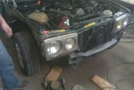

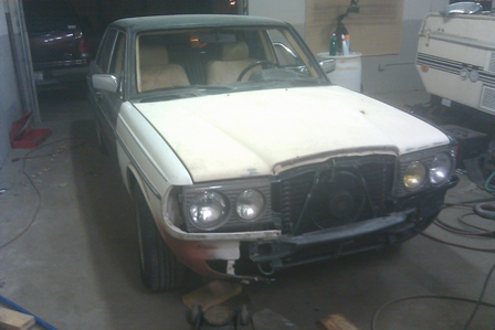

10-30-2010, 09:51 PM #6

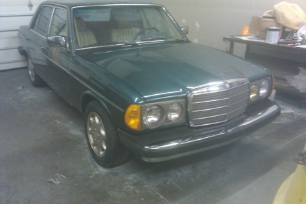

Why do I like the look with only headlights and nothing else????
10-30-2010, 09:55 PM #7

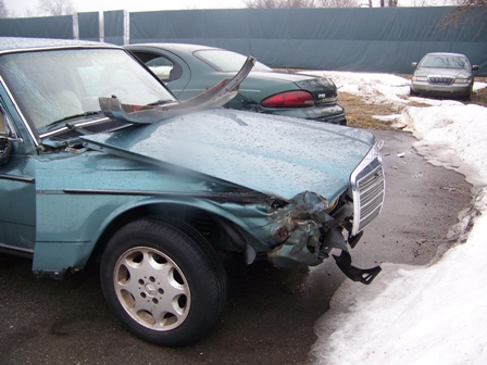

Welcome! Nice job on bringing the car back from that! Did you cut out and weld in a new piece, or were you able to bring the inner fender/headlight frame back?
I have a 300D the same color. I love it personally, I think it looks great on these cars
Are you staying with that color, or respraying the whole car?

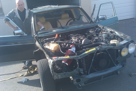

10-30-2010, 09:56 PM #8

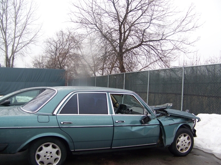

Im really looking like a noob here lol. The car was originally from california so its completely rust free, unfortunatly it has all that emmisions crap on it (evil trap ox) it has all the maintence records from 1985 to the present with everything being done at the dealership, including an $8200 bill for a new block, cylinder head, and radiator lol. Still has the stamped tag from the original owner, the seats have had covers on them since the day it was bought, not even a coffee stain. And it has the original med kit in the back, never used.
Eventually i will re spray the whole car, im keeping the original color. Yea i cut out a new bracket for the headlight on our cnc plasma cutter and welded it on.

10-30-2010, 11:10 PM #9
Looking good great job saving a great car from going to the crusher! I really like the wheels!
I went through almost the exact same stuff on my 300sdl but mine wasn't nearly this involved witch was good for me because I'm a novice compared to what you can do! I usually stick to mechanical fabricating not body work!

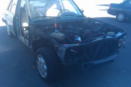

10-31-2010, 12:51 PM #11
Welcome! Prepare to have a new addiction!!Big Grin
The trap ox really sucks to have.
Willbe, those wheels are really nice huh! I like them alot, it gives the car a more modern look.
Captian, i stared at the pic with no front body work for like 5mins hahah

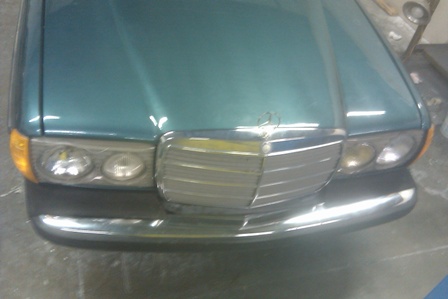

10-31-2010, 05:11 PM #13
yeah this is the one that caught my eye
I like the look without the headlight grill thingys
looks like some mad max shit

(10-31-2010, 05:11 PM)Captain America yeah this is the one that caught my eye
Lol yea I needed to have the trim on them to help align the hood and fenders. Still here working on this thing, I wish I could say one part was worse than the other but it all sucks lol.
Murphys law. Just drove it around the parking lot before I went to go home and the fan hit the radiator which broke a blade and put a hole in the radiator. Fml.

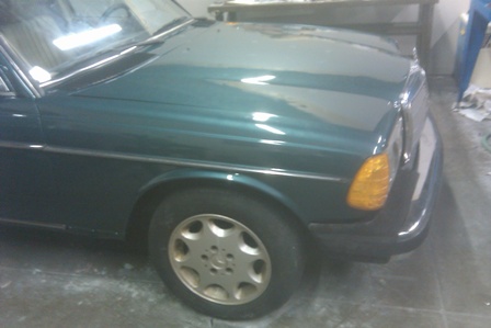

Radiator, fan, and windshield all installed, prepped for paint and ready to shoot Monday. I wanted to have this thing on the road before snow flew but it didn't turn out that way. It's going to be so nice to have a good vehicle this winter, last winter I drove an 89 jeep with no carpet or drain plugs and a top that didn't fit right, I would have to brush the snow off the drivers seat in the morning and snow would land on me at lights. Add that to the fact that it was a stick and a 4 banger with a cracked bell housing and it was a pretty shitty winter. Oh and no 4 wheel drive. To go from that to a Mercedes lol......

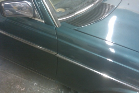

12-13-2010, 08:47 PM #21
Its done Big Grin

12-14-2010, 02:57 PM #24
I'm all out of paint or I would lol, two fenders the hood and the door took a whole quart of base and almost a quart of clear. My dad did the painting anyway I've never painted anything before. It figures the first two nights I get to drive it are huge snow storms but I must say I was very impressed, its quite a little tank in the snow. And thanks guys, its nice to hear the opinions of people who actually know what's involved in a project like this, not "So you just took the crushed parts off and put the new ones on?"

(12-14-2010, 03:56 PM)led-panzer Now its your turn captain, fix the ass end of that red beater lol
Be my guest sir. I would like her to have some fresh skin but I have no desire to do the required body work... I'd rather pay to have someone do it for me
I was Just messing with you cap. If I lived a little closer I would do it for you its not that bad when you dive into it but it will always look better when someone else does it, when you do it yourself you know where all the imperfections are.

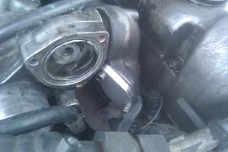

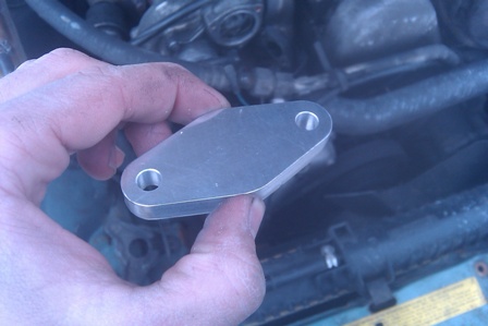

Removed all the EGR crap today.
Made my block off plate
Some improvement, but that could be in my head. Now Im getting this aweful low pitched whistling noise when i get over 5lbs of boost that, in my girlfriends words, sounds like Im dragging a cat. Sounds like its coming from the drivers side firewall. Its always something.
1985 300D 280,000 miles RIP
led-panzer
02-27-2011, 08:44 PM #36
02-27-2011, 09:05 PM #37
Check that the turbine hasn't been damaged by the cat. Other than that, look for black soot streaks at joints and the manifold flanges.

Ah, you know it might be leaking around the little plate I made for the exhaust hole. Maybe ill double up or try some epoxy. Those manifolds will be replaced in time, I have to make the adaptor plate between the federal manifold and the vnt, clean up the w115 manifold, get a silicone boot, gaskets, and figure out the oil supply.

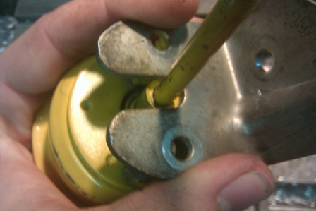

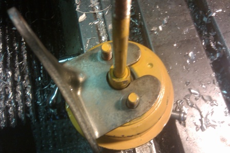

03-18-2011, 09:15 PM #41

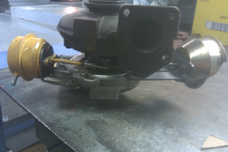

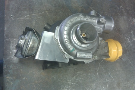

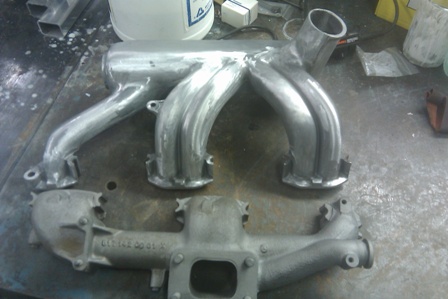

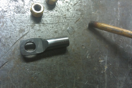

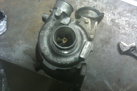

Shined up the w115 manifold and sandblasted the exhaust manifold
The VNT arrived yesterday, a gt2056v from an '05(?) Liberty
Im opting to go with the opposing vacuum and pressure actuators, this seems the easiest form of control even though its not the best.
The stock bracket for the vacuum actuator wasnt big enough for the pressure actuator so i milled it out
I was able to cut the rod on the wastegate and cut the lever that came with it to make them work
Wastegate mounts right up
I made a cardboard template for the vacuum actuator, then measured everything and put it in the Plasmacam program, cut it out and bent it accordingly
Took a little bit of tweaking but everything mounted up right
I was able to get the studs out of the manifold before i left, ill knock out the adaptor between the turbo and manifold tommorow. The only things left are the silicone boot, oil supply lines, and making an exhaust for it.

Well its a good thing I mocked everything up, I was planning on making an adaptor .625 thick but the pressure actuator will hit the intake manifold. Solution - make the adaptor 2.00 thick. It's not ideal but it allows me to use both the actuators and the intake manifold.

The center bearing on the driveshaft went on me, so what little time I had to devote to the turbo project is now being absorbed by fixing it. I was able to make a temporary fix with duct tape (gotta love the hillbilly tech my dad is full of them, like straightening the frame with a big steel bar, tow strap and his excursion). Ordered the part, but as long as I'm going to have the driveshaft out I may as well do the flex disks. Probably this weekend.

03-29-2011, 01:24 AM #48
Haha Pulled a fender with a torch, ratchet strap and forklift once lol
04-01-2011, 08:31 AM #49
(03-29-2011, 01:24 AM)Captain America Haha Pulled a fender with a torch, ratchet strap and forklift once lol
2 comealongs, 2 large trees and a dead blow hammed.
04-01-2011, 06:14 PM #50
(04-01-2011, 08:31 AM)winmutt
I was under the car putting the front suspension back together while the guy was doing the "bodywork"
