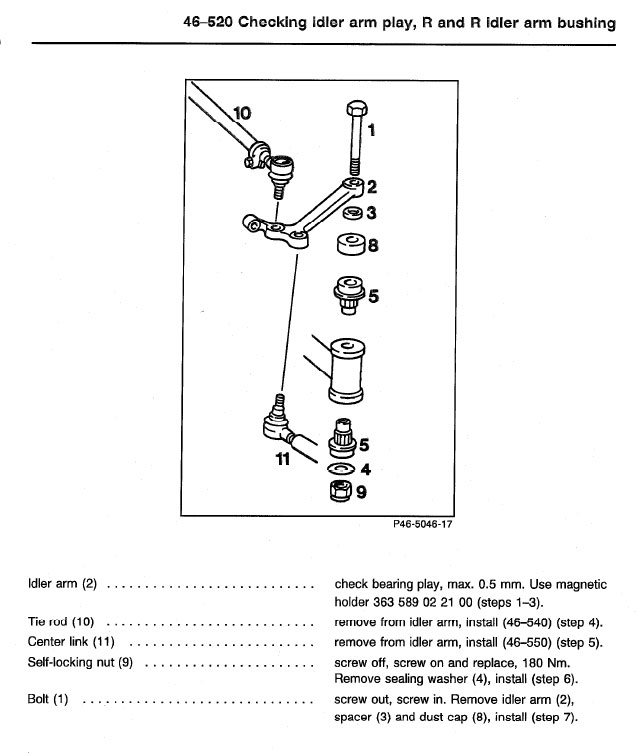

Is it just a simple swap job as it appears or does the arm actually need to be removed and the bushings pressed out/in?

I suppose lacking a press a long bolt and fender washers could be used to pull them together into the housing.

It's a pretty straight forward job..... I've been lucky... Didn't have to deal with rust welded bushings the couple of times I've done it.
After removing the arm, Get a long punch and big hammer, and pound out the bushing. To install, use the whole assembly and tighten it down to seat the bushings after initially starting it.

So the arm must be removed or can it be turned out of the way?

Remove the bolt and push the arm out of the way with the tie rod and center link still attached.

Last time (just recently) I did an Idler on a W123, I didnt even jack the car up or remove a wheel...
Just dropped out the centre bolt, moved the link outta the way and banged out the bushes....
Cleaned out the tube of crud and rust with wire-brush cut down, greased its inner bore, pressed in the new bushes with a G clamp and re-fitted the link and the centre-bolt.

You may need enough space under the var to stick something long enough in to pry out the rubber bits, but yes its that simple.
