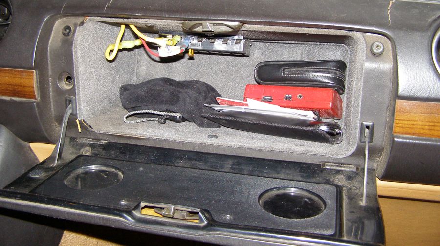

12-04-2010, 06:55 AM #3
Run a wire down to the starter terminal and use an inline fuse.
You can also buy a fuse panel and mount it wherever you can find space. I got rid of the annoying glovebox light and mounted my panel in there.

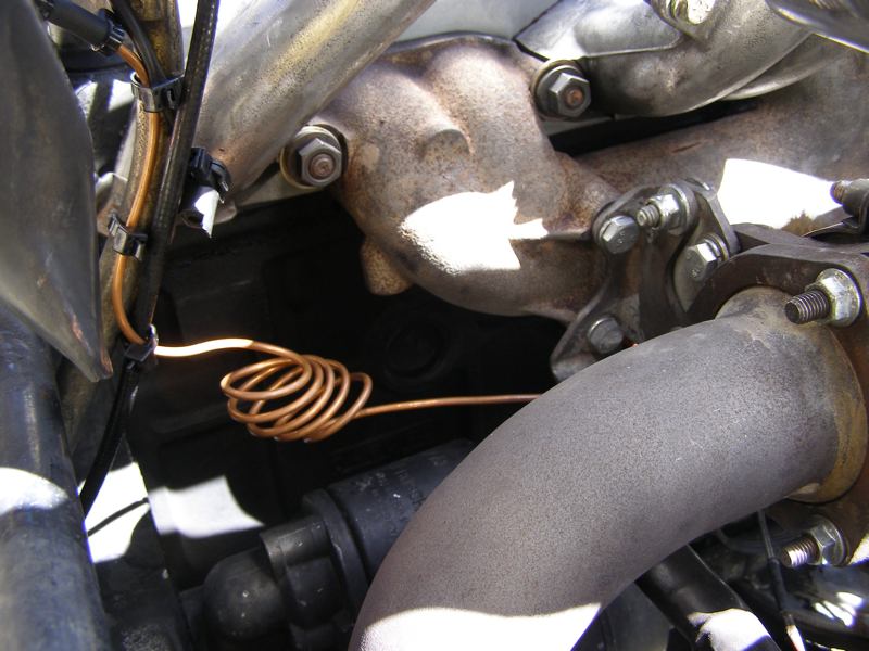

12-04-2010, 09:51 PM #8
I think it would be fine there is not a lot of air moving through it it just gets pressurized
I think the more important part is to use enough line so it dose not get hot! some people use copper line coiled around to cool it down form a 1000* +

12-06-2010, 02:01 AM #10
You could also wrap it around the ATF dipstick tube, that would work like a heatsink allowing less tube to be used.
