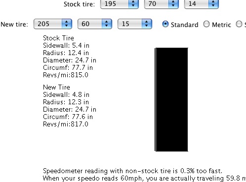

I'm running 205/60R15 tires on aluminum disk wheels from a 560SEL. I chose that size because it was less than 5% overall diameter difference from the stock 14" steels.
This post was last modified: 01-13-2009, 09:45 PM by ForcedInduction.
01-13-2009, 09:04 PM #4
01-13-2009, 09:14 PM #5
(01-13-2009, 09:04 PM)ForcedInduction I'm running 206/65R15 tires on aluminum disk wheels from a 560SEL. I chose that size because it was less than 5% overall diameter difference from the stock 14" steels.
I assume thats 205. How wide is the wheel? I have 215/60 on there now I think. Not nearly as sticky as the 225 but slides just about right. I really need to get the TD bar on the front to minimize roll more.
01-13-2009, 09:46 PM #6
Right, that should have been 205/60R15. Its about the same as the 14", just a bigger rim for less sidewall flex and about 1/2" wider.
01-13-2009, 09:52 PM #7
(01-13-2009, 09:46 PM)ForcedInduction Right, that should have been 205/60R15. Its about the same as the 14", just a bigger rim for less sidewall flex and about 1/2" wider.
Mine is .3% to slow I think. At any rate I had much less rubbing with shorter sidewall and narrower tire than the last set on these rims. I switched because of availability, pricing and economy. These seem to be much better than the Falken's just not nearly as sticky.

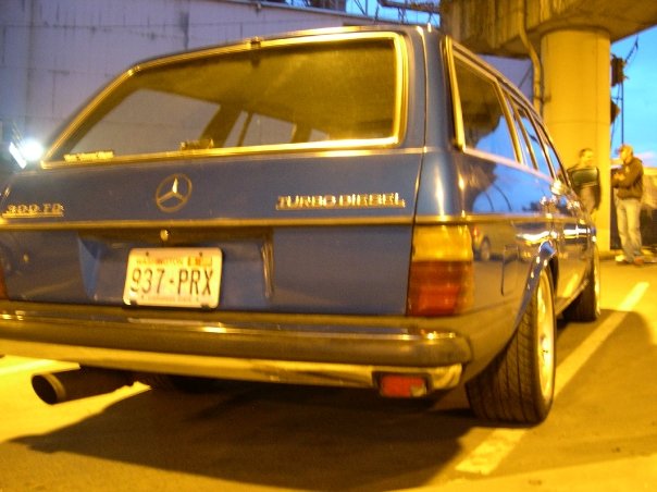

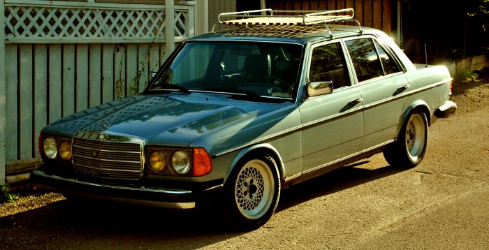

09-18-2010, 03:36 PM #16
This is what I have
Rial 16x7 + 16x8, Et 23 and Et 11
from an 81 380 that was imported from Germany new, and sent to Amg in Cali. Definately not the widest wheels, but they fit damn well. they almost rub without any rolling.
This post was last modified: 09-18-2010, 03:37 PM by Paperjam.
Paperjam
This is what I have
09-18-2010, 03:44 PM #17
Wow, good looking benz.
Was that rack a factory option? Its beautiful
