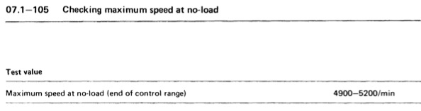

Right, you're not. The governor will not let the engine go above 4800rpm while loaded. Neutral revving and 1st gear isn't "pulling hard to 5500".

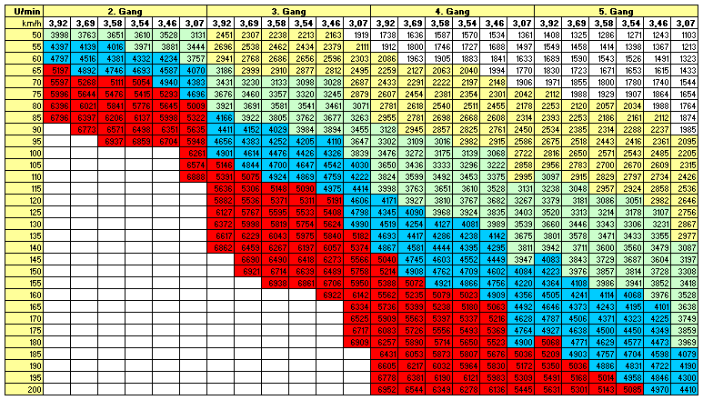

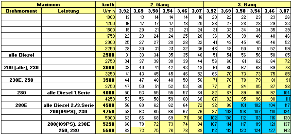

Your tachometer is incorrect. The instant jump and twitching should be pretty obvious clues there is an electrical problem.
As you can see by the chart you're barely touching 5000rpm, pretty easy to do in 3rd if given flat or slightly declining road.

Forced car to explain that chart? I think I'm reading it right as the white =1st and goes to 65kmh
135@5400rpm if you pause the video.
The chart needs to show rpm I'm every gear related to speed.

Its been conclusively proven by both your video and MB factory data that your tachometer is faulty.

(02-25-2011, 01:17 PM)dieselboy The chart needs to show rpm I'm every gear related to speed.
Theres a map for that.

Uh the tach is not wrong you are. And yes if I shift at 5 it does pull harder but that was just to show you that it does indeed pull over 4800 rpm.
I'll do another video then.
Edit: 5347rpm in 3rd says 140kmh. Um pause the video and I'd say it's perfect according to your chart there.

02-25-2011, 03:16 PM #20
What'd your deal man? There is proof that your chart matches my rpm in the given gear within 100rpm!
And yes the tach does randomly not work but when it does work it's within 100rpm as showed by your charts.
By not working I mean it will drop to zero and not move.

02-25-2011, 03:26 PM #22
Again look at your charts and the video.
Hard govenor is 5750ish.

02-25-2011, 03:36 PM #23
(02-25-2011, 03:26 PM)dieselboy Hard govenor is 5750ish.
Incorrect, 5500rpm is the hard cut (zero fuel) with 5200rpm the governed maximum.
Please answer my previous question; "So please remind everyone, whats the point of your "I can revv to 5500rpm" game if you yourself say its slower than shifting at the correct RPM before the governor reduces fuel?"
Answer: Wasting time baiting.
Who cares if you can revv to 5500rpm? That adjustment takes 30 seconds with the governor cover off. I've done it too, it raises the RPM before the governor starts to cut fuel so the engine can get full power up to its 5000rpm redline. Only, the smart people don't overspeed their engine afterwards....

02-25-2011, 03:58 PM #25
(02-25-2011, 03:50 PM)dieselboy Again you said that I'm not Reving over 4800 rpm
That was correct.
Quote:you said that my tach is off
That is correct. You should fix it.
Quote:you said that it won't make any power over 4800 with a load.
You proved that yourself.

02-25-2011, 04:46 PM #27
(02-25-2011, 04:16 PM)dieselboy What? Again look at the video and your charts. It proves I am wrong.
What problem is there then. Try reading the charts and using a conversion tool instead of guessing at the KPH-MPH conversion.

ConnClark
109
02-25-2011, 07:18 PM #29
(02-25-2011, 04:57 PM)dieselboy Uh it's obvious you have a problem with admitting you are wrong.
If you watch the video an compare it to the chart that you posted everything us correct for me to be reving to 5500 rpm and the speedo even has kmh on it so you can pause it look at the chart and see that the tach is indeed correct to the speed and gear.
I've not once edited one of your quotes. And I've not once edited a post without showing what I edited.
FYI according to your information I am actually older than you so respect the elders!!!
I you read the very first post it says "pulls harder than stock 2800-5500" and thats correct.
Now If my tach is the 700rpm off you say it is then I'm idling at 1400rpm and making full boost by 2100rpm. That's not correct at all. Go back to you little make belief world.
you can settle this argument right now about the tach being off. What gear were you in? What is your rear diff?
Or we can just analyze the audio and tell how fast the engine is turning.
Edit: I guess we will need your tire size too

02-25-2011, 08:39 PM #30
According to his signature, he has the 3.07 rear end and 245/50R16 tires. BUT, as long as its the stock diff/trans/speedo combination, it doesn't matter what tire size you have, the indicated speedo/rpm will read the same as before. But back to those graphs now... I've been looking at the video, and dieselboy is right. He is at the stated KPH (MPH) that the graph shows he should be at in 3rd gear. Right before he shifts back to 4th gear at the end of the video it shows just under 140KPH at just under 5500 RPM. Keeping in mind the camera is mounted low and at an angle, that still puts him spot on for both the charts that FI posted. Doing the math, 140KPH works out to just about 5400 RPM even. Even if you figure for the camera angle, that still looks right.

02-25-2011, 09:50 PM #32
(02-25-2011, 08:39 PM)Biohazard According to his signature, he has the 3.07 rear end and 245/50R16 tires. BUT, as long as its the stock diff/trans/speedo combination, it doesn't matter what tire size you have, the indicated speedo/rpm will read the same as before. But back to those graphs now... I've been looking at the video, and dieselboy is right. He is at the stated KPH (MPH) that the graph shows he should be at in 3rd gear. Right before he shifts back to 4th gear at the end of the video it shows just under 140KPH at just under 5500 RPM. Keeping in mind the camera is mounted low and at an angle, that still puts him spot on for both the charts that FI posted. Doing the math, 140KPH works out to just about 5400 RPM even. Even if you figure for the camera angle, that still looks right.
I know that I hit high 70s in third and then some. 2.88 205/60R15. 70-80 in my car is about 6 sec : http://www.youtube.com/watch?v=1nREKAqKt1E
