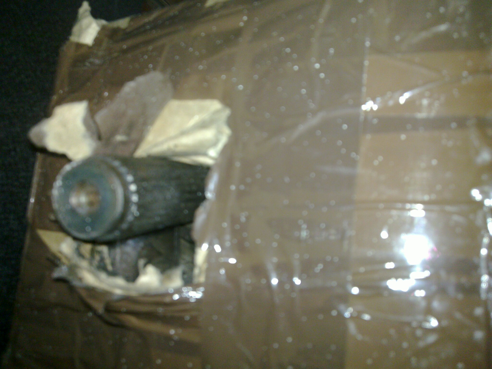

So winmutt's manifold score inspired me to poke around on ebay.de. The result was this:
A "5 gang kardanwelle". No it's not supposed to poke out the box like that. Still pretty sweet though.

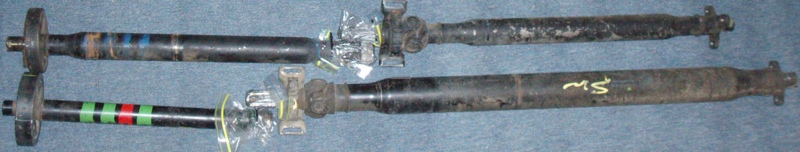

03-25-2011, 04:21 AM #4
5 speed driveshaft.
Pic:
Hmm, uses the small flanges. I was hoping for the larger style flexdisc. Each half is around 32" long.

03-25-2011, 08:55 PM #5
Um, you do know that the center support is in the wrong location..... Thats a 280E driveshaft.

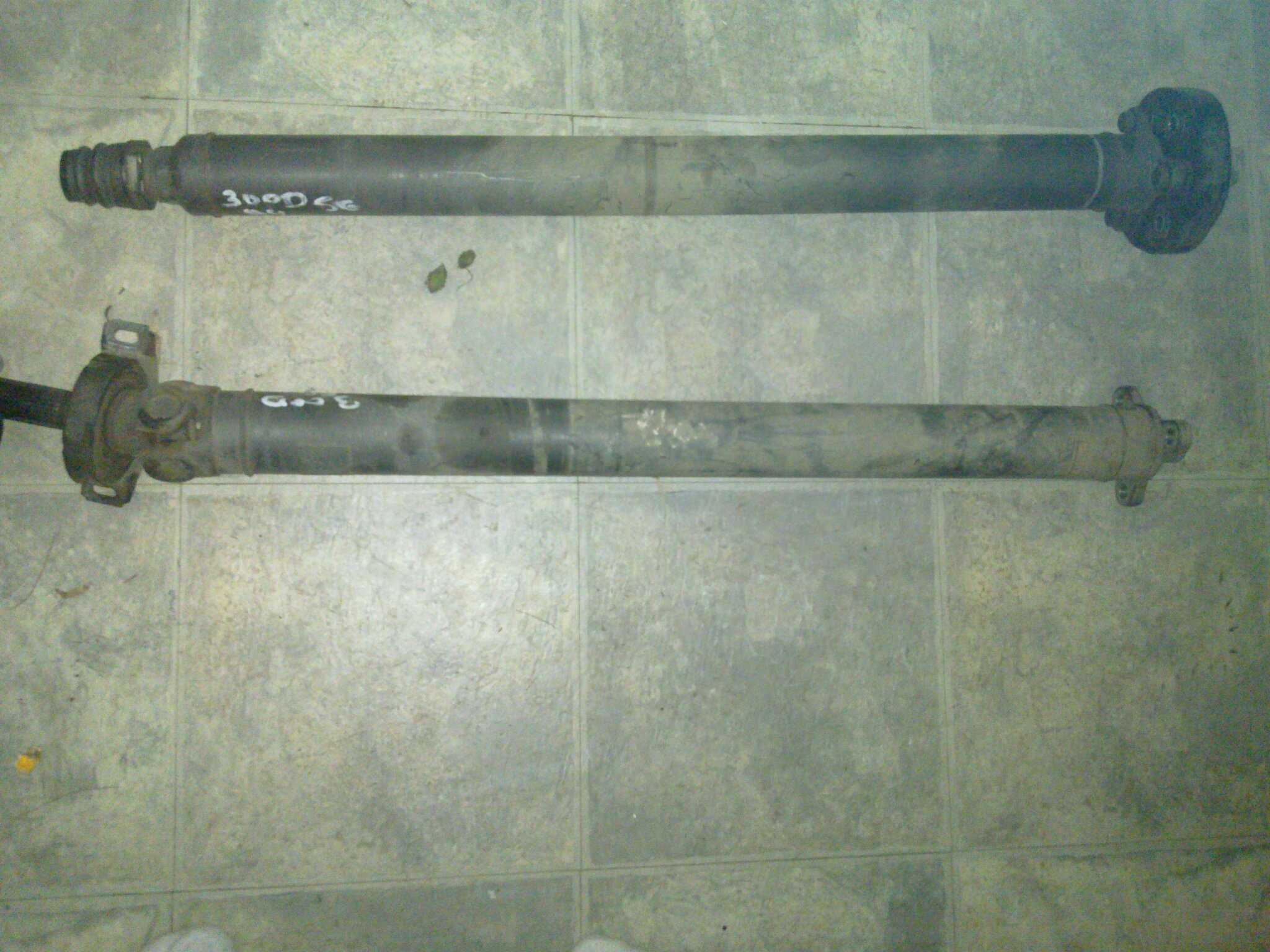

03-26-2011, 11:16 AM #7
In the picture attached, you can see the difference in support positions from the 300D and 280E. (280E 5-speed top, 300D 4-speed bottom.)

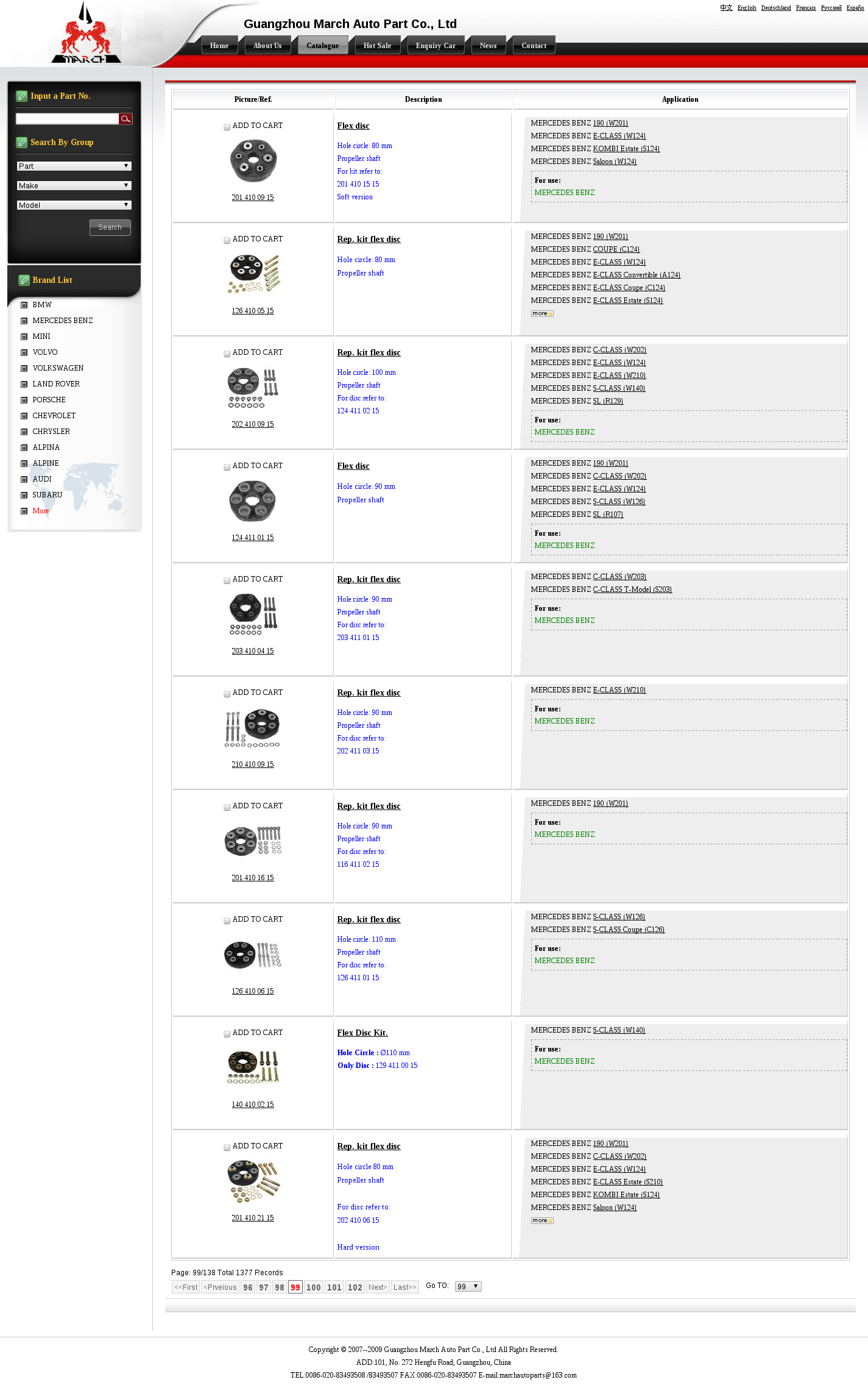

03-27-2011, 07:45 AM #9
So apparently the 201 2.2L disk has an 80mm diameter bolt circle, while the driveshaft is 90mm, matching what the 123's use. I'm guessing what 87's have to begin with is 100mm, or maybe 110mm (for some reason couldn't find a flexdisk lying around, thought I had one). (Edit: they're 110mm)
Here's some link I found with all the sizes and part numbers:
And here's a link to the big 110mm version of the googley-eyed flex discs the 85+ manual trans cars used.
