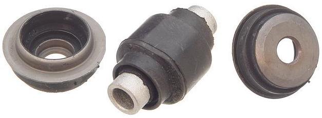

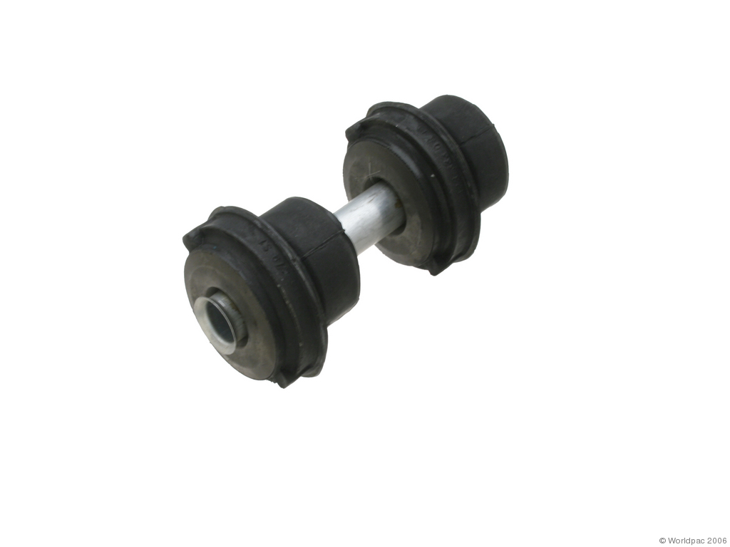

Yes they are stronger and in my opinion better built. You can interchange them.
w126 Bushing.
w123 Bushing
w126 Bushing.
w123 Bushing
