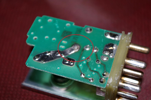

01-30-2012, 05:16 AM #11
If tach doesent work than there can be a problem with OVP relay, tach amp gets its power suply from OVP relay.
As you can see on diagram, K1/1 is OVR pelay and N8/1 is tach amp
http://img697.imageshack.us/img697/3941/p1030313.jpg
OVP relay comman problam is also bad tin solder or broken fuse on top of it.
http://www.upload.ee/image/341148/IMGP2657.JPG
