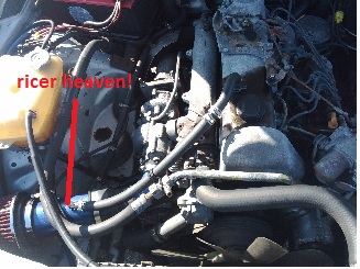

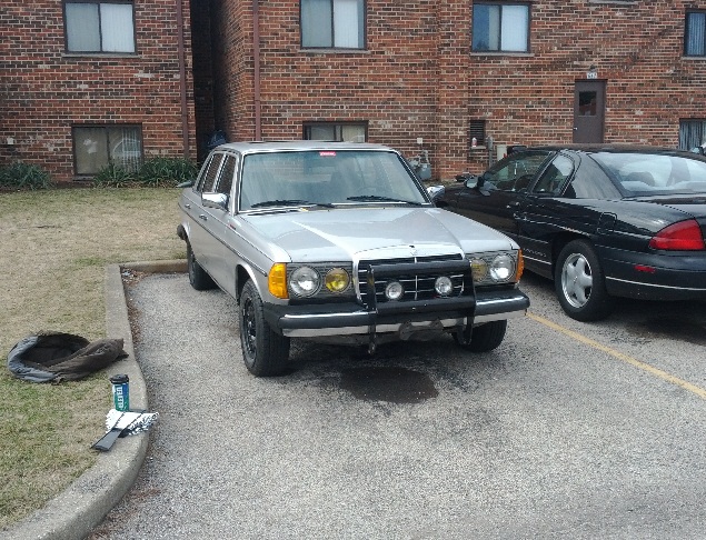

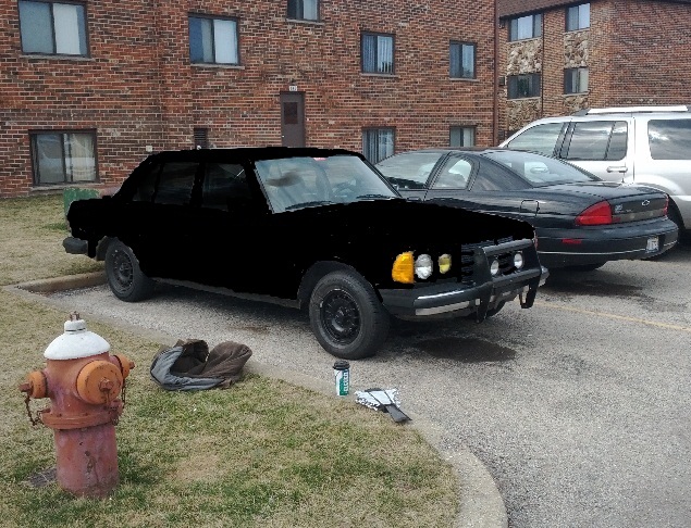

here's a crappy picture. I bought it from a guy who bought it from a guy. It has a goofy cold air intake, stickers that say performance diesel or something. Giant 3+ inch straight pipe exhaust from the turbo back. It came with an extra differential, so without checking I imagine owner took out stock and threw in the 240d differential. Car needs work to be pretty but as is is a car that makes a turbo wooosh, lol at myself....anyhow. The drivetrain is together. Now I get to learn all the other goofiness of mercedes. I've read pleanty of good posts on boosting performance and will be searching again. Anyone got some super easy stuff to do real quick? That's almost rhetorical, i will do my research not to worry.
This thing moves crazy air though, while not the most experienced in these things i do know this thing is moving air like crazy.
Also that friggen oil cooler is huge, now i have to put my summit radiator next to that?!?!?

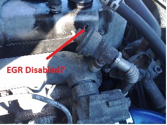

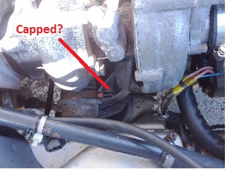

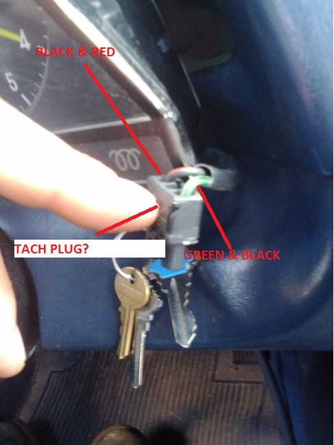

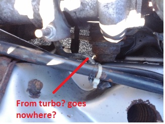

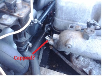

02-25-2012, 05:58 PM #6

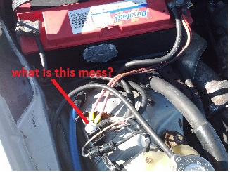

Ok so i drove the car 90 miles to get it home. No heat. No powersteering. bald tires. Cold night for sure. Put a power steering belt on today and hooked up a hose to give the car blowjobs to turn it off. Don't know if the vacuum pump is bad or just leaking vacuum lines. There is so much disconnected goofiness about the car. Uploading pictures so you wonderful peoples can give me some insight.
Again I feel lonely here in chicago, anybody nearby with and STD?
Also compression readings are right around 400 in all cylinders with not much blowby. I feel like I got a steal on having a car with 617 turbo and 4 speed manual for 1650$ what are your thoughts on that?
Can I put a EGT sensor in anything blocked off here? Has anyone while plating off the EGR valve set up a EGT through there? I read on that and it didn't look like anyone had. Thoughts?

02-26-2012, 06:07 AM #7

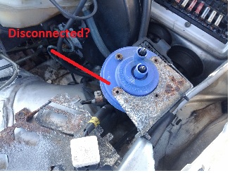

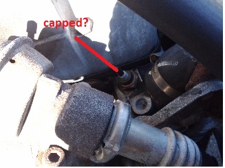

1 is the banjo bolt, presumably the alda was removed so it got capped off.
2 is the wastegate port, looks like the wastegate is disabled. I'd hook that back up.
3 looks like an unimportant temperature sensor
7 was for the automatic transmission vacuum

02-27-2012, 11:37 AM #8
So that banjo bolt i could hook a turbo gauge up to right? Also without in in depth knowledge on how to hook the waste gate back up i wonder is that boost driven? Can i splice that to the banjo bolt as well?
(02-26-2012, 06:07 AM)aaa 1 is the banjo bolt, presumably the alda was removed so it got capped off.
also what are the downsides to no wastegate?

02-27-2012, 03:57 PM #9
(02-27-2012, 11:37 AM)lgreeley83 So that banjo bolt i could hook a turbo gauge up to right? Also without in in depth knowledge on how to hook the waste gate back up i wonder is that boost driven? Can i splice that to the banjo bolt as well?
Yes that's a good spot for a boost gauge. Theoretically you can also hook the wastegate to it (it is boost based), but the normal location for that is a fitting on the compressor housing of the turbo.

02-27-2012, 04:18 PM #10
Does the injection pump have a square thing on top that should be the ALDA? If so the cap at the rear of the Intake manifold has to run to it! It actuates the ALDA! If the ALDA/square thing is missing it should be ok being blocked off It may smoke a little more at idle!
The ALDA reduces smoke at idle by reducing how much fuel the engine gets until turbo boost pressure goes through that line and makes it richen back up to make power under boost
The line on the waste gate should hook up to the intake side of the turbocharger there should be a nipple on the aluminum housing
#4 cant see in your photo? probably oil drain to pan from original air filter? need better pics
#5 junction for starter wiring I believe
#7 old vacuum crap for auto transmission

02-27-2012, 04:52 PM #11
Just left the part store with a boost gauge and some vacuum line stuff. Get a picture of my ip when i get home.
I read about the downsides of no wastegate. Why would someone want to disable it though?

02-27-2012, 07:18 PM #12
Hooked up the gauge. At wot on flat ground without the wastegate i could get up to 20 psi. I hooked up the wastgate and was getting the same amount of boost. 20 psi boost is high isnt it? Reading around here it seems people are happy to get 12 psi. What have i got here? Pic of the ip in a bit.

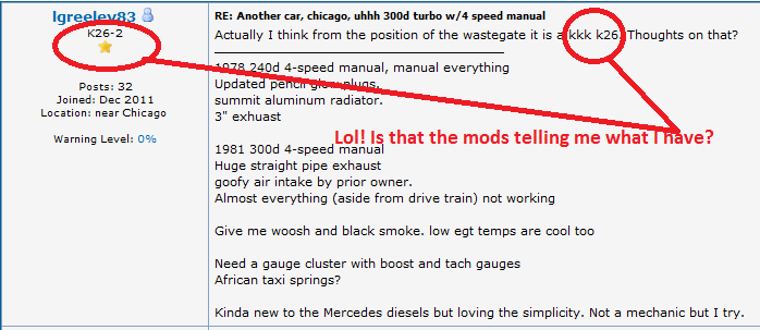

I feel like all the work is done for me. Woot woot! Picking it up today, new ball joints, upper control arm and tie rods. Allignment and some 205 70 14 rubber. Off to the streets to break something else on it.
Aside..... ive been reading about my turbo. I think its a kkk k 24. I think my wastegate is stuck shut. Just a couple of screws and i can take it off and clean it right? It was disconnected when i got the car, when i hooked it up i was still boosting up to 20psi.
I figure i need to work it loose any tips?

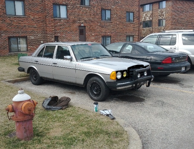

Got the bar from dropnosky. People say the car looks angry.
03-13-2012, 03:19 PM #25
03-13-2012, 03:47 PM #26
Blackout those headlight bezels

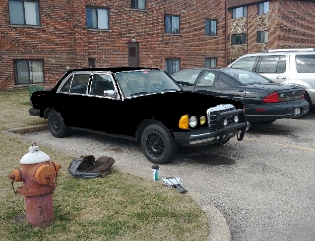

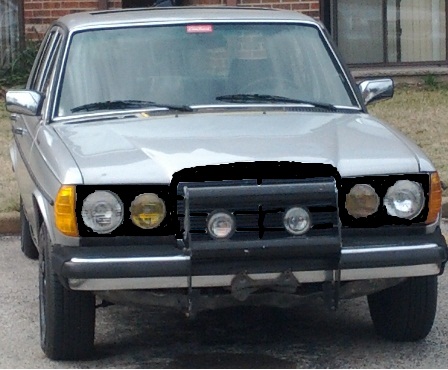

(03-13-2012, 03:47 PM)larsalan Blackout those headlight bezels
My college major is Biology my minor is physical geography.
My art is not to be confused with an art student however I think I did great. (NO REALLY!!!)
I think at some point I may go with the whole flat black scenario. Paint the grill too? I think drop considered that. I don't really know what I think on this topic.
Another view...
This post was last modified: 03-13-2012, 04:25 PM by lgreeley83.
03-13-2012, 04:20 PM #27
Another view...

(03-13-2012, 04:25 PM)larsalan [Image: IMG_0691.jpg]
I dig it. My grill is partially blacked out as well. Is the black stock for the grill? Mine was like that when I bought the car.
More pic editing. Wasting time at the university......
simulated no chrome except for bumpers, tinted windows.
My plates coming in the mail are "SOOT"
My wife calls the car quazi moto
I think the last photo is the winner
On a side note.......
I nit pick on this a lot. If one is entering a doorway that has two doors why do people always exit the one on the left? This happens more at my school than anywhere else. Do we not drive on the right side of the road? Does this principle get lost when walking? Why when i exit through the right door is there always someone attempting to get in a head on collision with me?
Anyways......
This post was last modified: 03-13-2012, 05:04 PM by lgreeley83.

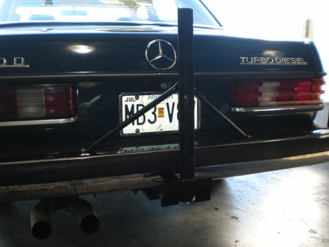

if you want these headlight covers, let me know. Heres a pic of how they look with the bar, and a below pic on a black 123. On a black car, with a blacked out grill and bar, could look pretty interesting!
also, heres a pic of the spare tire holder you asked me about.
Its basically a T shaped deal made out of angle iron, and bolted to an etrailer 1500lb bumper hitch I had on the car in this pic, I removed the ball, and added a few ears to the sides to bolt this contraption to. I then compressed some electrical conduit, and made a pair of braces.
It was cheap and crude, but was very effective. Reason for the external tire mount was my trunk was full of VO stuff and luggage. Also had to move the plate
03-14-2012, 01:22 PM #32

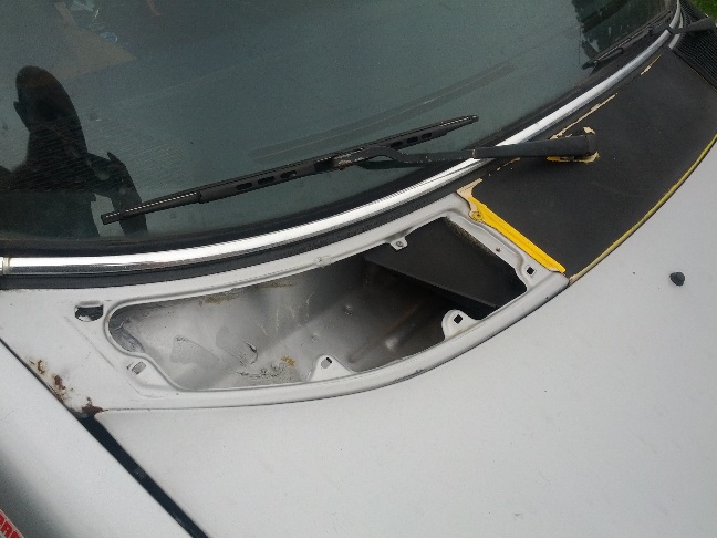

got to be a yard kicking around near you that might have that wiper cowling trim. What happened to all that stuff, was the car going to paint?
The 115 manifolds occasionally turn up, but you will have to keep your eye on the forum FS ads on most of the benz forums. Maybe even put up a WTB for one.
Same for the Tach cluster. Got to be able to grab a 300D cluster from a yard. Any yards near you that have older benzes?
