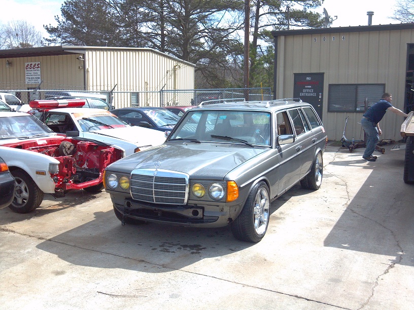

Hello I'm Turbodave.

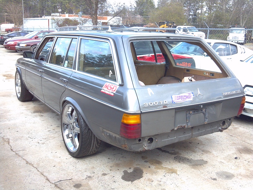

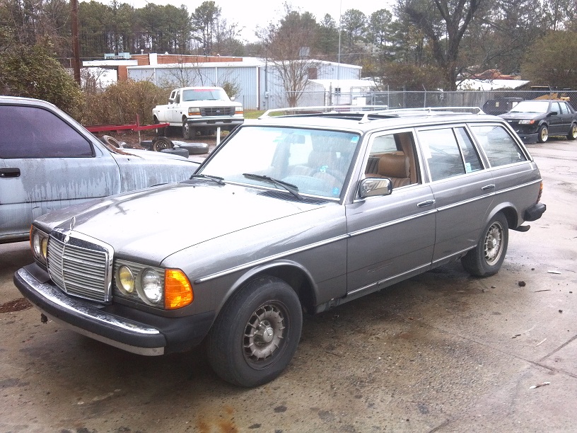

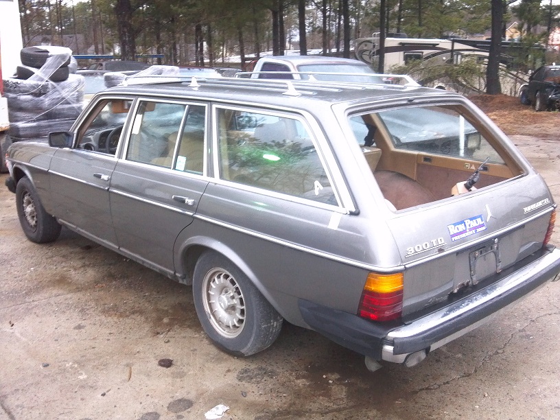

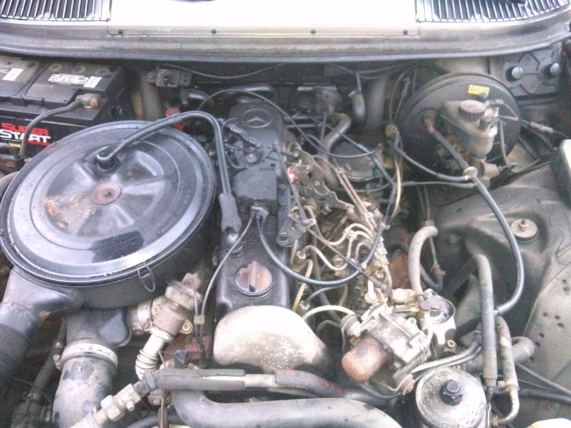

I saw this 1984 300td in a impound lot earlier this year. It didn't run, it didn't have a back window and busted ignition cylinder. Well let's just say i got the car because i was the only one who would bid on it.
Some may not like what I have done. But keep in mind I got it to race,drift whatever.
I didn't buy this car to restore it or fix it up it was bought to use for drifting first and every thing else second. I know there are some different parts that could be used for this project but i like to use what I have on hand to keep cost down.
Here is what I started with.

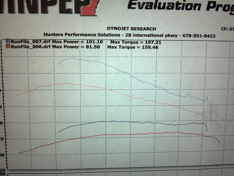

I did a base line run on dyno every thing stock it did have a exhaust leak at flex pipe but not bad. It did 81.5 hp and 159 tq automatic to the wheels bone stock w/factory exhaust and air cleaner box.
I then removed exhaust from down pipe back, put 3"cold air intake to k&n filter, deleted egr, adjusted throttle linkage to make sure going wot and deleted all vacuum lines from injector pump it did 101 hp and 197 tq to the tire.
I remove bumpers and changed to some wheels I had. I cut factory coil springs to lower it.(I changed this out later)

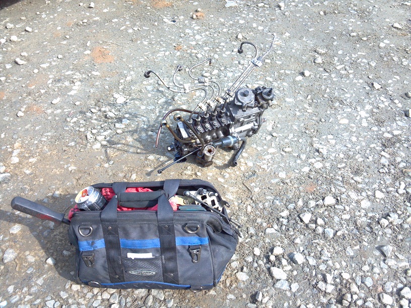

I picked up a extra injector pump for $200 at a junk yard.

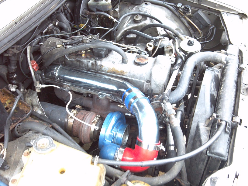

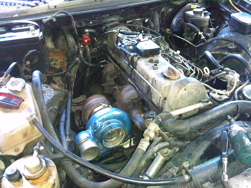

I'm doing a turbo upgrade (I find out later this turbo has wayyyyy to much lag) he351 Dodge Cummings turbo(thanks led-panzer for correct number and yr).
While i was doing the turbo upgrade i did some intake manifold upgrading also.
Time for more dyno runs before getting to the fuel system.

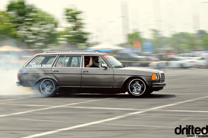

Drift modified,
Coil overs (JIC rear coil overs w10k spring on custom made mounts )
Modified knuckles,
Welded diff,
Diesel om617engine 5cyl with twin compound turbos (primary turbo t3 50trim .61 a/r custom built, secondary turbo t4 57trim .96 a/r),
Will foot brake to 25psi. Instant boost No turbo lag.
Modified injector pump (rack limiter removed, 5800rev limited ect)
larger delivery valve,
larger injectors.
Adjustable fuel pressure regulator
High pressure fuel pump
4in exhaust system w/5in tip.
Makes 35 to 40psi.300hp/400tq.( Cut and modified DV's. Not idle happy, you can street drive it but very rough idle and OMG Smoke out the cars behind you.)

I'm trying to remember the order i did everything ???. I think I did the rack limiter delete, increased the rpm limit speed and max the what was it called alda (more fuel at take off). I can tell you this every injector pump is different (like someone on this form said the adjustment need to be done in small fine adjustment and telling someone to turn this 2turns doesn't mean it will work on all pumps, it is a 50 50.) I did one adjustment at a time and them tryed it out first before going to another.
THE BAD NEWS (like you could have problems when you are learning/messing with the injector pump's internal parts)
I put the the pump back on hook everything up hit the starter it cranked right up and instantly went to 5800rpm I snatched the fuel supply line to injector pump off (still at 5800rpm)and then went to snatch cold air intake pipe off wouldn't come off ,grabbed a nut drive to loosen clamp and stuck my magnetic bolt holder on inlet of turbo and it died. I would say atleast a 1 to 2 min at 5800. I'm looking around for what went wrong what the hell did I do wrong. Then I see it ,no spring on bottom throttle arm and linkage was bound up.
So I fixed that went to crank it sounds like no compression on atleast two cylinders. I'm at this point calling myself a dumba## and thinking it bent the valves from revving so high for that long. I just had to walk away for a while I pulled the valve cover to check for bent valves. I pulled cover and checked valve lash haaaa there is none, All of the lash adjusters had unscrewed hold almost all the valves open. I adjusted every one back to spec and started the wagon it runs better now than when I got it.

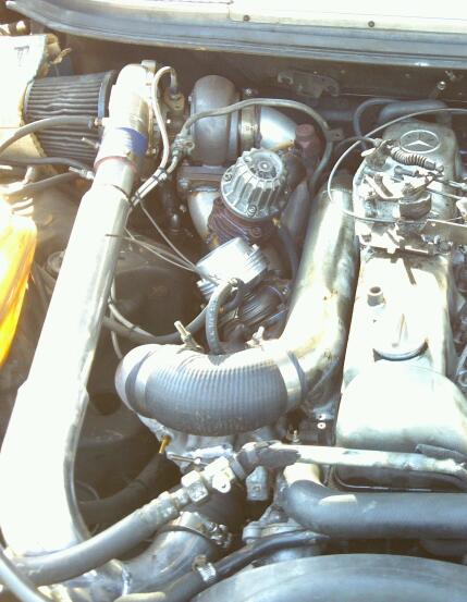

I put holset turbo on and i did intake manifold and just ran a 4" downpipe with no exhaust. This turbo is to big for a auto can't brake boost it and it creeps to 22psi. Dyno 145hp and 220tq hits 15psi at like 4600 rpm and 22 at 5600 and it hasn't got enought fuel from around 3600 and up. I know I need some fuel on the mid to top end and a little bit smaller turbo.

I had a stage 2 turbo form a Buick Grand National that I had upgraded for 62-1 turbo and know it was a good one but it had the 3bolt mounting flange and .90 a/r exhaust. I milled a Garrett T3 exhaust housing with a .60 a/r to fit the 58mm exducer wheel and tappered mill the inlet houseing to fit a 3 1/2 inlet pipe. I tig welded a 3" v-band on exhaust housing for the down pipe. I drilled out the exhaust manifold to weld a 38mm wastegate. I ran wastegate dump back into the down pipe. I ran 3" down to 4" exhaust all the way out the back by rear axle.
Lets just say this turbo is the sh#t it will foot brake to what ever waste gate is. I set waste gate at 18psi. This turbo is bad as#. Instant boost you don't have to brake boost to spin the tires just nail it and instant cotton rolling from the tire 1st and 2nd gear Tries to blow through 3rd gear.

Well, the end-of-cycle is created by the collar below the seat on the delivery valve by cutting this you allow more fuel to seep by creating higher pressures in the injector lines causing more fuel to be delivered. but it's not so precise with the injectors opening at there pop pressure earlier beause of more fuel at higher pressures in the injector lines and lasting longer then the normal injection cycle.
Basicly, its a ghetto way of getting more fuel. It idles like shit, doesn't really have even power till about 15psi, touchy throttle, and has really high EGT's. It's defiantly like playing with fire. There was one guy that didn't remove the collar completely and said egts we're below the melting stuff zone, but still has the other issues. DieselMenkin says there is no way to overcome these issues thats why everyone 'recommends' you get a pump modified with bigger elements for more power.

Your right on poor man's fuel. If you have the money do it the right way get your pump and injectors done by a good injector pump shop.
I like to find other ways around cost. The cut Dv's are not for everyone. I did them three different ways, cut small knotchs, tapper cut and full cut. The tapper cut were the best all around with a good single turbo.
The problem is idle and egt vs boost with the cut Dv's (I have seen and read your posts on this and wanted to see what i could do with it).
If you have to much fuel you just add boost. Egts and boost(airflow) work together if you understand it that way you can make alot of power.
Example; alot of black smoke=high egt's = you need more boost or remove some fuel for that boost level.
A perfect setup is at your max boost level you have a slight black smoke out the pipe. You should be able to see through it easly. If you are rollin coal you egt are going to rise quickly.
I have spent alot of time on the dyno to see what does what.
This is why i did the compound setup. You will not be able to do cut Dv's if you can't supply the boost for the entire rpm range. The egt's are just to high. My set up does instant 12psi when you just touch the throttle in gear and then at 2200 is 28psi by 2800 its at 35psi. That's how it works
You can't get a single to work that way. Small turbo good at the bottom end, okay in mid, nothing on top end. Med frame turbo okay bottom, good mid , okay top. Big turbo never going to happen ,bottom end nothing ,mid range getting there, top end okay egt's are out there.
The idle( i have almost got the fixed w/some vacuum valves and fuel pressure control). I don't have it perfect yet put almost. When I do this forum will be the first to know.

I can see that there is a ca 1mm spacing between the collar and the seat. the collar is obviously needed for the idle but if it could be moved closer to the seat, less fuel will be returned by the DV.
I have a theory how to do thisSmile You need a good lathe. Cut the collar and make a new one where the seat is and make a new seat on top of it. there should be metal enough below the spring seat. Maybe you need to take some of the spring seat but it should be strong enough.
It would be very interesting to hear if someone try this. My lathe is from 1930 and not exactly what you would call precise Tongue
