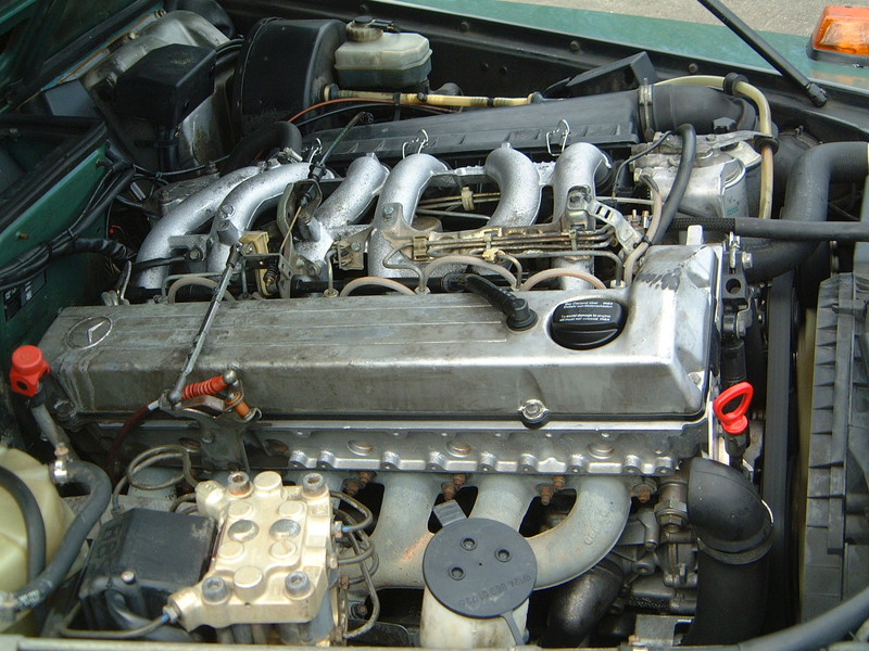

I have a 1990 n/a 603 300GD (see photo). I have a nice 603A that I can transplant in. But I also have access to a 99 E300 with a 606A.
I also have a brand new 603A FI pump that I could use to convert the 606 to mechanical FI.
I much prefer the 606 motor but unsure of what I need to do to control the boost pressure on the 606 since I will be going full mechanical.
If I can get a clear understanding of what I need to do I will go with the 606 motor.
Your help is greatly appreciated.
Thanks
