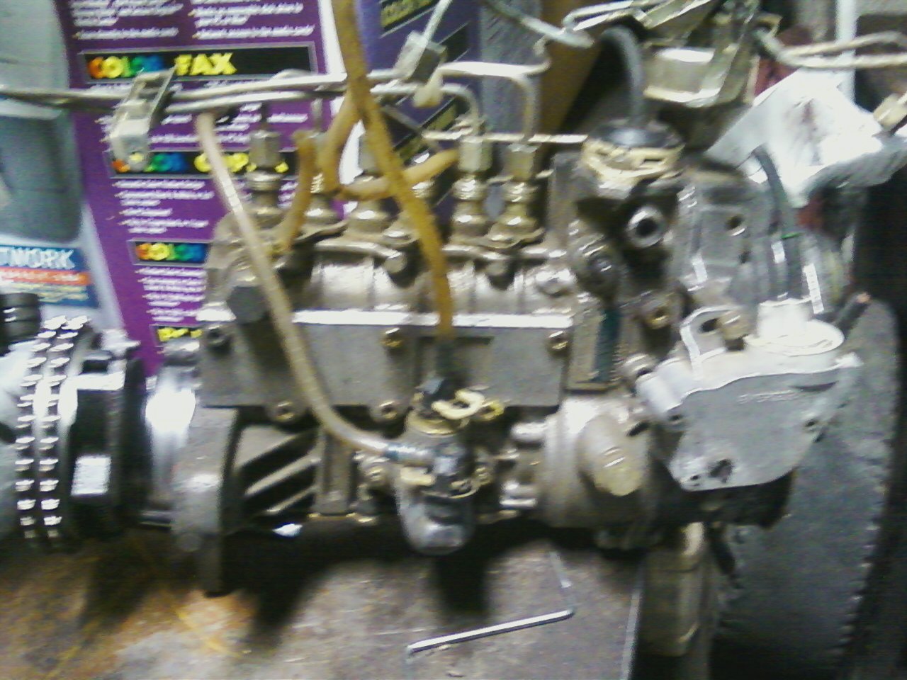

I found this 606 pump. How does this pump look? Is everything there that I will need to install on my 606.692? Anything missing?

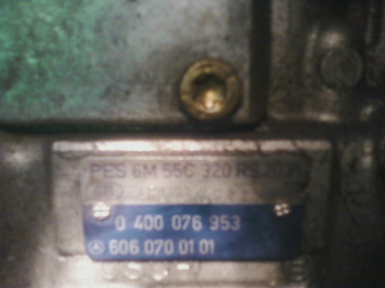

Ah--yes, thats from a N/A 606 engine.
The '55C' part of the Bosch part-number indicates the size of the plungers--5.5mm. This pump has no 'ALDA' but is good candidate for modification with larger elements--An expensive modification....
You could run it as-is, but will get no extra power over that the 606 N/A engine makes. To make dramatically more power, elements and ALDA needed.

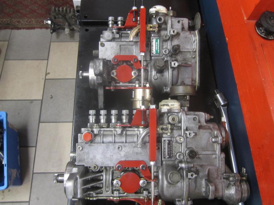

606N/A pump is the best pump to build on, ALDA is set outside so you can adjust it eeeeeeeasy.
From RS171 & up to top of the line RS203
with a set of 7,5mm element it runs like this.
