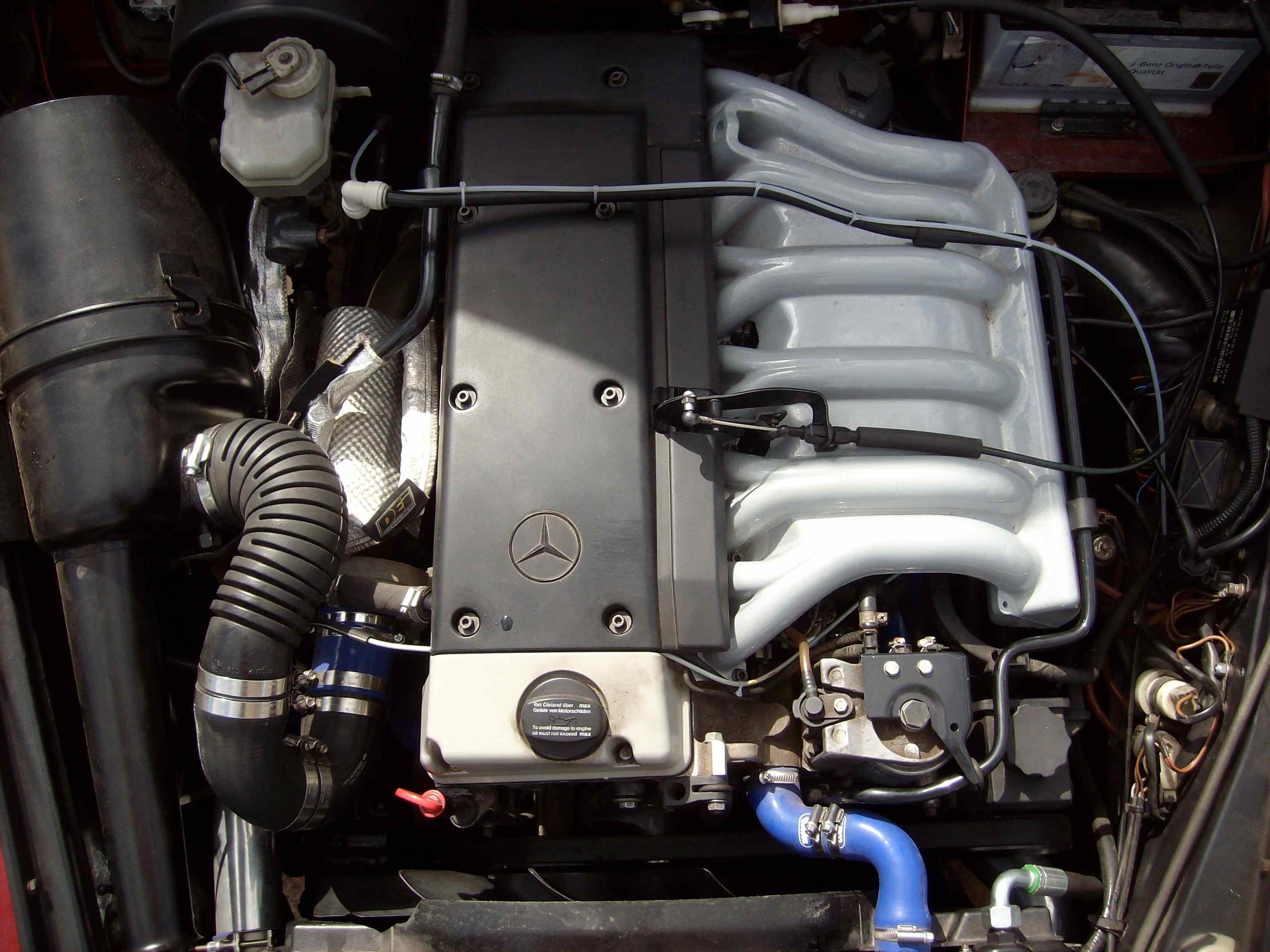

01-23-2013, 12:02 AM #5
(01-22-2013, 07:52 PM)Mark_M you can go the 606 mechanical pump if you can find one. 603 NA pumps are easy to get and cheap 603 turbo pumps are a bit harder and a bit more expensive and I have never actually seen a 606 NA mechanical pump for sale. I know they exist and are supposed to be good but seem pretty rare. Add the external ALDA costs on to an NA pump and the costs go up again.
hello ,i have a 606a engined 460 g wagen and i have a 603a pump fitted with the 6mm elements ,i am building a 463 at the moment with the same, but the pump delivery turned up to about 75cc @1000 rpm from base at 60 cc running 12 psi boost.
if you go down this route you will have to fit the controller for the box made by 'olefejer' on this site using an arduino unit to take control of your auto box as your ecu etc all talk through each other - getting rid of the key is a nightmare ..
you should be able to get near the power you want . the engine /g box ecu is looking for wheel rotations/steering angles/abs -all sorts hence it keeps throwing you limp mode -very frustrating.
go manual pump you will not regret it then you have no electronics to go wrong ,i have fitted a pressure operated wastegate with egr delete etc de-gut the intake plenum of the valves etc and i run an iveco intercooler with a 716-651 6 speed manual gearbox with matching flywheel and ml 270 cdi clutch /cw 220cdi clutch master cylinder to match the operation of the donor cars clutch setup -result a lighter clutch than the 280 petrol it replaces - result flying machine and what a noise !!! don't get stuck doing just 5 miles in two years ditch all the wiring and black boxes ,i have much admired your cut down g's and i am building a stretched super g with 605 a power with 6 speed manual to carry a one off swedish demount camper.

axel606
