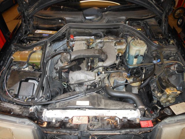

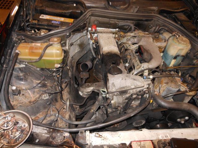

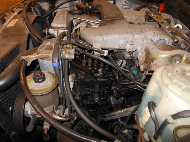

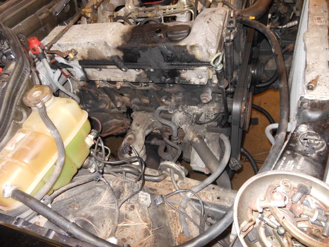

Hello all. So ill keep some pictures up of the work im doing to my 300D 2.5..
Plans so far are- Pump to Dieselmeken, holset turbo, inter-cooler, 400E knuckles and brakes, B6 shocks and struts, 5 speed, stereo..
Heres what we've got so far...

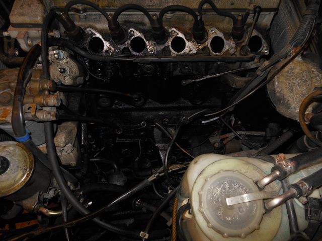

Turbo, air box and junk out

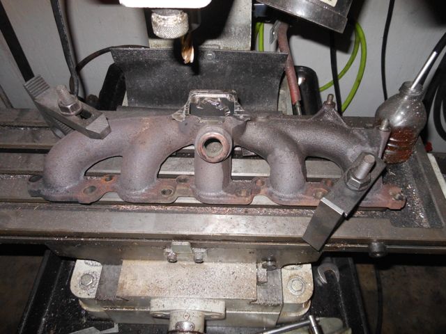

Ready for some milling

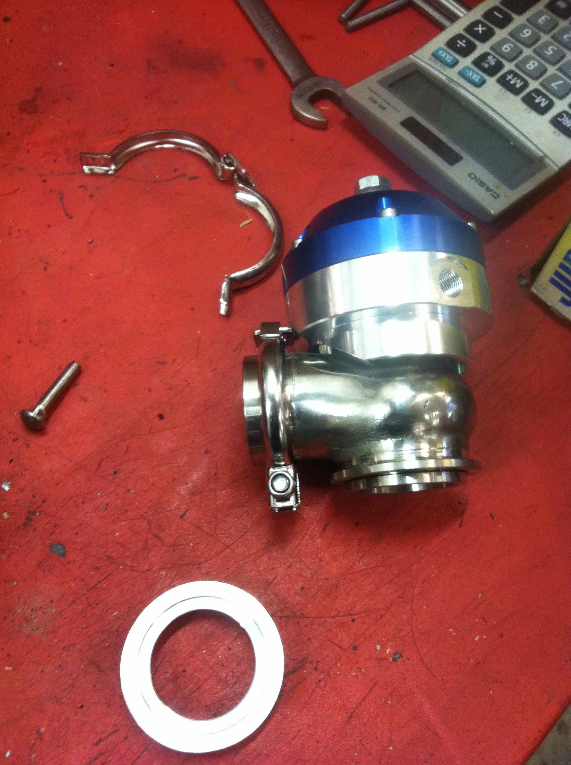

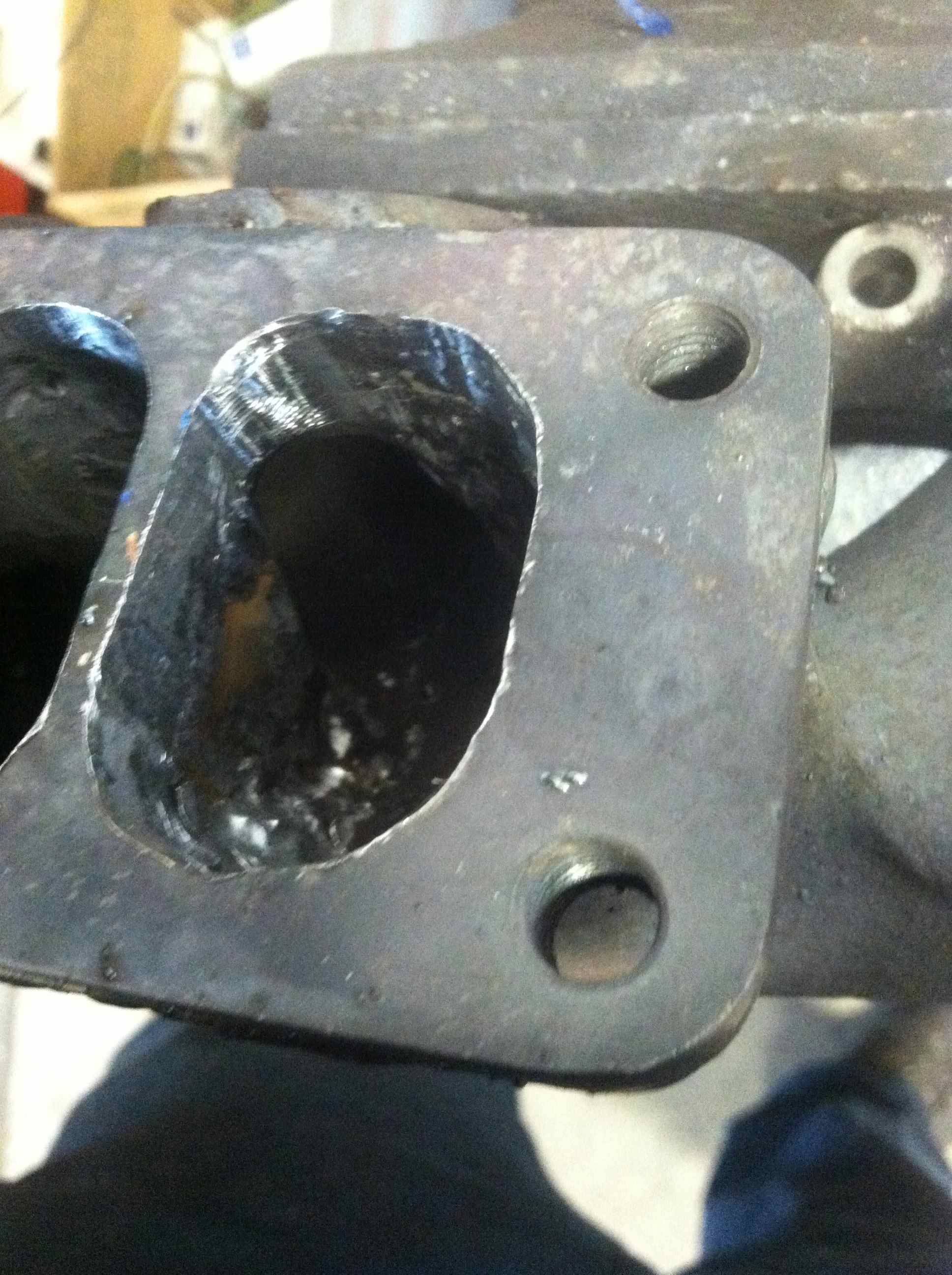

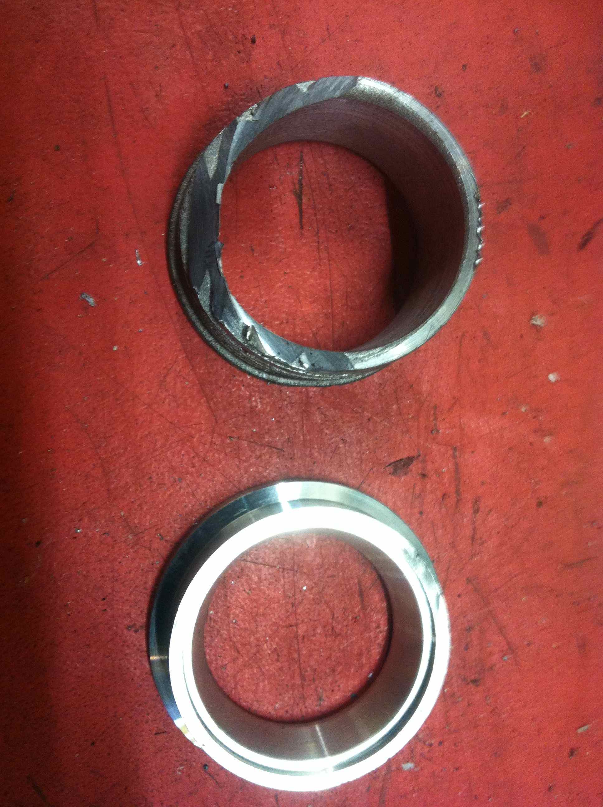

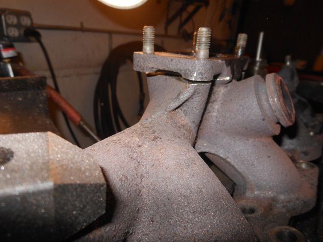

This V-Band for the EGR is 38MM. The same as a Tial wastegate. Not sure if it will match up. Have one on order so we'll see
Cutting..fun fun

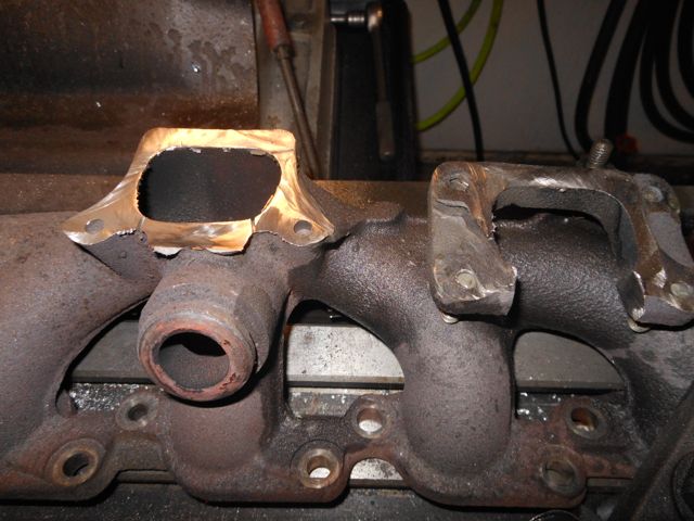

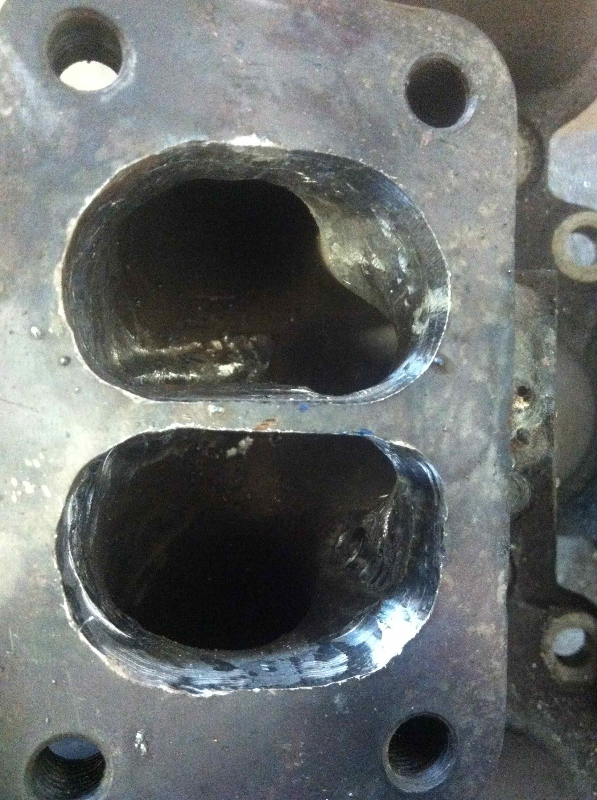

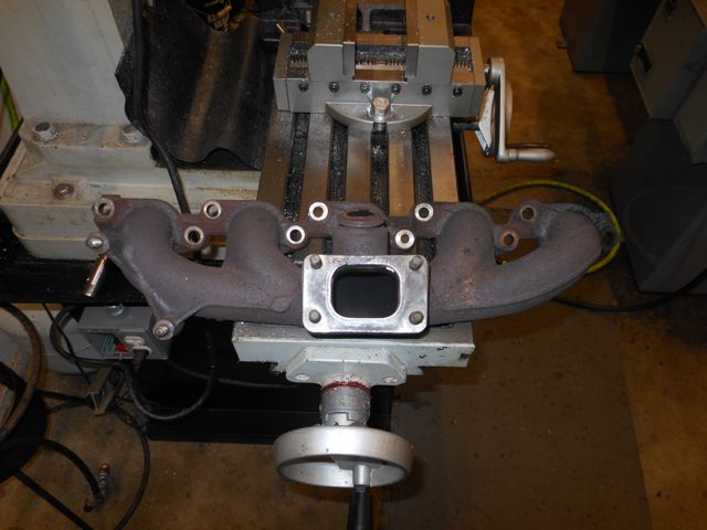

T25 flange gone..
Milled as big as i can make it, in prep for T3 flange

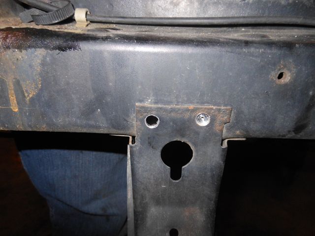

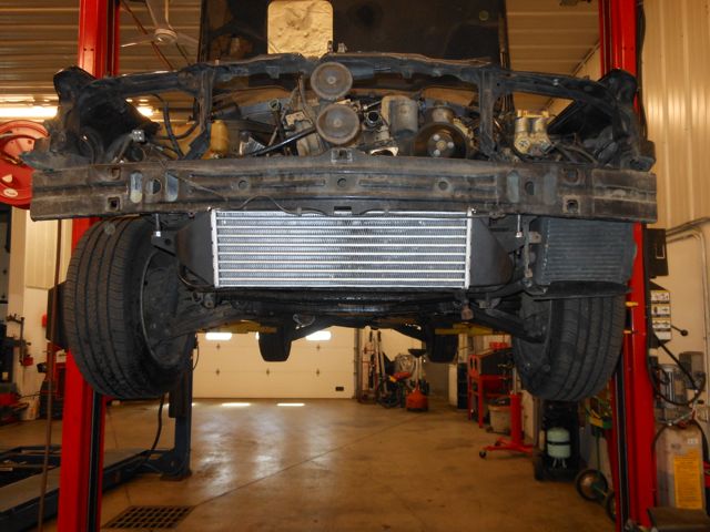

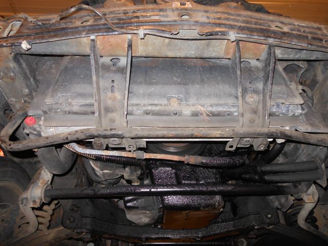

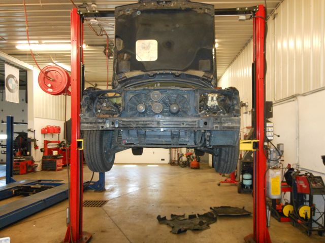

Stripped front end ready for intercooler fab
Cutting these guys out via the spot welds

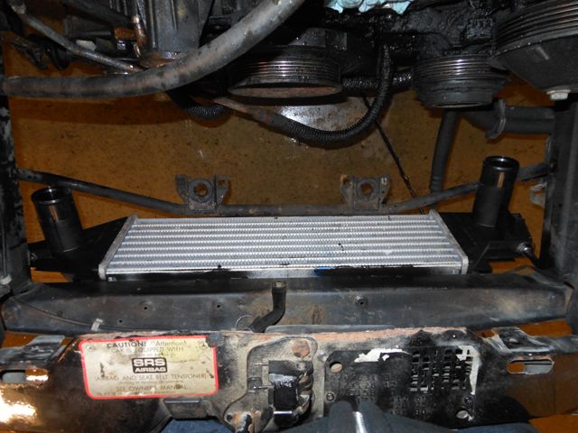

Intercooler mounting studs (Volvo control arm bolts turned down and welded in
Mounted!

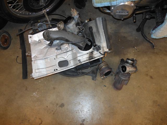

T25 flange gone..
Mounted!

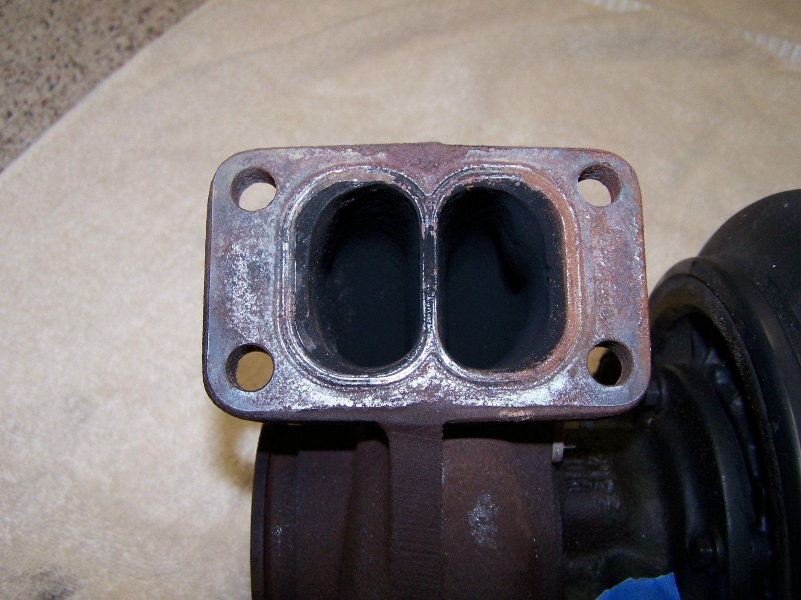

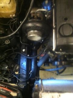

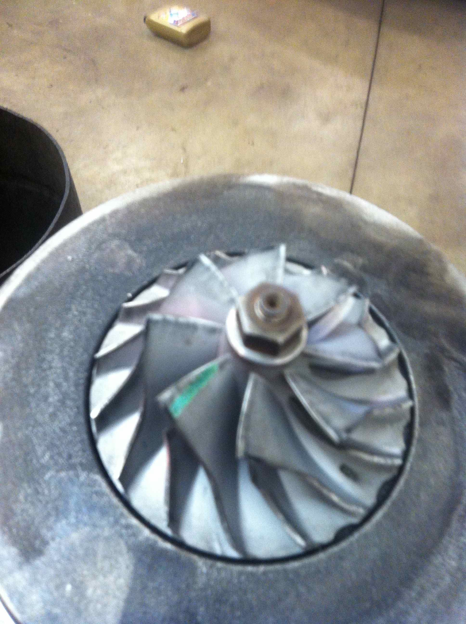

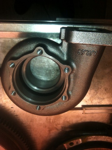

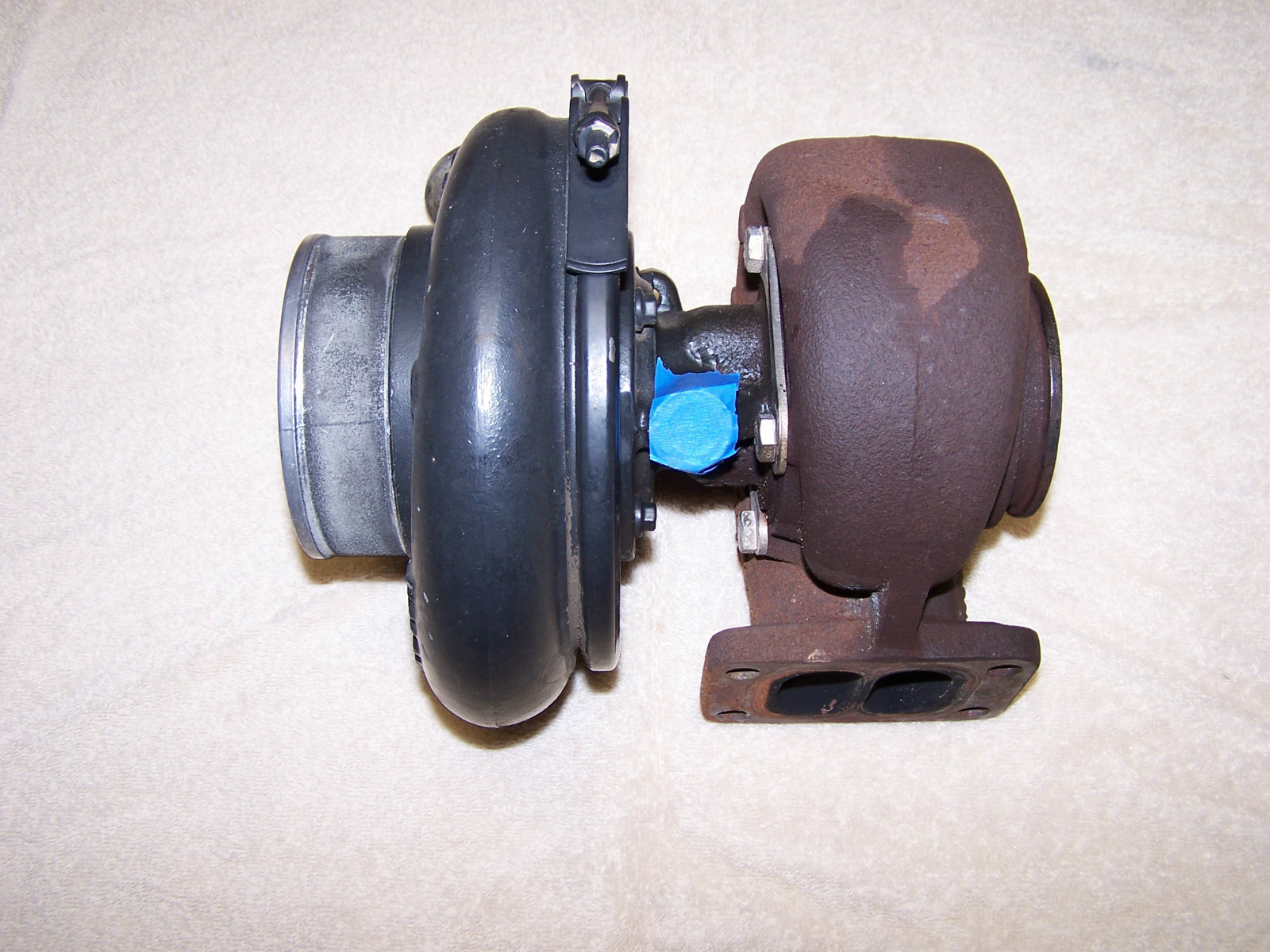

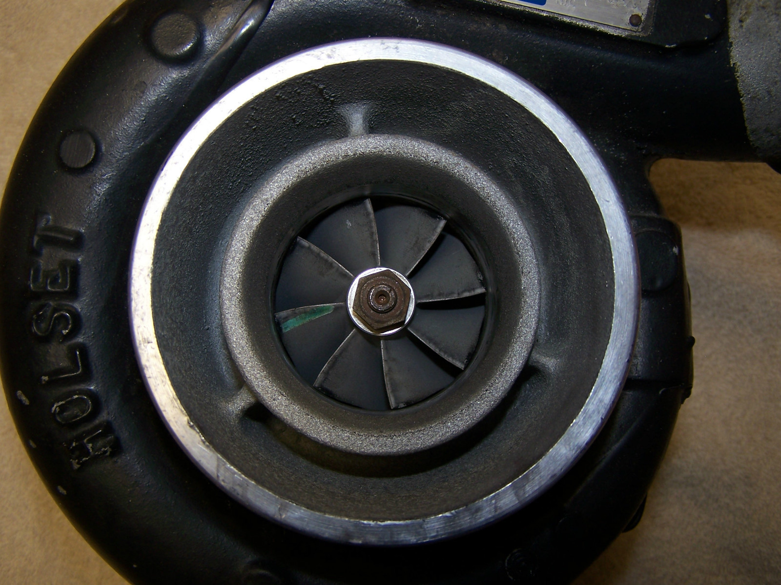

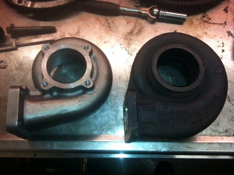

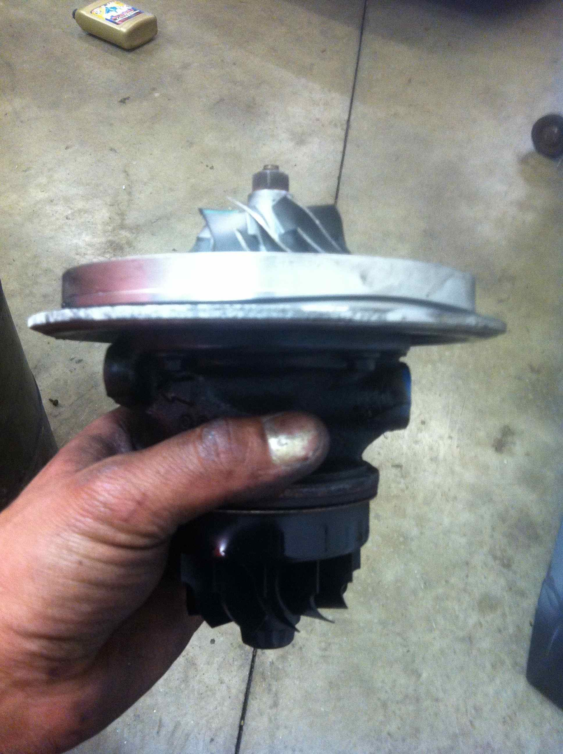

Pictures of the turbo....Should be interesting. Ran me $100, so if shes to big for the little OM602 resale should be no sweat...

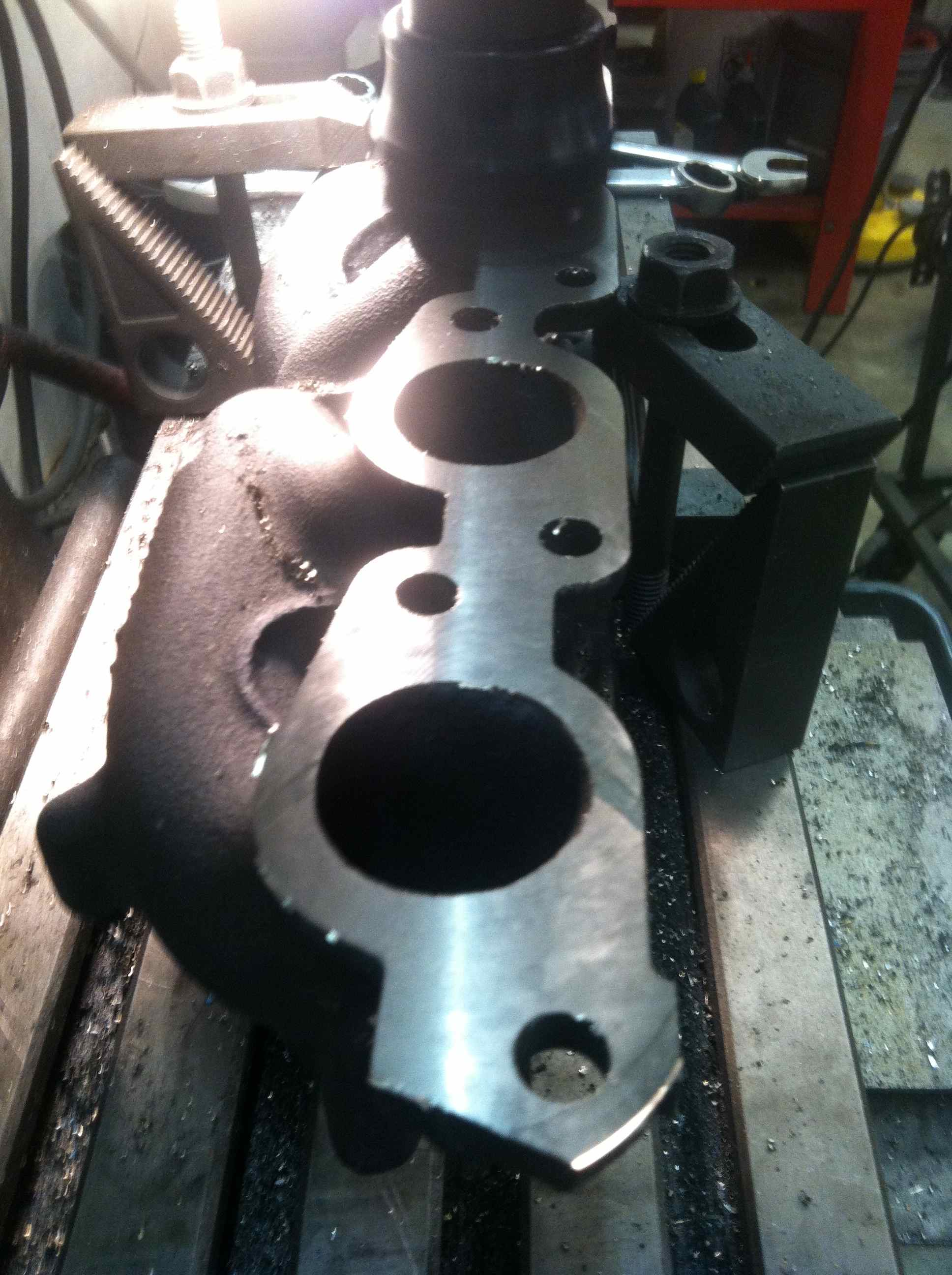

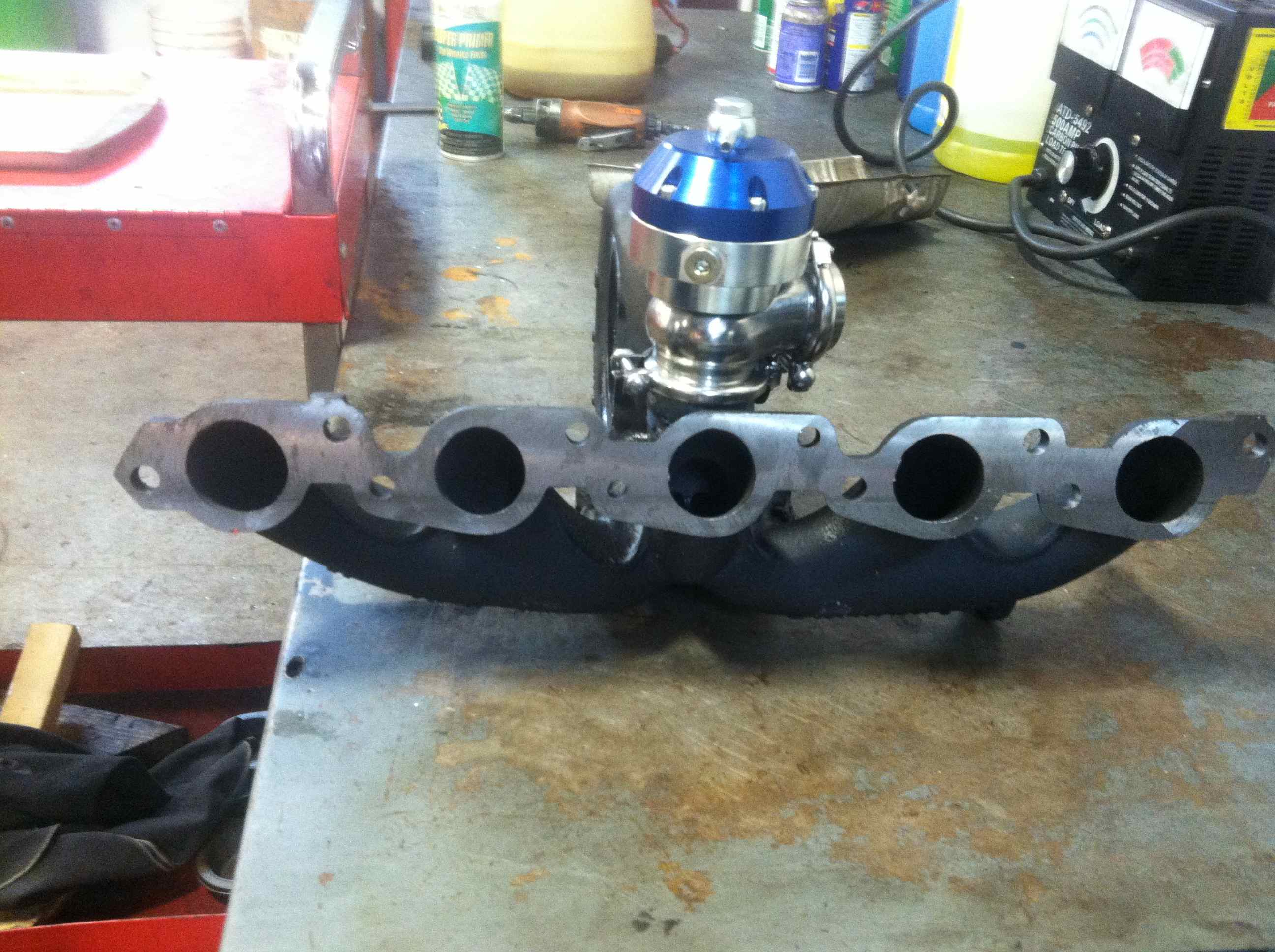

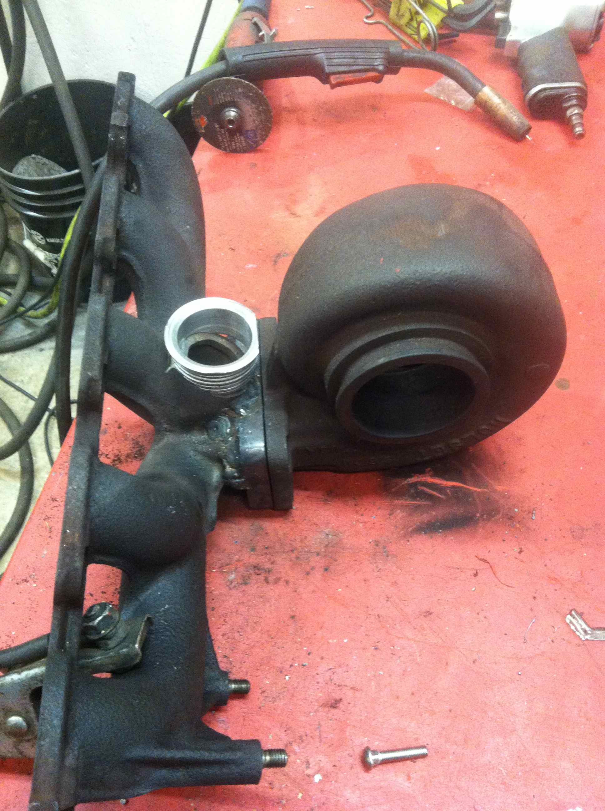

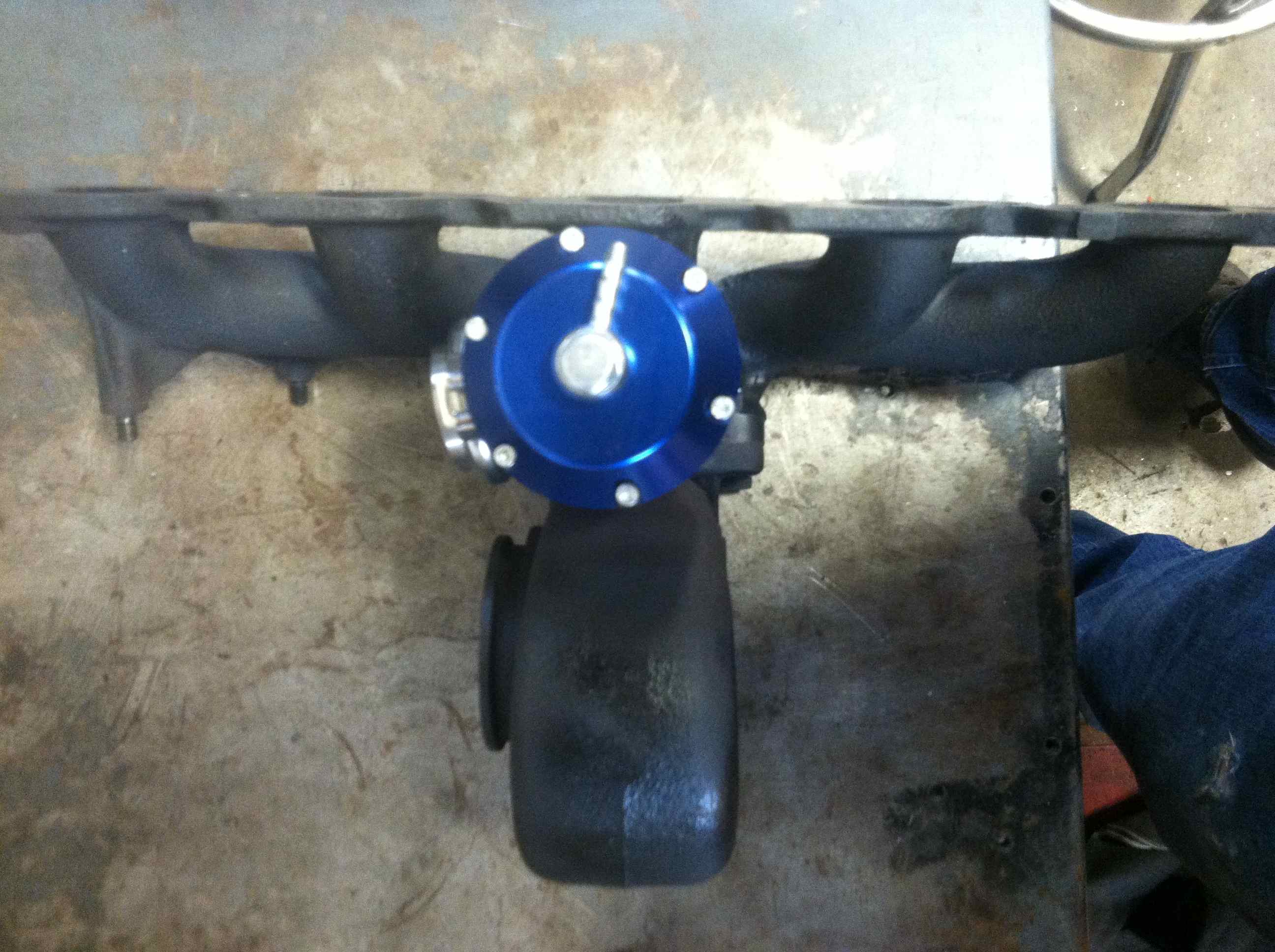

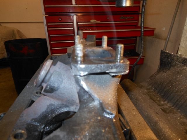

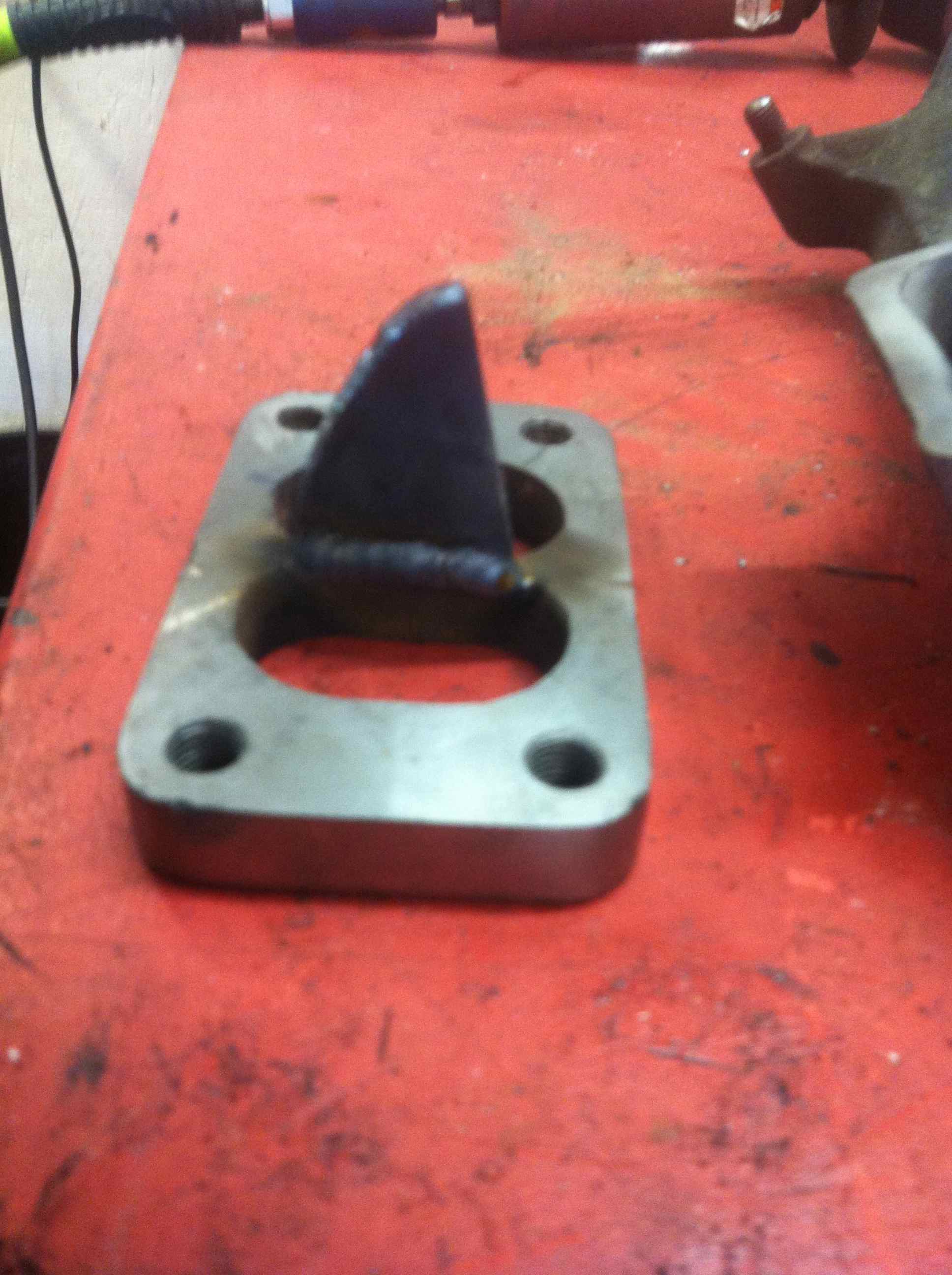

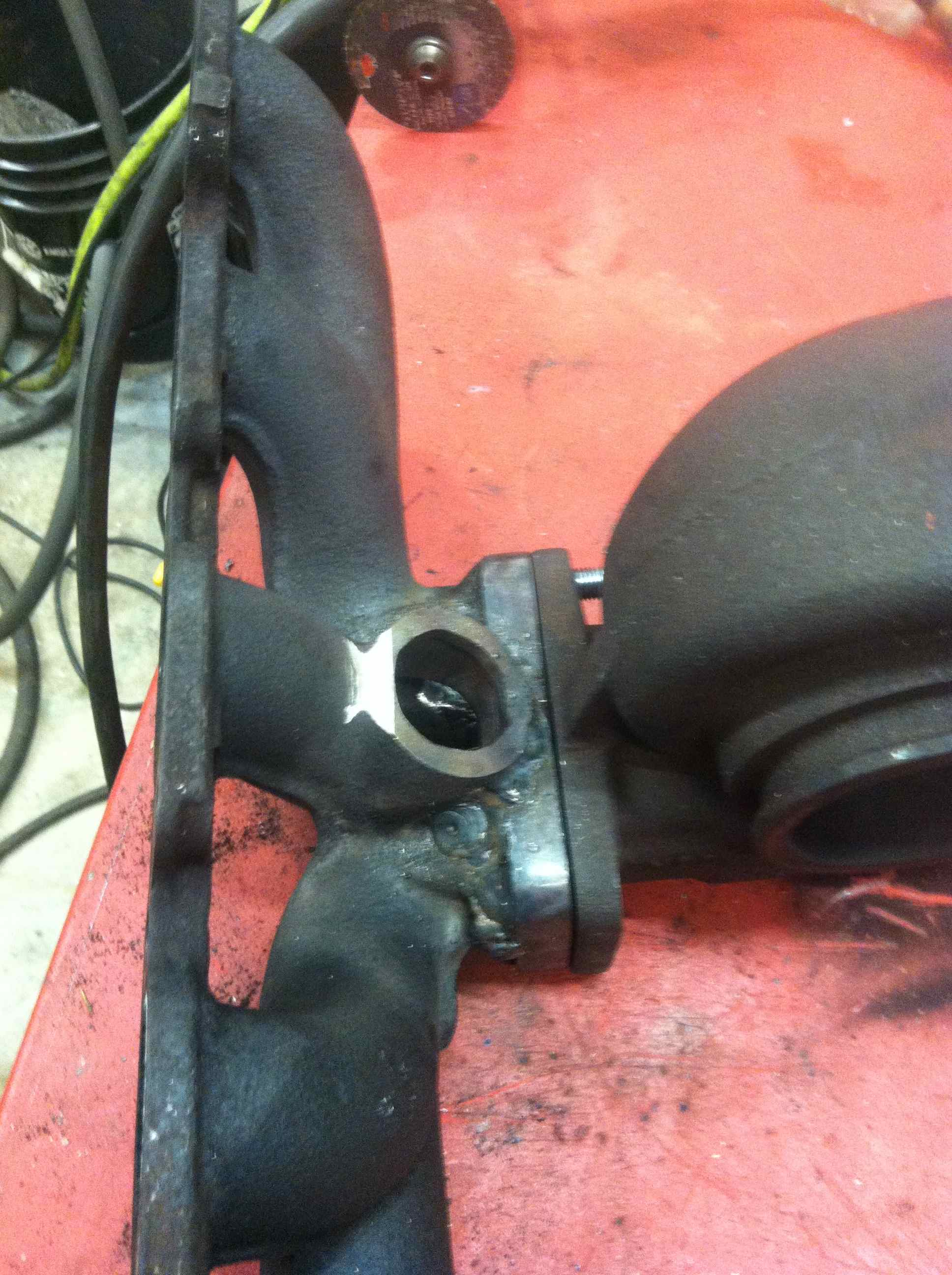

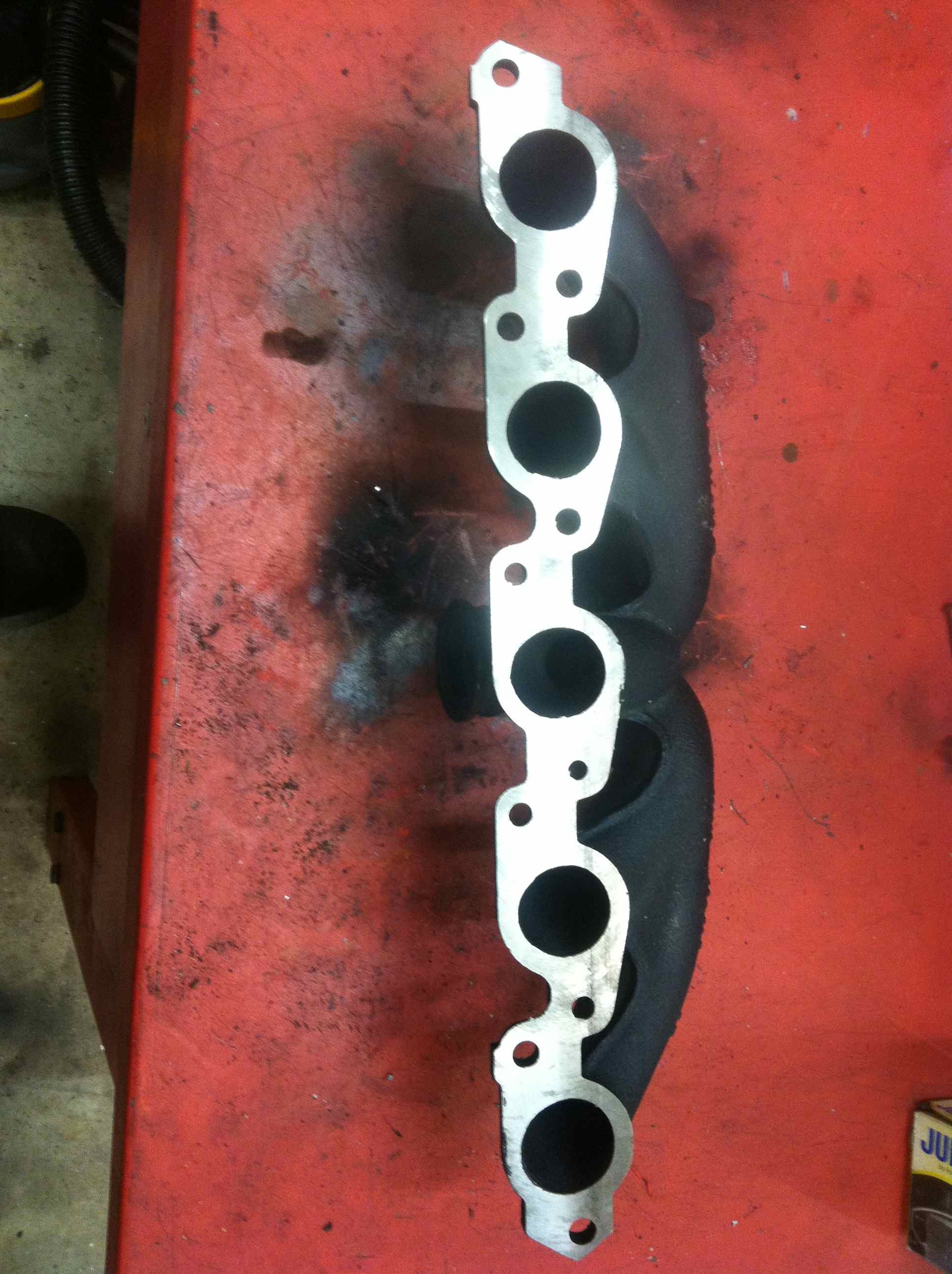

Got to working on the exhaust manifold this evening.... Pump left for Sweden Wednesday.
T3 Split flange with a divider to split exhaust pauses. Welded onto flange then into manifold. Roughly machined.
Port matching flanges, again only rough machining for now.
All looks well here!
And to finish the night with a a growler of WoodStock Brewery around the fire..

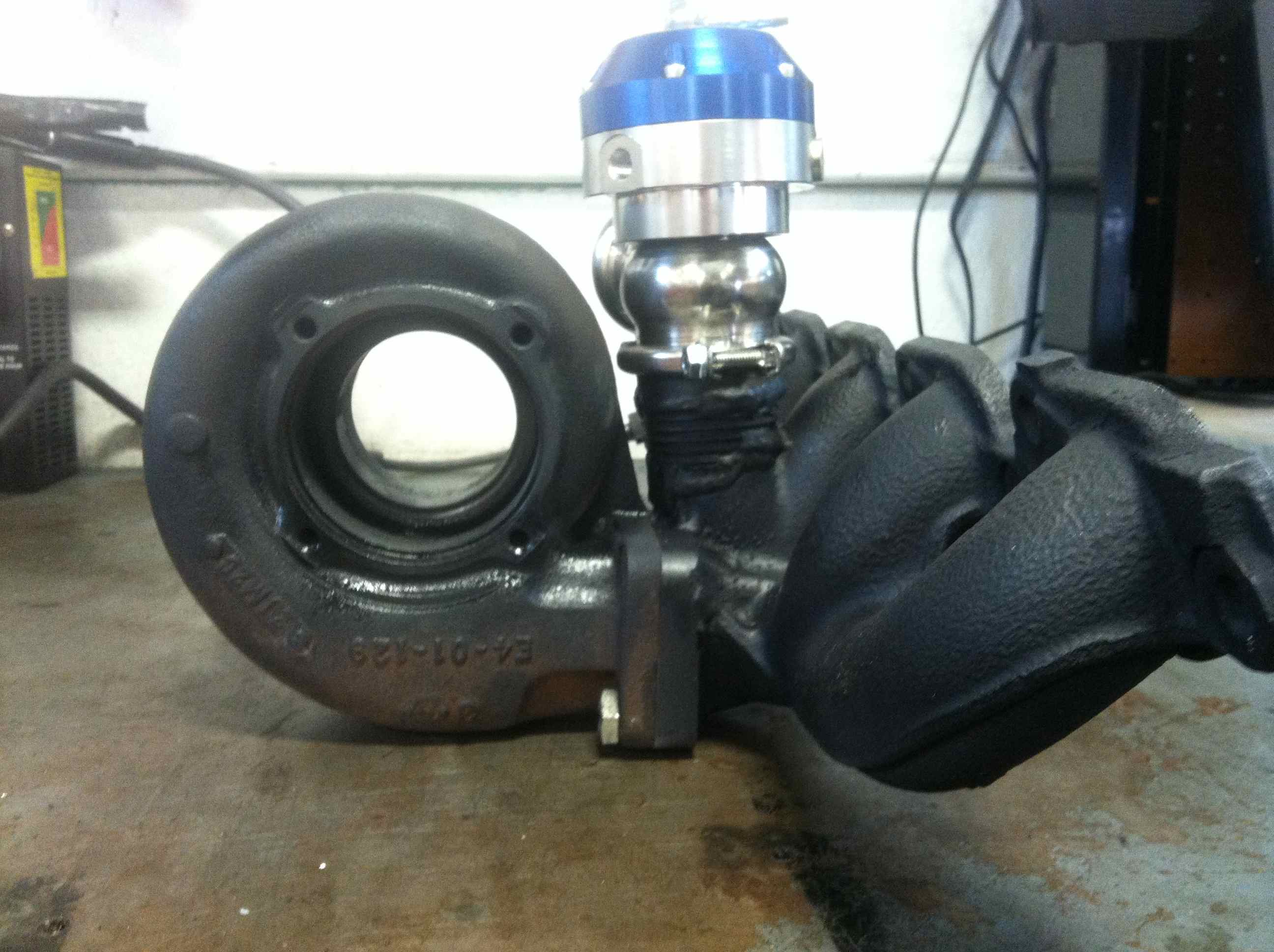

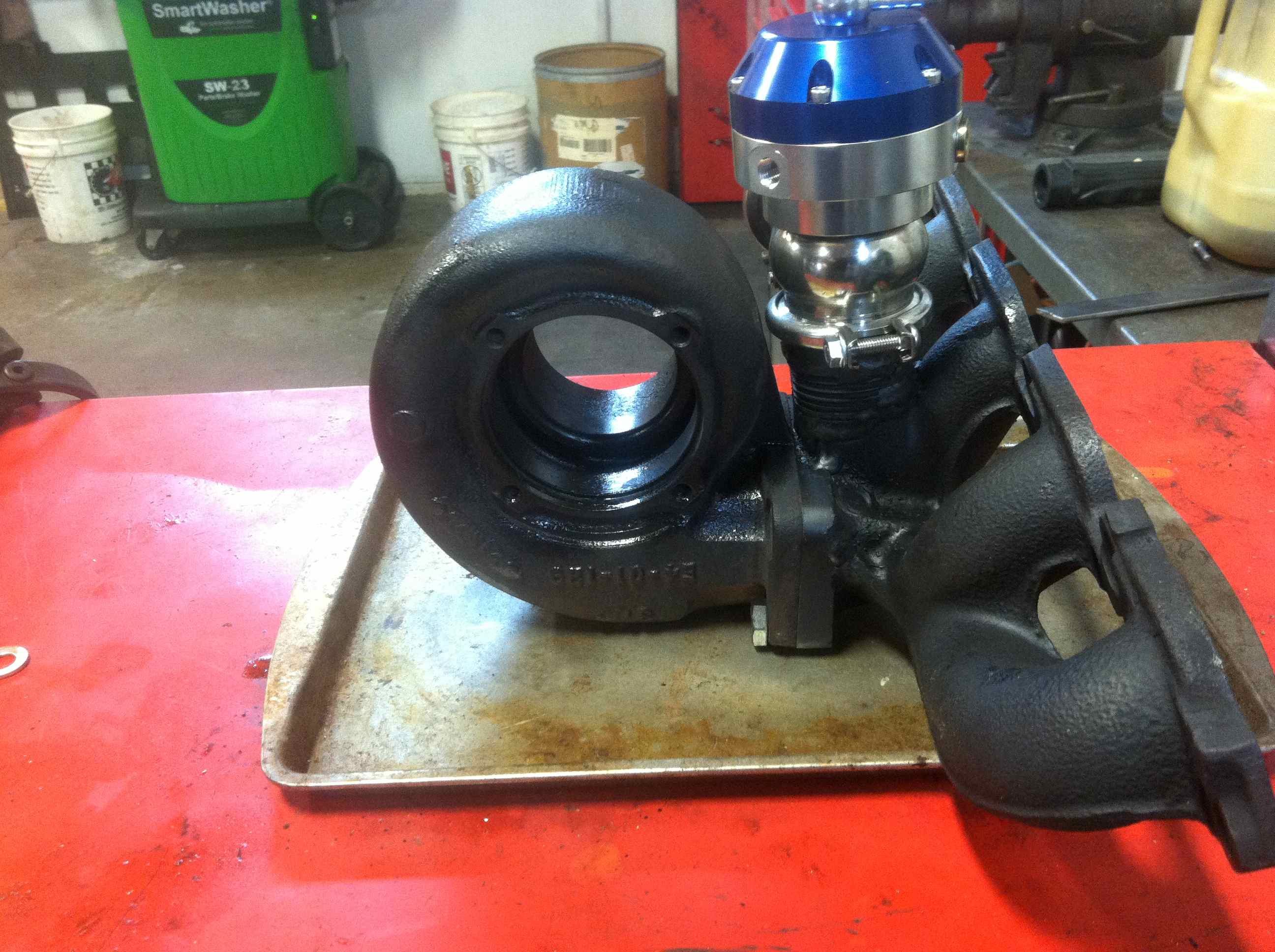

04-28-2013, 07:48 PM #7

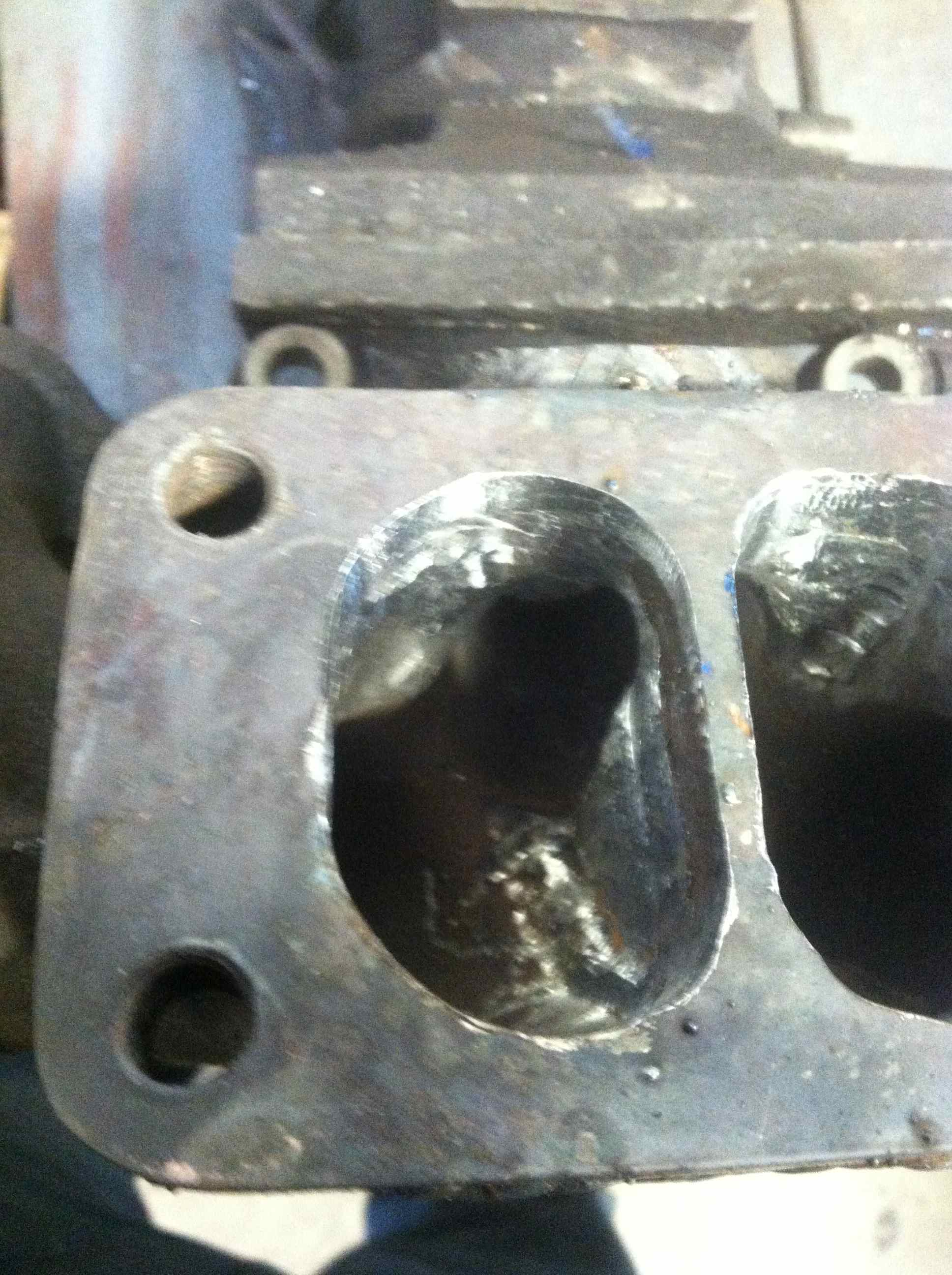

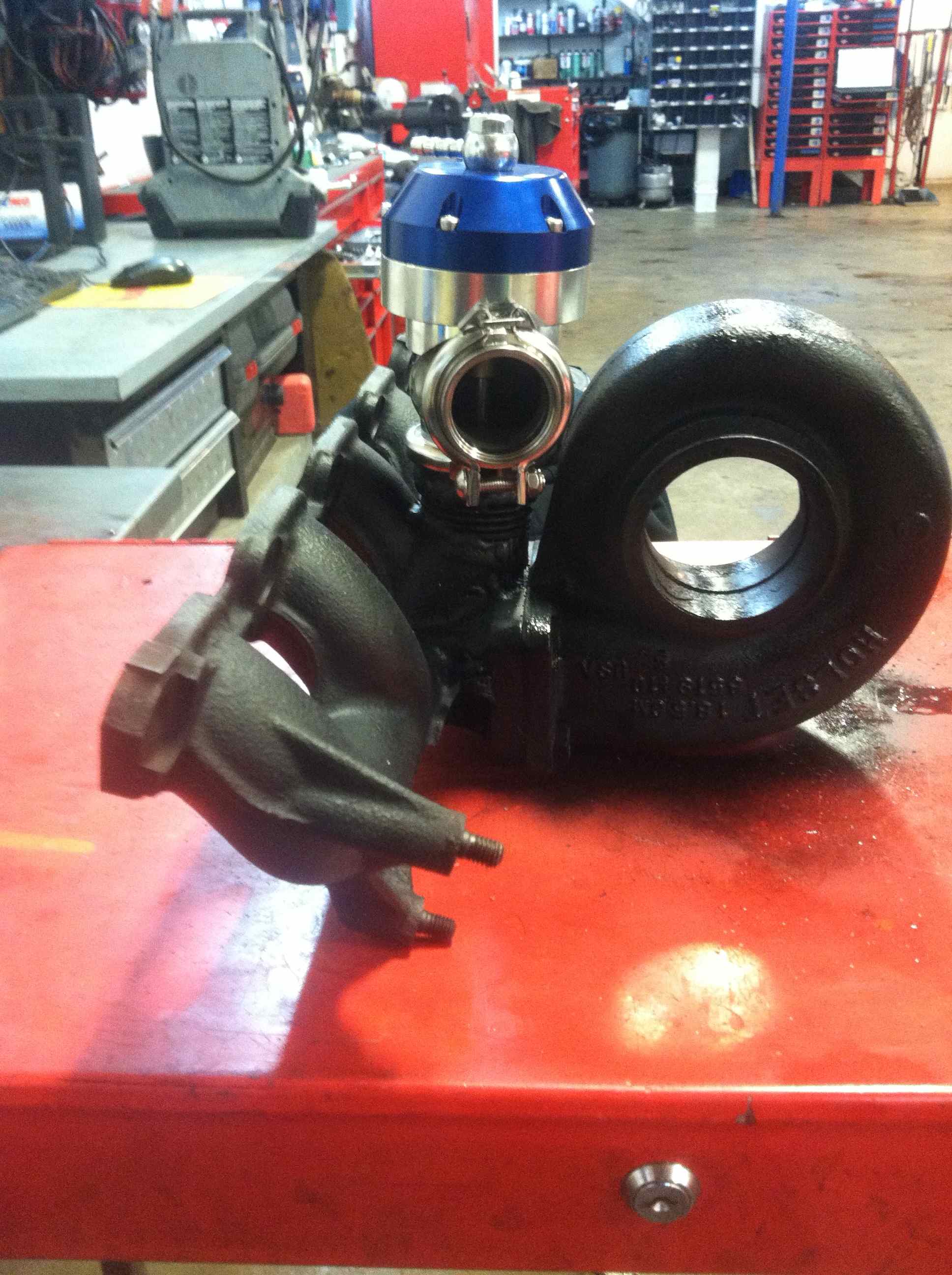

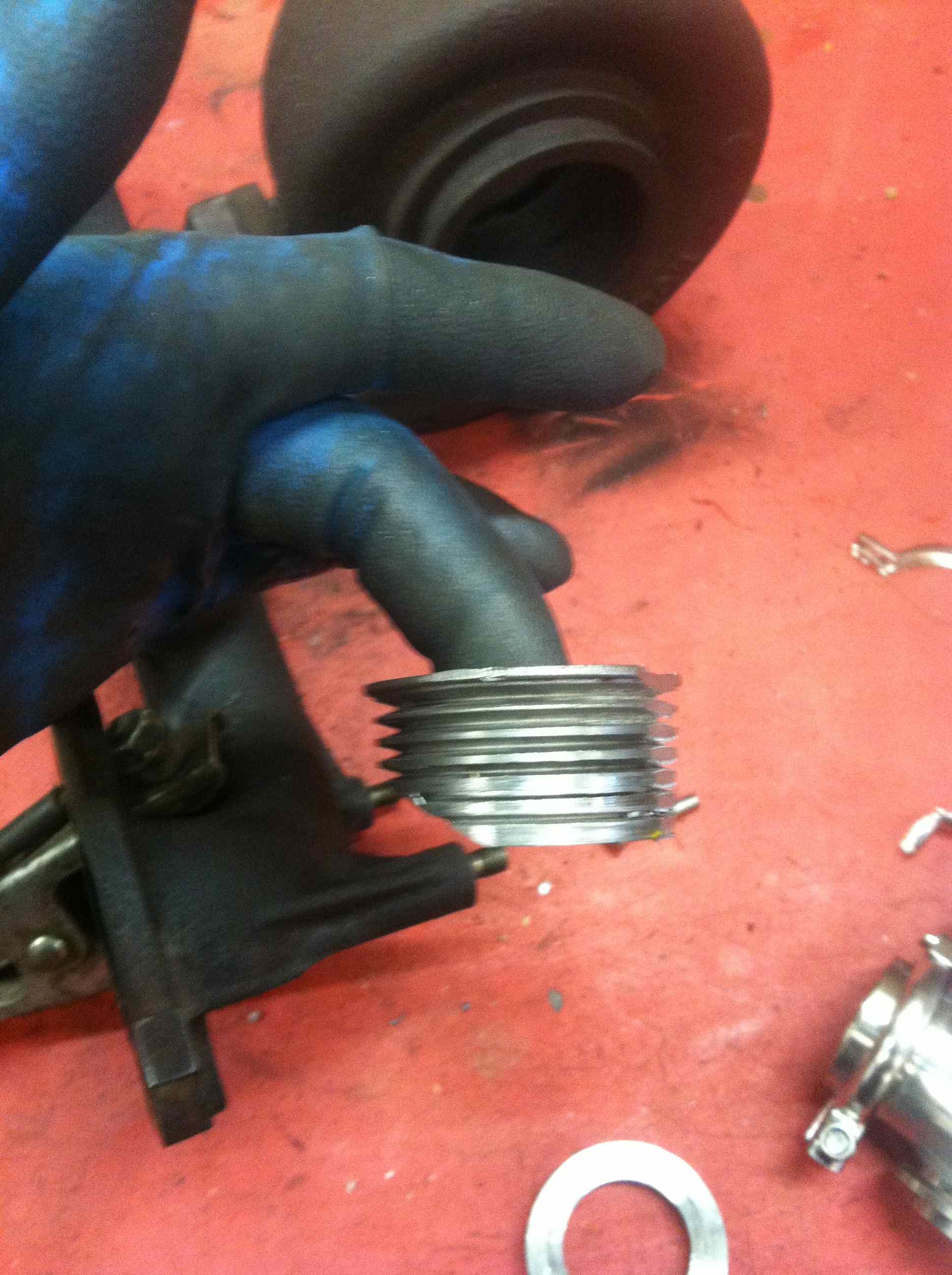

Finished up the split T3 flange porting. Turned down a sweet alternator pulley as a extension pipe for the external waste gate. Manifold DONE!

04-29-2013, 09:38 PM #8
Good idea with the wastegate!

04-30-2013, 10:19 AM #9
(04-29-2013, 09:38 PM)MFSuper90 Good idea with the wastegate!
Thanks. to bad about the crappy welds i did there....feed cable getting a bit loose on the MIG welder..
Really can't wait to get the pump back and see what this will do..

05-23-2013, 05:30 PM #12
Decided on using the small .63 on the H1C.....

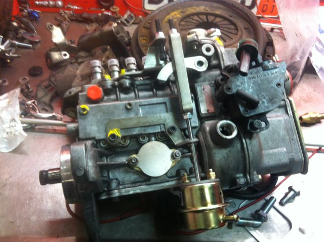

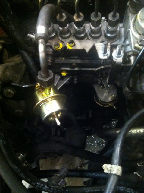

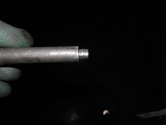

Dieselmeken Pump came in while i was out camping so i got around to installing it Saturday along with the electric lift pump and fuel pressure regulator (Saab SPG 3.0bar).. Built up a bracket for the turbo and oil return, made up a nice oil feed from steel line . Turned a 12x1.5 to 3/8 FIP on the lathe.
Pump timed and no throttle linkage hooked up. Cranked for 15 seconds and took off like the throttle was pined! Jiggled throttle lever, wouldn't stop, cut fuel pump and blasted with halon. Shut her down quick. Upon check everything seemed ok, Return spring hooked up correctly, linkage rutrns ok to what must be the stop, verify inlet is 3.0 bar, it is. Try to start it again and the damage is done. Exhaust valves meet with Mr. Piston. Boooo. Head coming of this week. I wanted to upgrade the valve springs anyways i guess........

06-10-2013, 05:34 AM #15
(06-09-2013, 08:38 PM)raysorenson Mother bitch. Sorry to hear.
Indeed, now to source some valve springs. Feel like i may be into uncharted waters here. Haha

maxypriest
287
06-10-2013, 10:30 AM #16
(06-09-2013, 06:19 PM)Duncansport Dieselmeken Pump came in while i was out camping so i got around to installing it Saturday along with the electric lift pump and fuel pressure regulator (Saab SPG 3.0bar).. Built up a bracket for the turbo and oil return, made up a nice oil feed from steel line . Turned a 12x1.5 to 3/8 FIP on the lathe.
Fuck, what happened? How come at full throttle?

Duncansport
526
06-10-2013, 11:41 AM #17
So far another cracking build!
Max
[/quote]
Still not sure, i think it could be related to inlet pressure, perhaps the check valve in the banjo bolt was stuck and the electric feed pump effectively was dead headed and forced to much fuel? Or something is stuck in the pump. How ever i really doubt that. I verified the shut off valve is hooked correctly and working.
Plan is to crank the engine (once back together) with the injector lines off and the throttle closed and see what sort of fuel flow is coming out of the IP. I will also put the inlet manifold on so at least o can block off the inlet if this happens again.
Really strange stuff, ive been working on theses engine for a long time and i have had pumps on and off many of times. This is my first issue like this. At least it was my own car haha

06-18-2013, 11:14 AM #18
Well head is just about done, new valve guides, minor bowl porting, new valves, weled up some pitting on head surface and finally the M103 valve springs.
The M103 springs are an exact match as far as size. However the wire diameter is 1mm larger and compressed to 1" they offer almost 100lbs more of pressure..
Should have it ready tomorrow and we'll have attempt two.

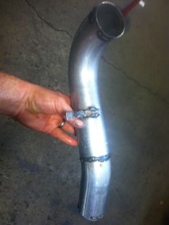

06-26-2013, 09:44 PM #24

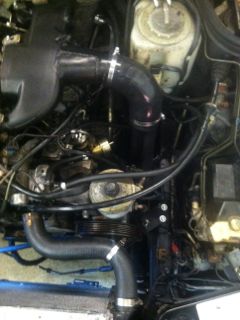

The old gal started to night after much cranking.. Intercooler piping fabbed up and almost ready for install. Still need to mount the radiator, wire fuel pump, fix the stinking ELR, and a bunch of other BS

07-28-2013, 09:26 AM #30

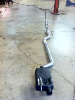

Slow go lately on the projects but here are some pictures of the intercooler plumbing and exhaust.
Picture of the removal of the diesel strainer and replacement with the 300E and it's feed hose, both being much larger in size
Turbo to intercooler
Down pipe and exhaust made up
Also made up a boost controller to put pressure on the top of the waste gate to force the boost up. Got 2 bar out of it and it's very awesome. Car looses traction when the boost hits in first and second (major slipping at the 1-2 shift with the 722)

Duncansport
526
08-14-2013, 09:15 PM #32
Video of a pull away from a stop.
Transmission dying quickly....
http://youtu.be/0jXb5SN9OFY
Duncansport
