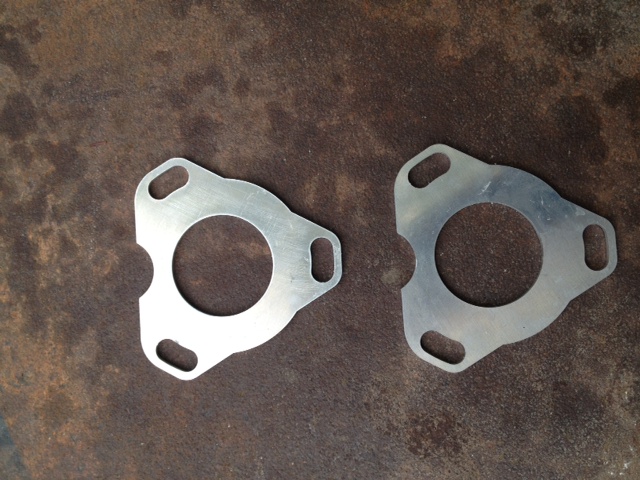

06-26-2013, 07:54 AM #52
Just to be clear, if I want to put a VE pump on a 616 all I need is:
-OM616
-VE pump
-3mm shim
-New injector lines

06-26-2013, 08:15 AM #53
(06-26-2013, 07:54 AM)Simpler=Better Just to be clear, if I want to put a VE pump on a 616 all I need is:
-OM616
-VE pump
-3mm shim
-New injector lines
1 pc
What I made on this bus is not tunning. But from this can be 120-140 hp (with turbo without smoke).
It is just from waste parts project form my friend (non profit for canoe sc)
It's ultralight.
Tunning injector inculdes more exact parts.
Offroaddieselhu

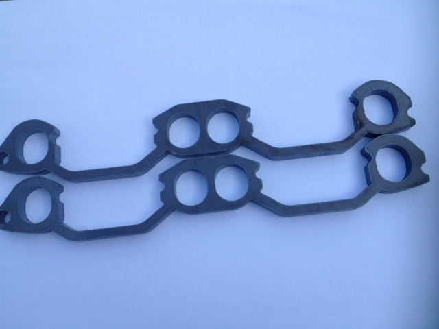

05-22-2014, 10:03 AM #56
+ turbo
offroaddieselhu
