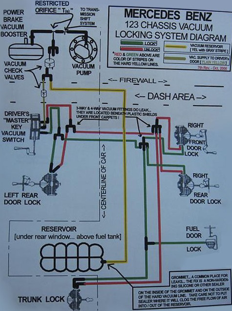

06-26-2009, 04:01 AM #3
Use this diagram. The two 4-way connectors are under the front carpets and plastic covers. At those two junctions you will be able to test all but two actuators individually and isolate the leaking one(s) without needlessly taking off any door panels.
