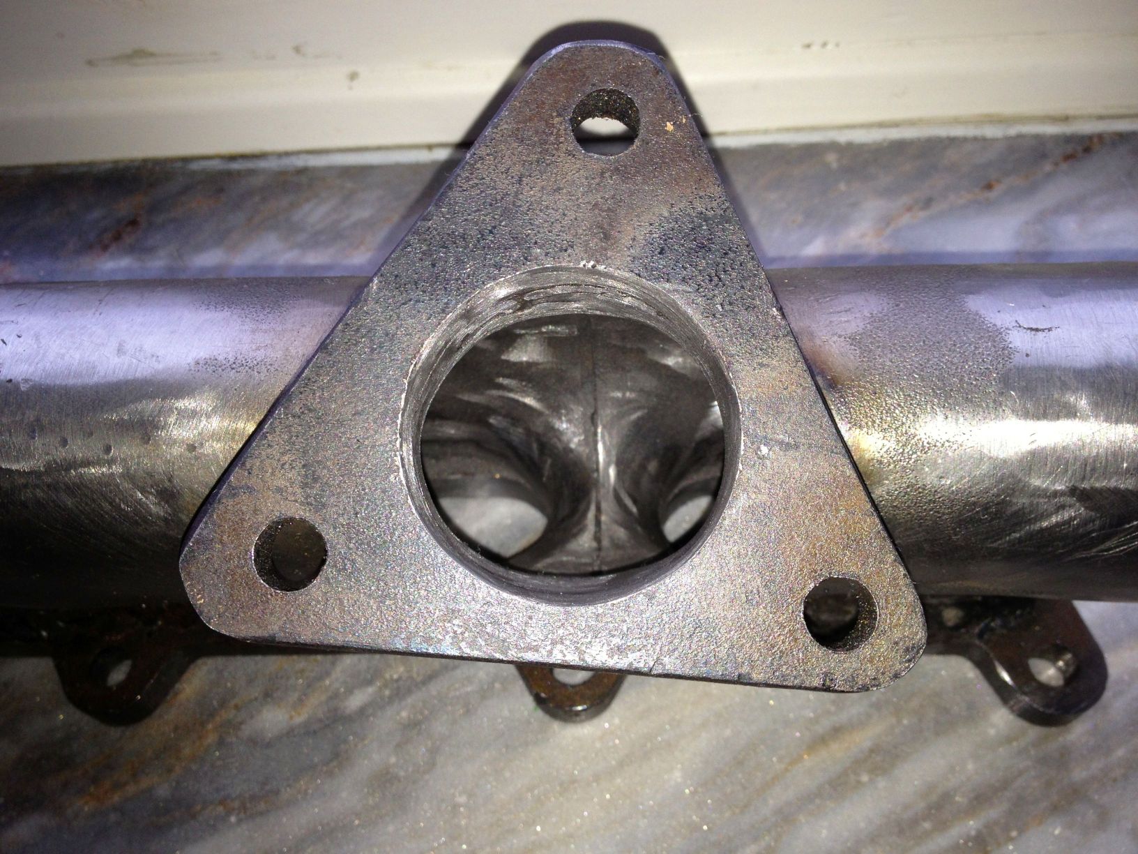

Hello Everyone !!

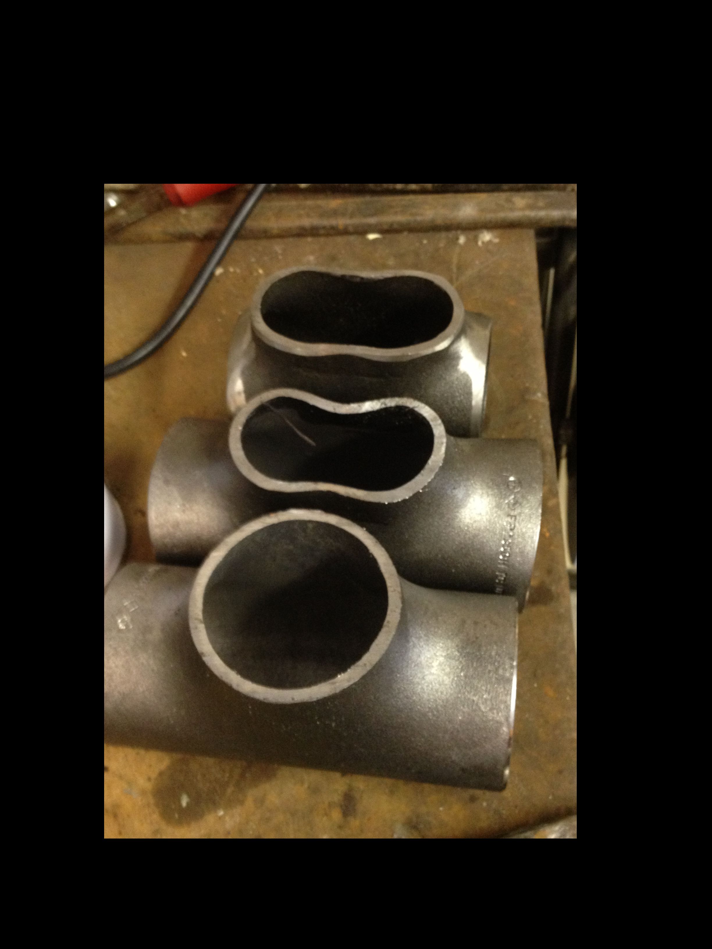

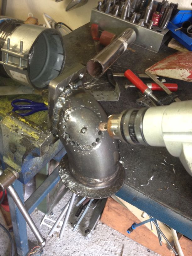

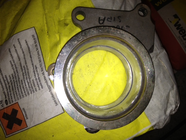

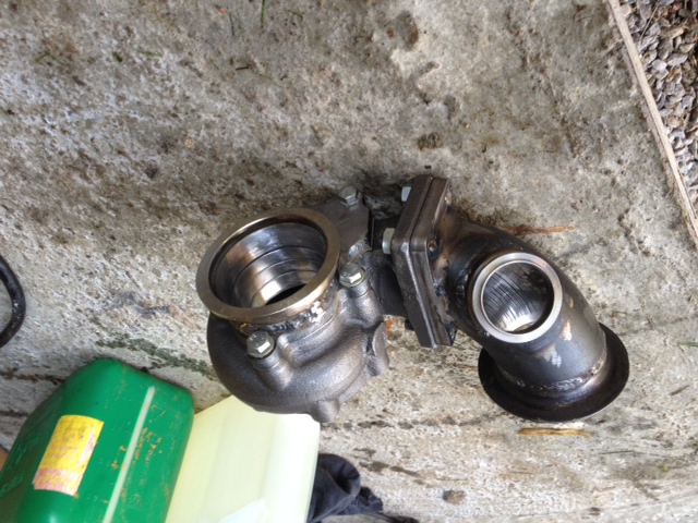

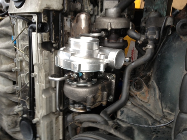

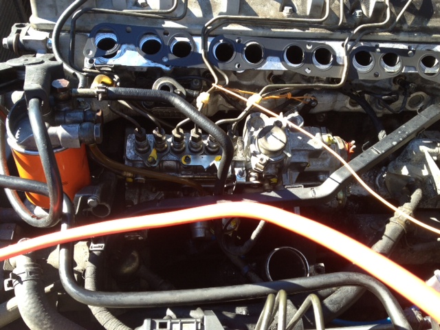

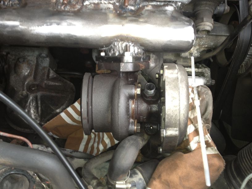

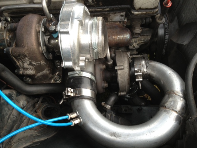

Im starting a new project building a OM 606 Compound turbo in a 98 Mercedes 300TDT.
I will use the org KKK turbo and an T 70 turbo.
here are some pictures so far :
Best regards from Sweden...To be continued !!

Hello Everyone !!

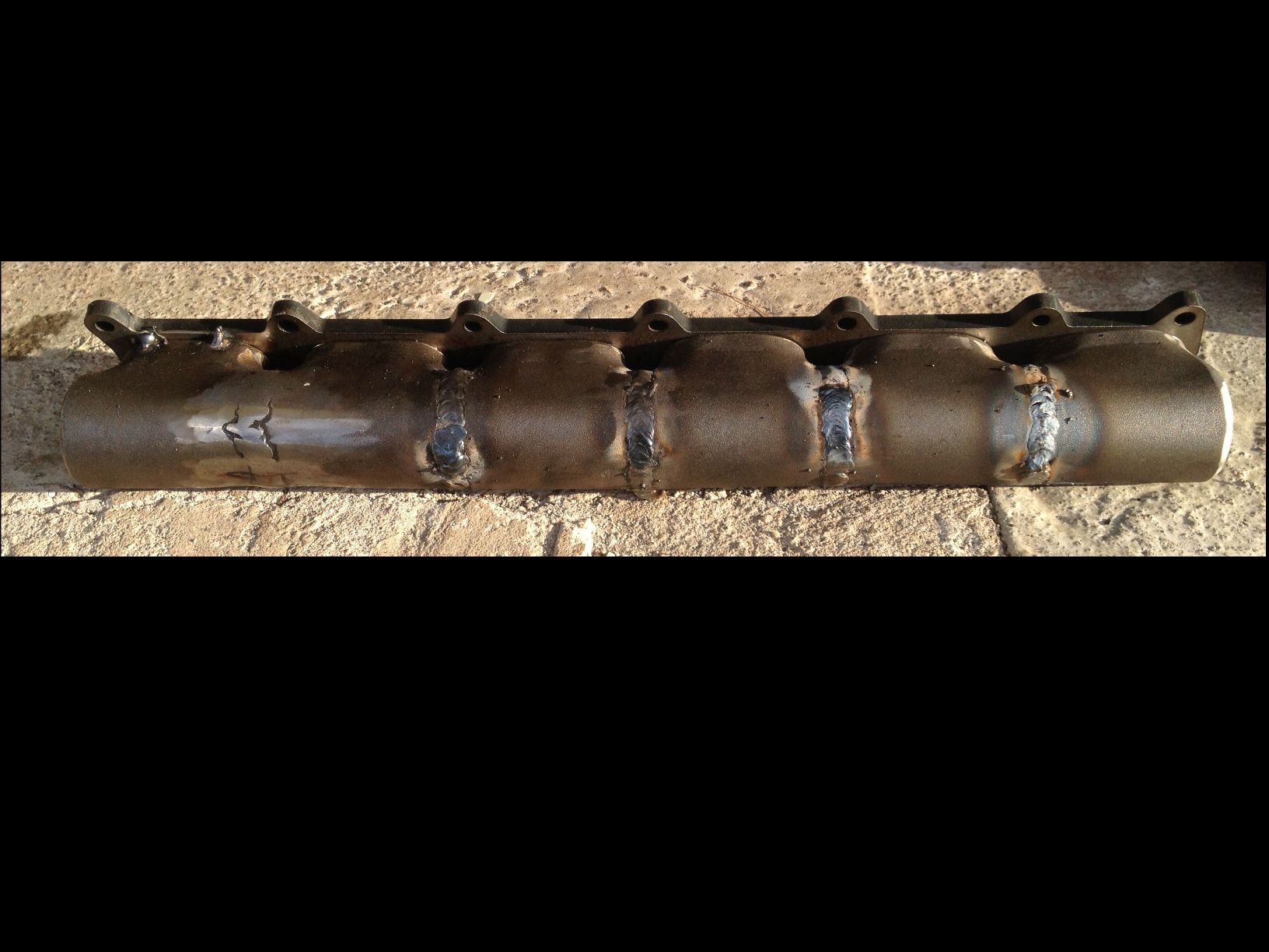

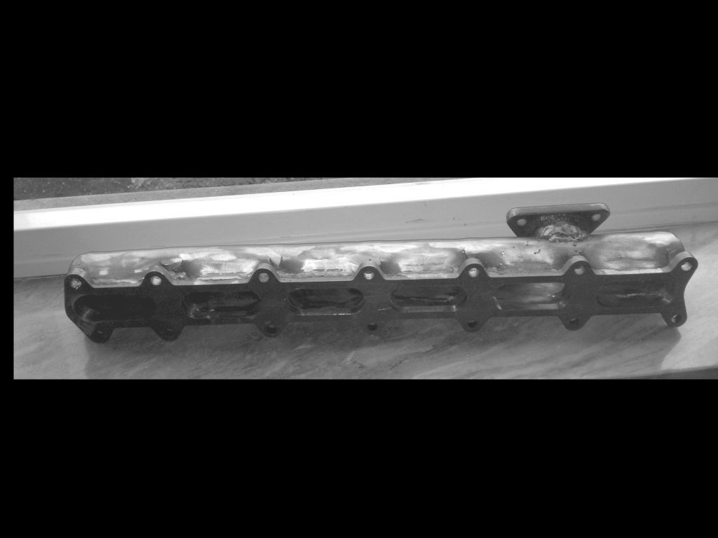

08-08-2013, 02:22 PM #2
That's a clever log manifold, I might need to steal your ideas

08-10-2013, 08:26 AM #5
(08-08-2013, 02:22 PM)Simpler=Better That's a clever log manifold, I might need to steal your ideas
Just build a similar one thats nice when ideas can inspire others Big GrinBig Grin
(08-08-2013, 02:43 PM)CRD4x4 Subscribed!!
Nice work! Could you share more about your compound setup? Bypass? BOV?
I'm very interested and can't wait to see more progress!
Keep up the good work
There gonna be an 60 mm WG bypassing the small turbo when the exhaust back pressure is too high and no WG in the small turbo a strong spring will hold that shut.On the pressure site it will be no by pass just a big Inter cooler .

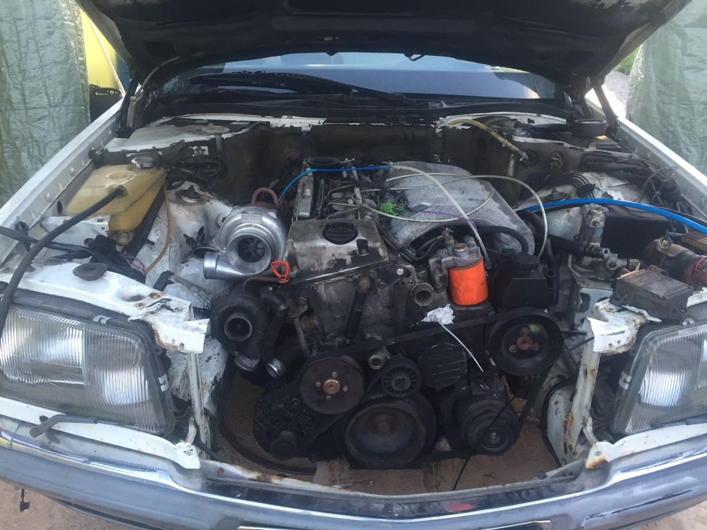

Sotvisp
42

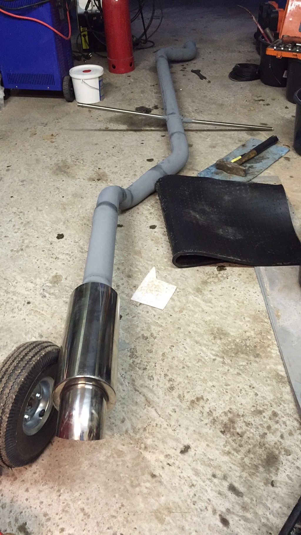

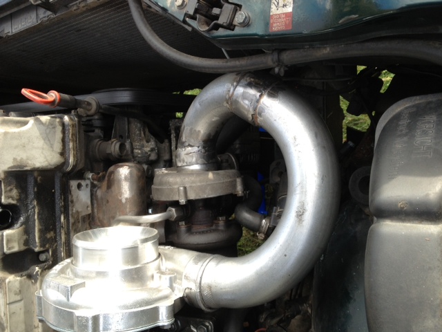

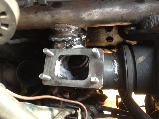

08-18-2013, 01:56 PM #6
Some New pictures of the exhaust part...
it´s great when the parts are made from head till reality Big GrinBig Grin

08-20-2013, 12:58 AM #8
How do you reckon your log manifold compares to a tubular? I'm sure your setup is plenty powerful as it is. I'm also interested as to where to get some T's like that and how you bent yours if you don't mind sharing?
This post was last modified: 08-20-2013, 01:03 AM by 97e300.

08-20-2013, 08:22 AM #9
They look like plumbing tees, the same ones you would weld together on railings, etc.
It loks like they were ovaled with a hammer or press or vise
This post was last modified: 08-20-2013, 08:23 AM by Simpler=Better.

Sotvisp
42
08-20-2013, 11:43 AM #11
Hello !!
The T tubes i use are from a local hardware shop it´s for steam piping etc 4 mm thick , the diameter is 2,5 " or 65 mm .
i did the ovaling by hand with a two steel rods and a big wise and some sledgehammer Smile
Diesel Power

(08-29-2013, 06:46 AM)Ksteen2 62.5mm Wink

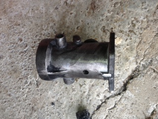

When the turbo goes to hell, save the exhausthousing! It is bolt on to the hx35 and hx40!!!
EDH_Performance
08-31-2013, 07:18 PM #20

09-04-2013, 09:41 AM #21

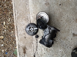

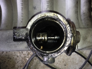

No more EGR !!

09-04-2013, 05:18 PM #22
looks very nice did you have to weld the housing when you got all of that stuff out?Big Grin
This post was last modified: 09-04-2013, 05:19 PM by willbhere4u.

09-05-2013, 10:24 AM #23
(09-04-2013, 05:18 PM)willbhere4u looks very nice did you have to weld the housing when you got all of that stuff out?Big Grin
I put M6 and M10 carriage bolt from the inside and machined them down.
Diesel Power
Sotvisp

09-05-2013, 11:26 AM #24
nice and simple I like that idea

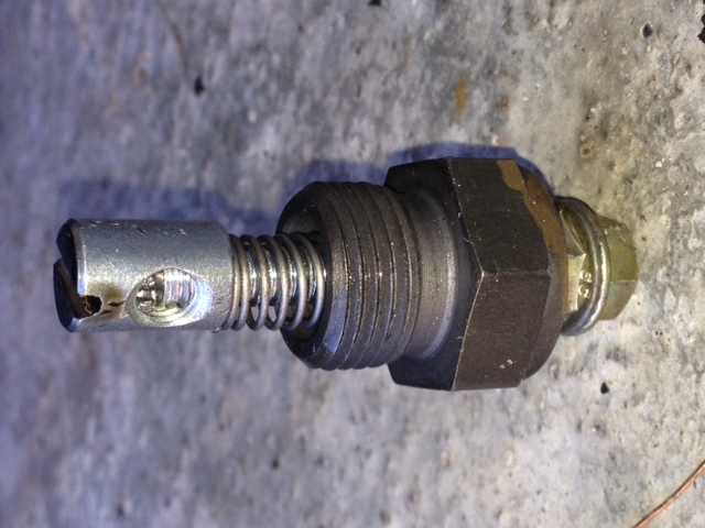

09-08-2013, 12:53 PM #25

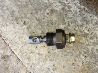

Finally i have mounted the new pump from Dieselmeken in my car.
The original leaking O-ring Pre filter is in the garbage bag and a "new" from an OM616 w 123 is mounted with "real" banjocouplings !! so no more bubbles .
I have started the car and i runs perfect ! so soon the turbos will be installed.
a couple of pics i made a tool for the pump with IKEA parts SmileSmile

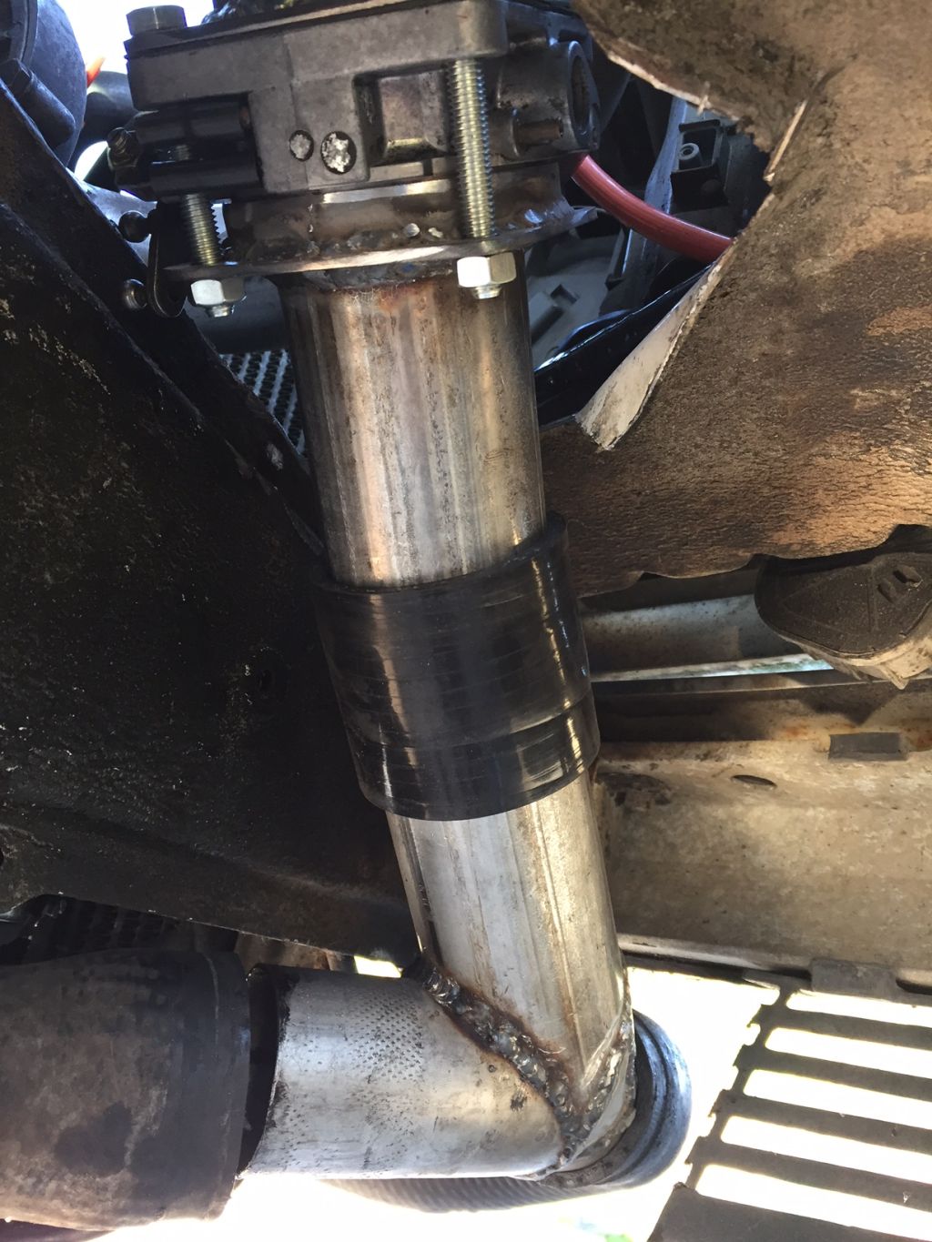

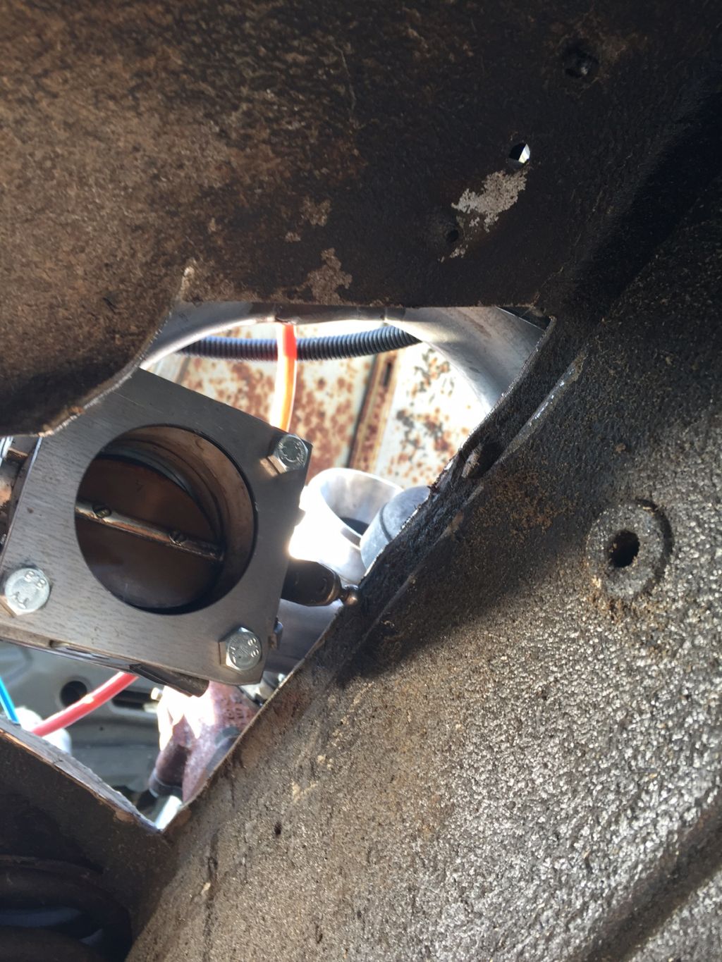

10-02-2013, 04:53 PM #27
Hello you said you are using an external wastegate to bypass the high pressure turbo but there is no wastegate flange on the manifold?
The wastegate flange you fitted seems to be on the high pressure turbo outlet?
Or am I misunderstanding?
H.
This post was last modified: 10-02-2013, 04:54 PM by Hario'.
H.
10-03-2013, 10:16 AM #28
(09-08-2013, 12:53 PM)Sotvisp Finally i have mounted the new pump from Dieselmeken in my car.
This is my new favorite post on STD. A Swedish guy made an IP timing tool from IKEA parts.

10-29-2013, 12:03 PM #29
Hello again long time no see..
The car is up and running now som fine adjust to be done with wastegate it´s running fine with boost from 1000 rpm and up ..
here are some more pictures..
Diesel Power
Sotvisp
Diesel Power

10-29-2013, 12:29 PM #30
Look fantastic. Would love to see and hear some video of it.

10-29-2013, 01:40 PM #31
looks great! I would love to see some videos and hear how that sounds!

10-30-2013, 03:20 AM #32
lovley build, but how did you manage you'r oil?
return from the T70 to the small ? or did you make two single systems?

10-30-2013, 09:56 AM #34
(09-08-2013, 12:53 PM)Sotvisp a couple of pics i made a tool for the pump with IKEA parts SmileSmile
Brilliant!

Sotvisp
42
10-30-2013, 01:54 PM #35
(10-30-2013, 03:20 AM)Ksteen2 lovley build, but how did you manage you'r oil?
I make i y crossing just above the original oil return in the block a bit tricky but running well now..
(10-30-2013, 04:32 AM)Flakis Very nice Wink But i put my dieselmeken 7,5mm pump on 14 degrees and got a really good response Wink
Where in Sweden are you from? Smile
Im from Blekinge sweden ..is it more fast rev in the 14 degree mode??
(10-29-2013, 01:40 PM)willbhere4u looks great! I would love to see some videos and hear how that sounds!
There will be videos Big GrinBig GrinBig Grin
This post was last modified: 10-30-2013, 01:57 PM by Sotvisp.

03-05-2014, 05:29 PM #41
(10-02-2013, 04:53 PM)Hario Hello you said you are using an external wastegate to bypass the high pressure turbo but there is no wastegate flange on the manifold?
H.
I have realized I am an idiot with the above comment. lol
606 compounding with the factory turbo for HP turbo is awesome and exactly what I want to do..
Keep it up.

I can't get my head around this setup. There must be a wastegate between the big turbo and the 2nd manifold exit I guess?

Only enough wastegate bypass is needed to keep manifold back pressure down, 44mm for example?
The HP turbo only needs enough exhaust to drive the compressor wheel to produce 15psi PR (example figure).

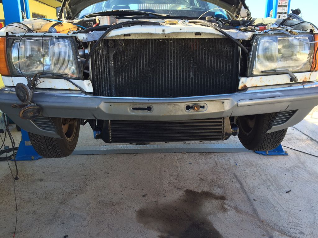

09-08-2016, 02:12 PM #46
380se om606 rebuild
Some new pictures
mounting of new intercooler build a new exhast bypass valve for the lp turbo
more to come.
This post was last modified: 09-13-2016, 05:41 AM by Sotvisp.
