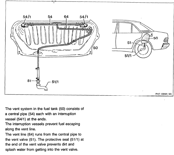

08-27-2013, 04:58 PM #4
hope this helps
should be the same w123 and w126
This post was last modified: 08-27-2013, 04:59 PM by willbhere4u.
hope this helps
08-28-2013, 08:30 AM #5
As I understand, fuel enters the tank when filling at a higher rate than the vent, or it's plumbing, is designed to flow. Most vapor is going to come out of the filler neck, hence it's huge diameter.

08-30-2013, 12:14 PM #9
Newer cars have much smaller diameter filler pipes with a small line (~8mm O.D. metal) running parallel to the filler that enters the filler neck just behind the fuel cap. This allows the displaced vapor to exit the filler neck without having to travel the distance from the tank against the flow of fuel.
Running a similar line from the vent plumbing to just behind the fuel cap might help. Once the fuel cap is in place, the vent system will essentially function as before.
