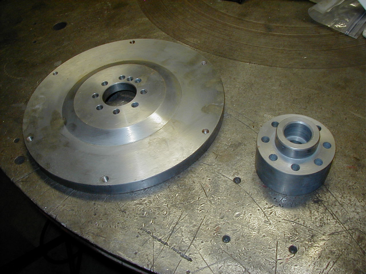

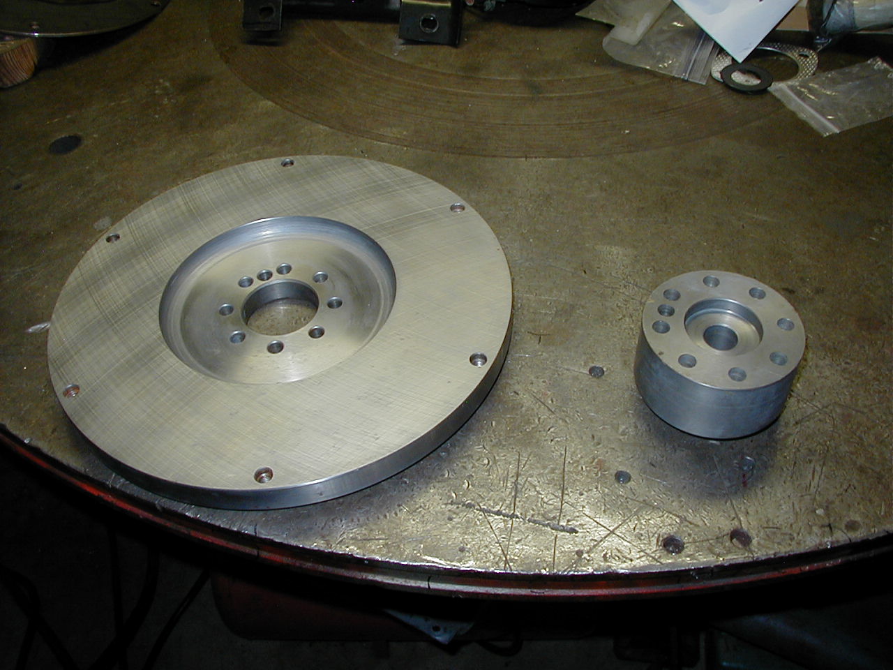

Knowing Mercedes there would be something different. Here are some pics of the Cherokee custom flywheel. Also the G Wagon came with a 603 which would be the same pattern as the 606 and would be a 4x4.
