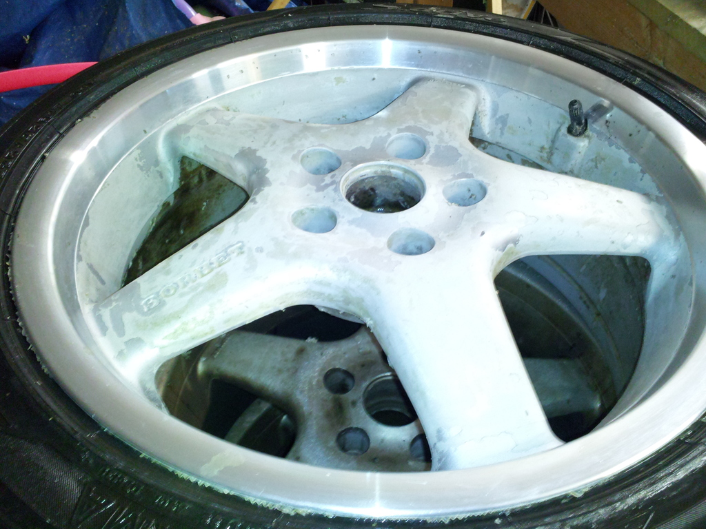

I am not even going to pretend to claim I did this the right way or that I couldnt have done a better job on some aspects. I wasted about $40 in stripper trying to get down to the roughcast to keep its natural color and ended up discoloring it with the plastic scraper I was using. I think it looks just fine with paint and clear coat (needs more). FOLLOW THE DIRECTIONS ON THE CAN!!!!

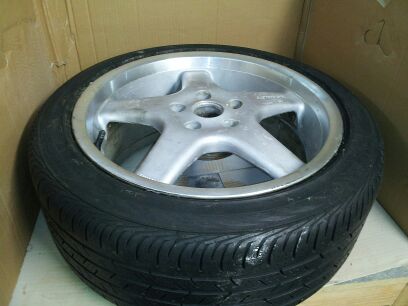

This was the final stripped wheel:
[Image: 2013-09-20%2013.50.21.jpg]

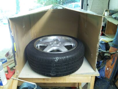

You will need a spray booth for this, I reused a fairly large box with pretty decent success. It was the first time I've managed not to get debris in the paint!

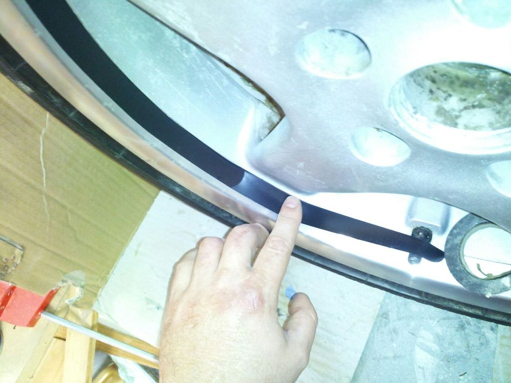

I had some really wierd contours and rather than use bits of masking tape and not have a smooth edge, I used vinyl electricians tape. It cuts a good smooth edge, didn't allow any bleed and was flexible and easy to work with. I was able to use a single piece for the entire wheel. Once you have a good starting point stuck well, you can hold the tape in one hand and then use your index finger to apply some stretch and align it properly. Lucky for me, Borbet had cut into the wheel to polish it so there was a nice clean line for me to work with.

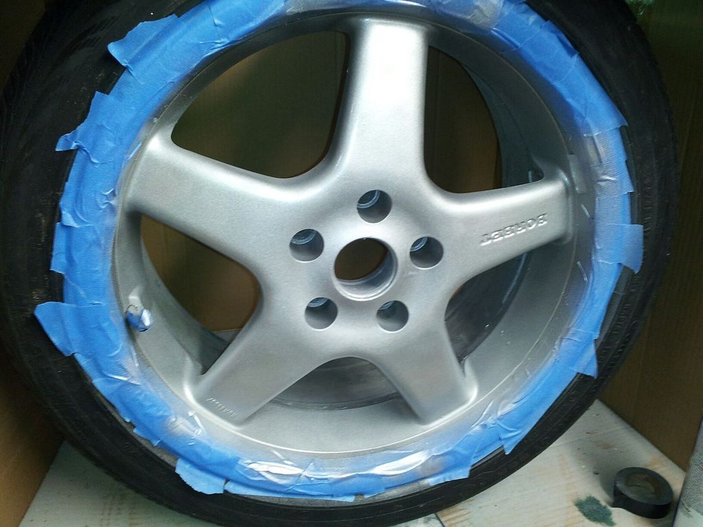

After you cut the line, use the blue tape. I used about 4 pieces and then cut in from the outer edge to allow it to lay down, went back in with little pieces and filled in the gaps. What I didn't do and SHOULD have done was cover the tires. Ended up with a little overspray but nothing to worry about on rubber :

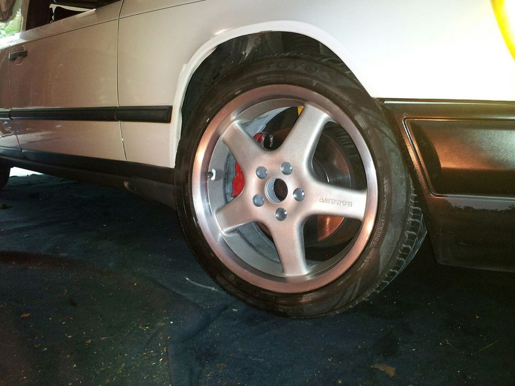

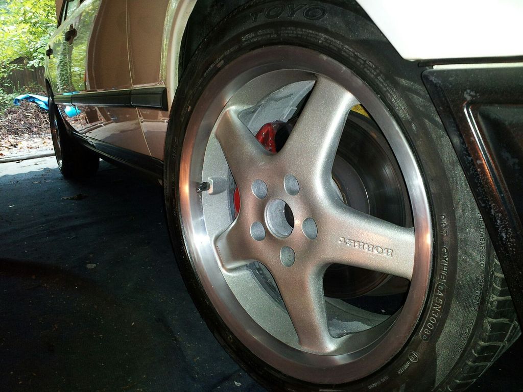

For now this is the finished product. Not too shabby I think.
[Image: 2013-09-21%2012.41.25.jpg]
[Image: 2013-09-21%2012.40.59.jpg]
This worked out OK for me since I still need to redo the lips and really don't want to do that this weekend. As it is, I cleaned up the lips with some scotchbrite pad and 600 grit using soapy water. This did not give me a mirror finish but did take out most of the stains where the old clearcoat had chipped off. There is also some curbing that needs attention as well, I will take a pretty rough grit to that by hand and then get it up to 600 as well.
