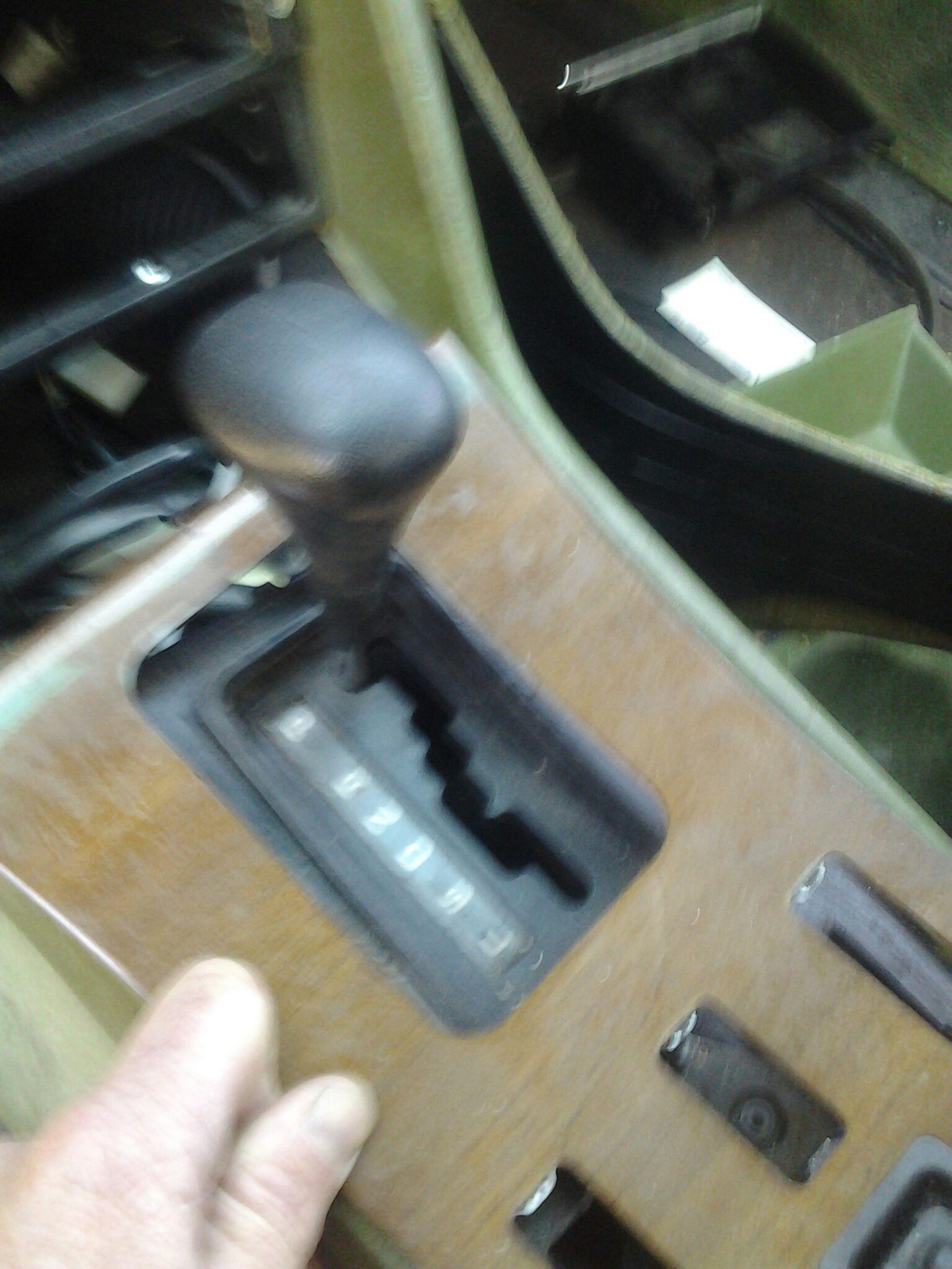

06-05-2014, 11:29 PM #7
WDB12602212002407

06-08-2014, 04:33 AM #8
Looks like a 717 is on board...

06-10-2014, 03:30 PM #9
Unfortunately not...

NapaBavarian
119
06-10-2014, 09:54 PM #10
But at least I got a pair of nice condition euro bumpers out of the deal
Gotta love that color, two euro 280se in that yard, same interior color, other car was a w116
