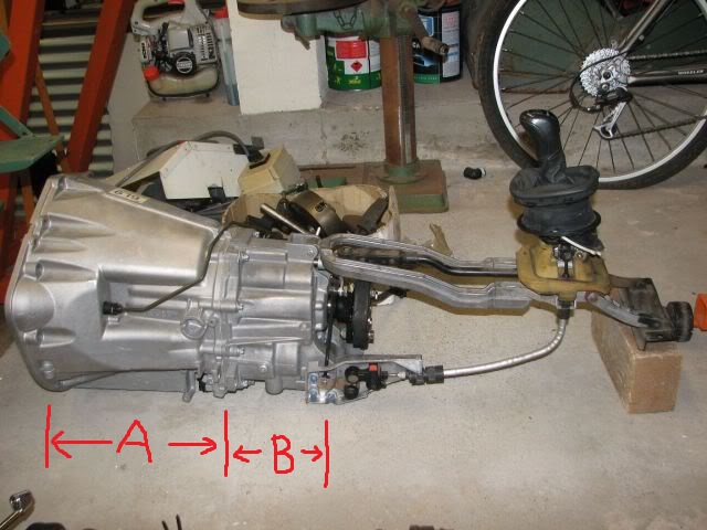

Hi Everyone,
I'm looking at using a 716.6xx 6 speed behind an OM606 for a project, and I'd like a specific measurement please.
Please see the photo below - if anyone can measure length 'A' and 'B' please, that would be fantastic.
Basically, I'd like to know the overall length of the 716.6xx gearboxes, and the length of the front and rear halves of the gearbox casing.
Thanks,
-Dan

06-18-2014, 09:48 AM #2
(06-17-2014, 01:24 PM)Grecy Hi Everyone,
Thanks,
-Dan
A=298mm
B=160mm (to the outer edge of the seal on the gearbox output flange)
When I measured to the furthest point of the gearbox casing extrusion which is used to attach the gearbox rubber mount (the gearbox output shaft extends to approximately the same distance) the overall length of the gearbox is 525mm.

06-18-2014, 11:04 AM #3
(06-18-2014, 09:48 AM)pryantcc A=298mm
Thank you very much, that's extremely helpful!
-Dan
