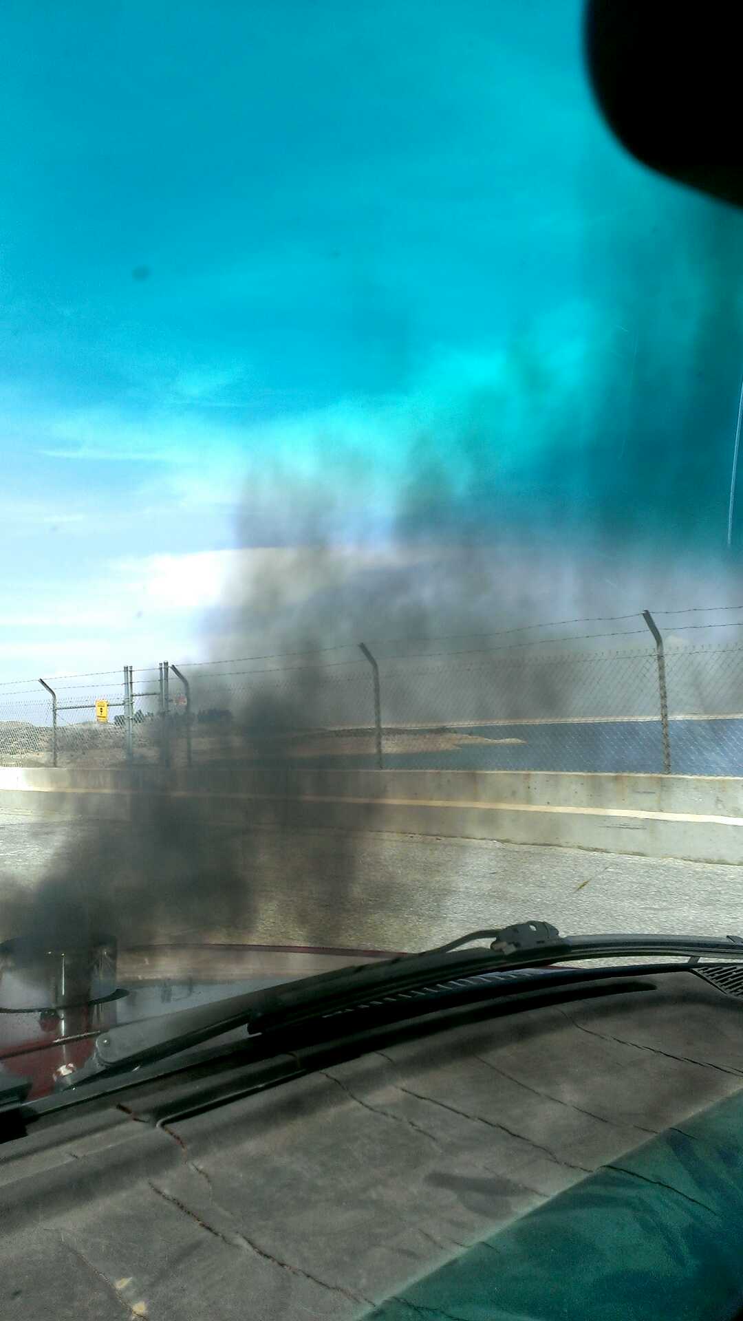

You can't talk about a hood stack and not deliver photos!!
Faaaaaack ok haha
Faaaaaack ok haha
08-07-2014, 02:17 AM #7
I dont have many pictures haha
http://instagram.com/p/nEjr33EhCU/?modal=true
http://instagram.com/captain___america
