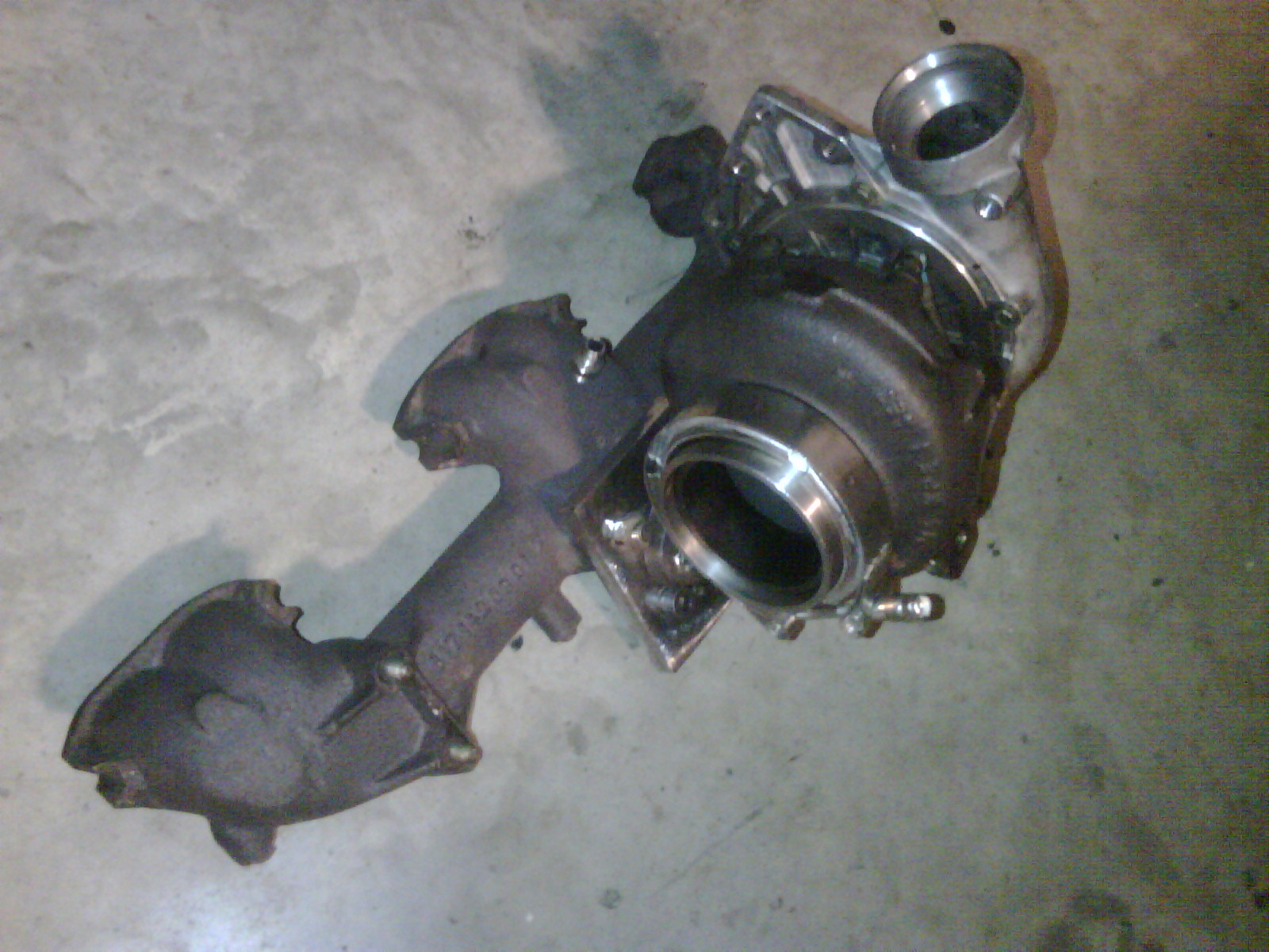

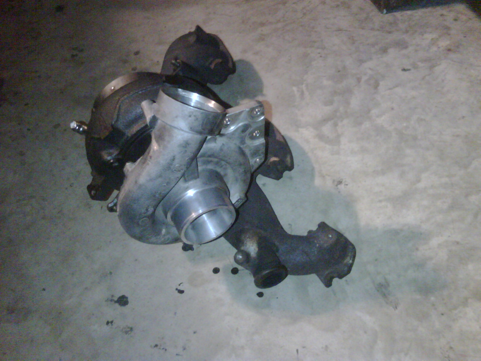

08-25-2009, 07:26 AM #13
Here are some pics of the 648 turbo to 617 project. Will have more pics soon.

08-25-2009, 07:44 AM #14
What is that intercooler from?

08-25-2009, 07:55 AM #15
early 2000 c230 sport (203 chassis with 271 engine)

08-25-2009, 08:12 AM #16
This looks like the same turbo that I have installed in my SD. Should be a GT23. Pics in the VTG installation thread.

08-25-2009, 09:39 AM #17
Looks like a GT2256V. Can you confirm? If it is do you want to make another adapter for me? pm price if it is a gt2556v.

08-25-2009, 09:58 PM #19
(08-25-2009, 09:39 AM)winmutt Looks like a GT2256V.
Its a 2359, the compressor housing is right.

08-26-2009, 08:08 AM #20
That is correct it is a 2359

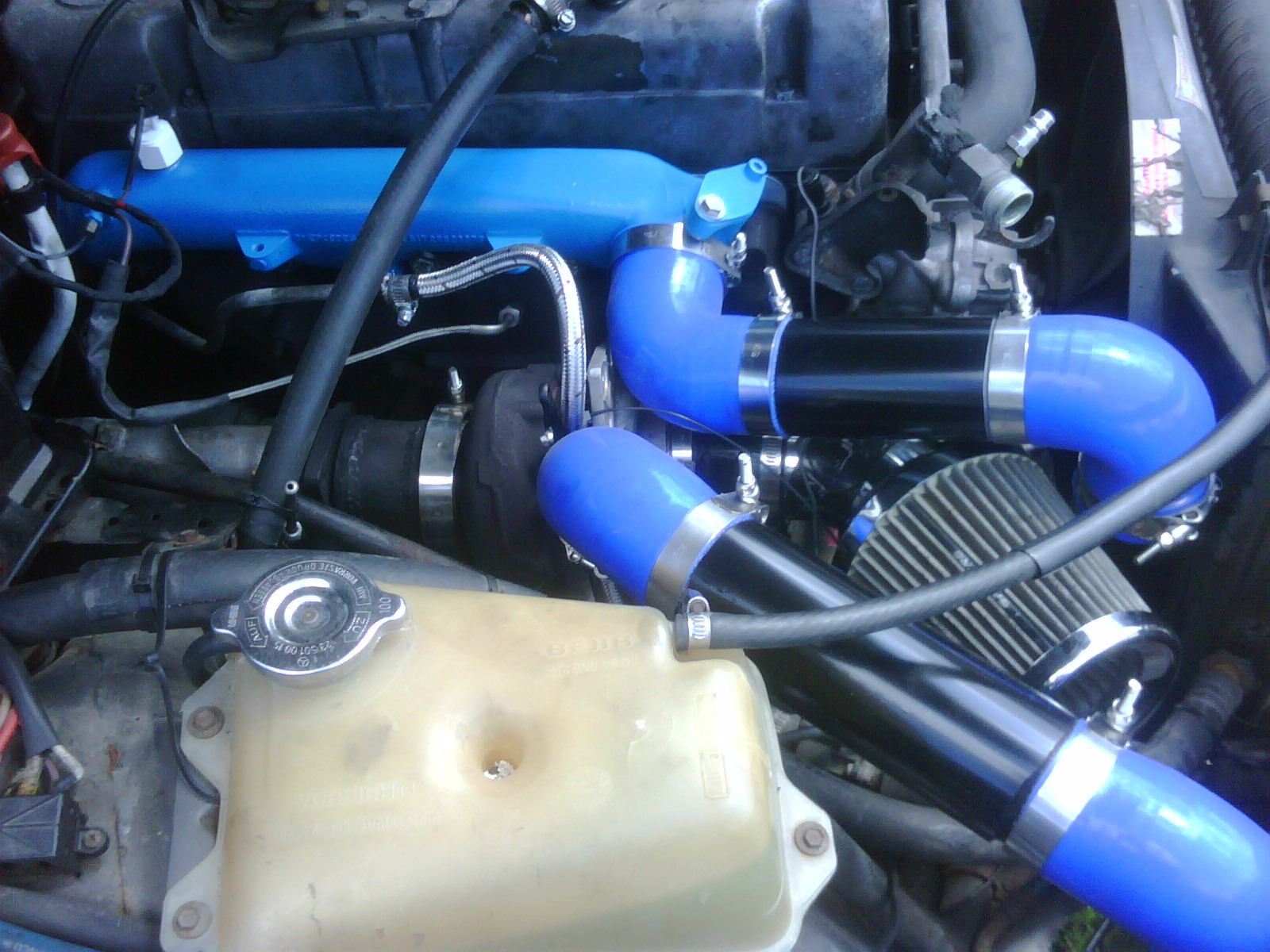

08-31-2009, 08:36 PM #22
I cut off the flare and o-ring parts of the return tubes and pressed a 3/4" low-pressure hydraulic hose between them.

09-01-2009, 08:46 AM #24
I made it with a flex SS piece. Important for me was that I put a small tube into the original drain tube and another larger one as kind of cap in touch with the o-ring of the drain tube.

09-03-2009, 01:56 PM #25
Ended up using steel braided line for feed and return, I started it up last night and so far no leaks. We will see how it holds up.

09-03-2009, 07:18 PM #26
looks good keep us up to date! like the blue paint I did mine red! but it peeled off as it was only good 2 500deg I need to re do it with some 1000deg paint

09-09-2009, 07:56 PM #31
Got it running! Still have a few things to get finished including a painted valve cover that I just finished. But it runs great I have been driving it since Monday afternoon and the response is incredible and EGTs are staying down. Also the engine temp is under control with the new 1600cfm aux fan.

09-13-2009, 01:20 PM #34
How many psi of boost do you expect from this upgrade. I have been contemplating how the vw 2.0 is able to produce such amazing hp and torque numbers and it seems that the biggest part of the equation is boost.
My second question is how to match a mechanical pump to additional boost levels. I am still a bit of diesel noob but it sure seems that mechanical pump issues from gas burners would apply to diesels too. Can you send off a mechanical pump and have it re-calibrated for additional boost levels?
It looks to me that if the 3.0 mercedes was running around 1 bar it would be a serious beast since it looks like the stock boost is about 1/3 of that.

09-13-2009, 08:18 PM #35
well a diesel runs cooler the leaner it get so adding boost won't hurt it as much as adding fuel!
the real power to be had is by adding fuel! but to keep EGT's under control you need to add more air (boost) to keep it nice and cool!

09-14-2009, 05:49 AM #36
That is true, I have not determined the max boost of this turbo since my piping blew off around 25psi, So I have been keeping it around 10psi max. See the entire reason for this upgrade for me was a more efficient setup with better response (not more power) I use this car as a daily driver and I run it on many long road trips so I am trying to squeeze some more fuel economy out of it and run a bit cooler. I am sure if I did the (removing of the rack limiter modification) I would gain quite a bit more power but right now that is not the goal. Maybe in the future, so for now the 123 wagon just looks fast hahaha

09-14-2009, 12:21 PM #37
How did you connect to that intercooler? That one has the click in style hoses correct? I have that same intercooler but I havent come across a solution yet.

09-14-2009, 12:42 PM #38
All I did was order silicone adapters large enough to stretch over the quick connect area to the smooth part and tightened them down with t bolt clamps. No leaks yet and going on week #2 of driving it back and forth to work.

09-14-2009, 02:49 PM #40
as of right now a zip tie holding it on the low side (mainly to get some mileage on it and testing for leaks) I am working on something that will allow me to control from inside the car and switch it so the throttle controls it. On long road trips I would like to be able to turn the boost down for better mileage. I will keep my progress up to date on here.

12-02-2009, 08:03 AM #42
I have been driving the car daily since september and no problems at all, with the boost turned down (8-10psi) I notice better response and better fuel economy. Still playing with ideas of controlling the turbo from inside the cabin - nothing yet.

01-26-2010, 05:56 PM #44
Still running strong, have some issues when boosting 15psi for long periods of time the hose pops off the intake manifold. I got a hold of an other manifold that I will modify and then swap out. Other than that everything is good.

01-26-2010, 08:45 PM #45
Using a t-clamp or worm clamp?

01-27-2010, 06:20 AM #46
all T clamps, but where I am on the intake manifold it is tapered so if you tighten too much it walks off. It works fine for now until I come up with something for the other manifold.
