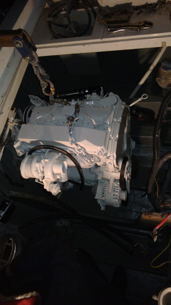

You don't need a water cooled manifold, just good engine bay ventilation... Stock manifold and turbo, a bowman for heat exchanger cooling, one of those aluminium charge coolers off ebay for charge air. Is this on shaft or a drive?
Done a few marine conversion, 1.7 isuzu then mechanically pumped ford tddi 2.0 with om606 turbo's on volvo drives.
Excuse rubbish photo but attached is the marinised mondeo tddi
