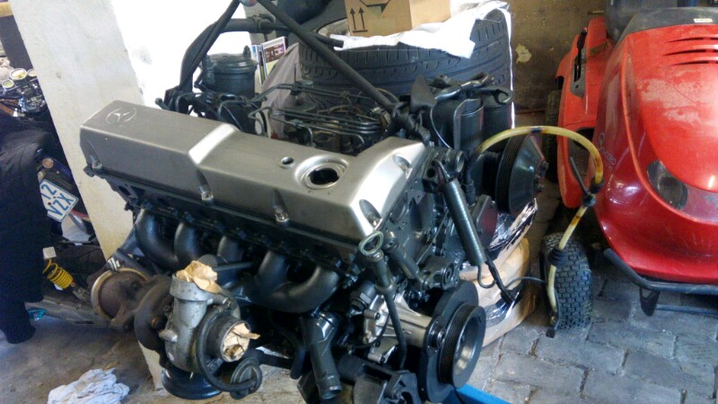

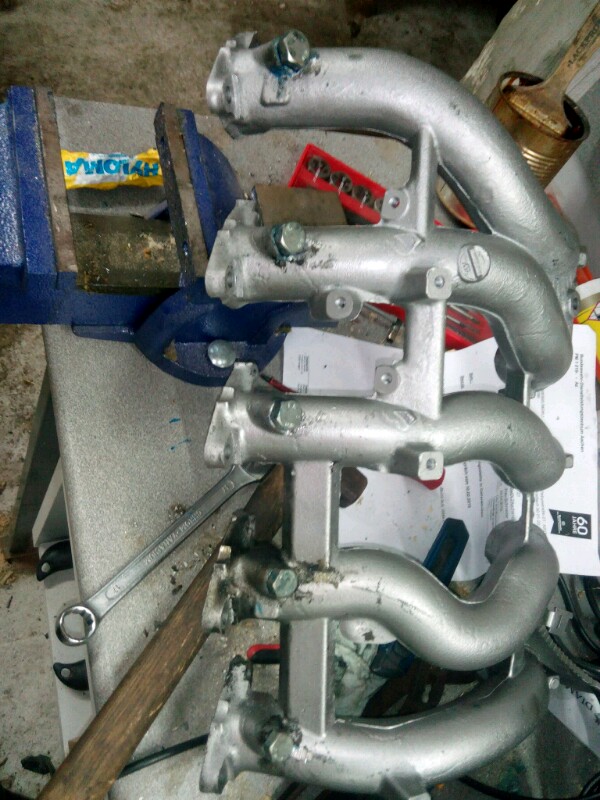

05-11-2015, 06:12 AM #4
Some news after a while.
You guys want to see some pics for sure.
Painted the engine, intakte , fan, and now some 17 AMG wheels.
I closed the oil channels in the na intakte.
Need a good offer Form Goran for 8mm elements and alda for na pump, and from Fred for the flywheel 765pp and clutch and exhaust manifold.
Did someone run a hx 40 in 602?
Hope the 717.430 will hold the power Smile
STDGer

05-11-2015, 04:56 PM #7
Haha how long did the .435 its job befor u broke it? And whats ur setup?Smile
Found a way to post pics Smile
Thats my car
The "New" turbo engine painted in silber grey
An original parts build intercooler fitted intakte manifold
And the big hx40
STDGer
Thats my car
And the big hx40

The budget isnt like the universe, so i will try to use the g intake ( i think the flow would be very nice becouse the ic mount is in the middle of it and it would be shorter than the 290 intake). if it wont fit the 290 intake would be the best opinion Wink
@uli124125

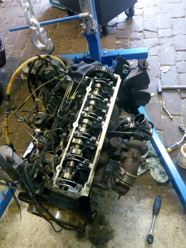

my 124 is na om602, i bought by mkam in kerpen a whole om602 turbo "set" with all the differenz to na so if the turbo watertank wouldnt fit with g intake the na watertank would stay.
On sunday i got a little trip to bochum to meet swatmugga with his red sleeper Cool
Nice working car, good power but fu*** original suspension Big Grin Big Grin Angel
He sold me his Valeo kit, so i think i will not go with the 717.430! I m thinking about 616.654 Wink that would resist any power from 602 to 606. I m not interested in changing gearboxes like underwear!
Another up is, the hx40 is to big for om602 so i orderd a used hx35 ( where could i buy a repair kit for hx35 if theres anything on it?)
If some one is intrested in the nearly brand new holset hx 40 t4 pm me Wink
But there are bad news too,
i have to drive with my merc in holiday in 2 month so the engine change has to wait Angry
