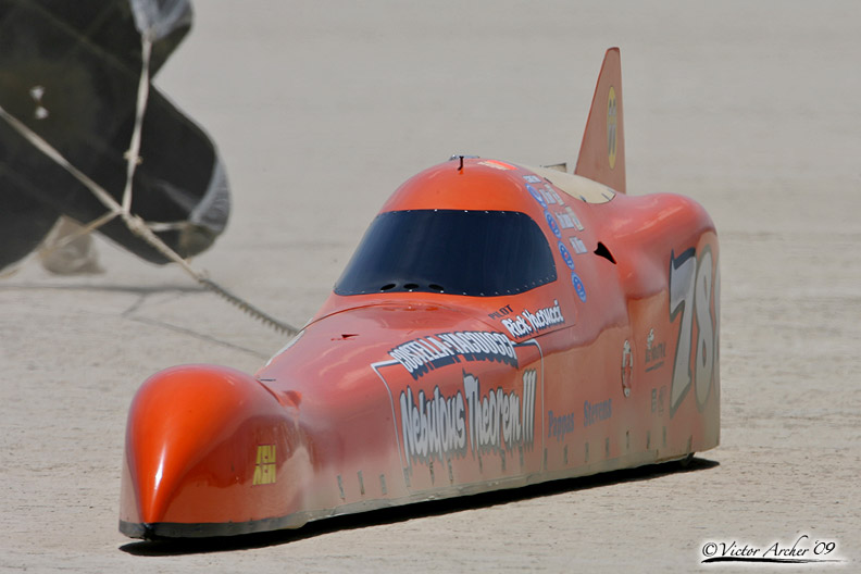

You'll be in for a tough battle and a lot of money. The last speed record attempt used a pair of 750hp 4-cylinder industrial diesels.
A pair of OM606's at ~400hp could stand that kind of run. I haven't seen many Finns do much more than drag racing or drifting, so endurance is questionable.
[Image: 5548_22040612636.jpg]
