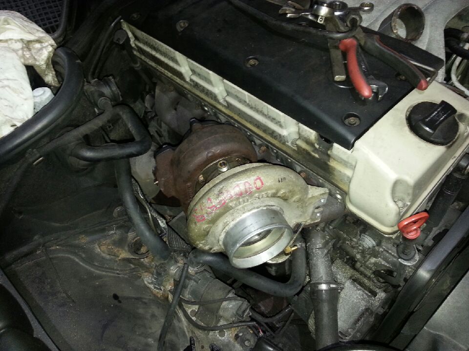

Hello.
Id like your opinion on the position of the turbo after installing adapter.
Im building a stock car. Estate.
Its an avangadre 1997 with avarage chassis but with unmolested inside, motor , gearbox, brakes, diff.
I just purchased it for 1500euro
I have a hx35 with waistgate.
I have dowloaded from internet all needed flanges, triangle for exhaust manifold (will be bigger hole in it by 5mm . The upper part is thick enough.) Than i had a beta version laser cut from available 6mm steel. It was not perfect, so after corrections in autocad we have cut out final version . 4 triangle kkk flanches and 4 t3 single flanches to use up all of the 10mm steel plate. (Let me know if you want one for 10 usd) +shipping
I made the turbo oil cable. The bottom oil line  will be a longer pipe.
I made the new housing 100mm diameter for airflow meter after k&n air filter.
I also have a cheap chinese boost meter installed in achtray,and 10 liters o  valvoline vr1 racing 10w60 oil
We will abso make a water bypass from under the thermostate to 5-6 cylinder as dieselmeken discribed in his video.
I have a guy in Kielce Poland that can do a remap and stage 1 is squizing what we can form stock 6.0 element. I hope 120-130ccm fuel is possible? Stage 2 would be 7.5 mm elemets, but it depends on the money.
Cat out. 78 mm.
What do you think about the position of the engine. I think its too close to engine at least 2 cm. What do you think?

Hello.
Cat out. 78 mm.

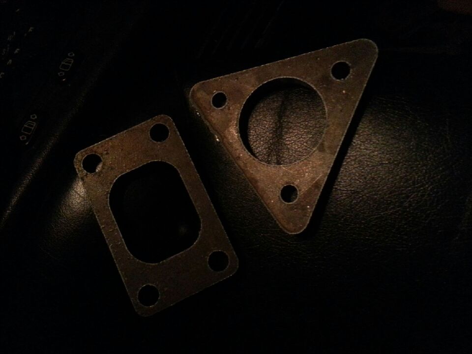

Cześć Erio,z tego co znalazłem to wydajność pompy
- 6mm jest ok 90cc,
- 7mm 120 cc
- 7,5mm 190 cc,
- 8mm 230cc.
Jak  masz flansze dodatkowe to mogę je przygarnąć, możesz zrobić fotkę tej pod holseta??

Picture of flanges attached. Contact on watsup ot sms 606 than 388 and 854. Country 0048
