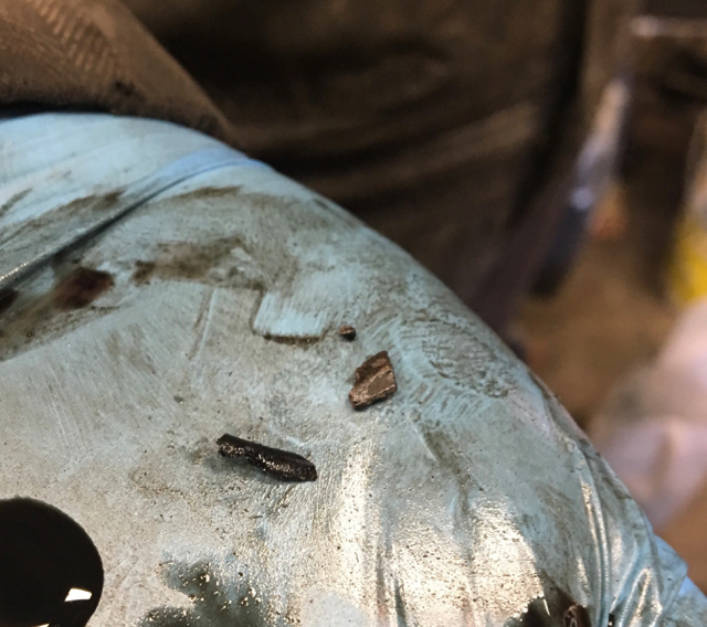

Here are some bits we found in the oil pan.

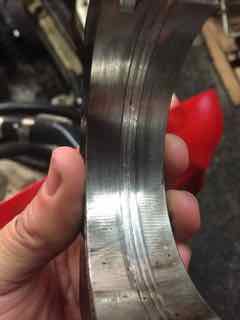

Trashed crank bearing and the crank journal.

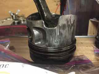

These pistons are scrap

Did coolant get into the oil?
atypicalguy
02-24-2016, 06:35 PM #4

(02-24-2016, 06:35 PM)atypicalguy Did coolant get into the oil?
Surprisingly, we didn't get any coolant in the oil or oil in the coolant.

(02-24-2016, 07:16 PM)Torkey
OK what was the failure mode then?

(02-25-2016, 05:25 PM)atypicalguy
I'm not sure I will ever know.  I wasn't driving at the time of the failure.  What we do know is it was over heated and over revved.  We don't know why it over heated.  Suspecting a bad water pump.

Usually a low on coolant thing. If it over revved, that has to be a pump governor issue I think.

Highly unlikely that the car was low on water (we can't run coolant on the track).  All that gets checked before the car goes to grid.
The over revving happened when the car was being towed into the pits and the driver attempted to bump start it.  One of many bad decisions made by the driver that day.

do you have a egt probe pre-turbo? i did see you guys were running like 26 psi, on a stock turbo. did you block the wastegate? if so then ill bet it was exhaust pressure causing high EGT's and hence failure. just wondering how the egts were cuz that a lot of pressure, and the EMP can cause high EGTS that'll reak havok on the engine. just theorizing here though.

Our turbo is a Garrett GT2860.  Works really well for us.  As for the EGTs we do have a sensors and the EGTs stay below 1200 degrees Fahrenheit.
I agree with what you are saying about the stock turbos.  We did have high EGTs before we changed our turbo.
