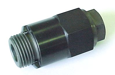

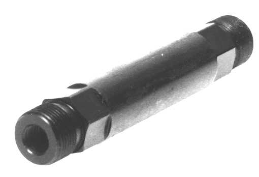

10-07-2009, 12:31 PM #6
(10-07-2009, 11:19 AM)Motorhead Thanks, I was just scratch'n my head as I am looking this 617 over. What is the best place to buy the tools, what other tools will I need for this engine?
You can get good tools from here...
http://www.samstagsales.com/mercedes.htm#diesel
To remove the pre-chamber you'll need the threaded lock ring tool.
615 589 00 07 00
And this tool to remove the pre-chamber itself.
602 589 00 33 02
Or you can make the tools yourself.
http://www.peachparts.com/shopforum/show...hp?t=58446
