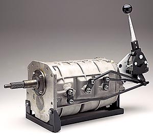

11-01-2009, 09:17 AM #7
how does the shift linkage mechanism work on the GM trannys?
My big problem with these kits is that they can rarely be adapted to an actual mercedes because of the linkage problem. All of them allow you to take a 617 engine and put it in something else, but none allow you to mount the transmission in your otherwise stock mercedes car. If you were to do so, you would have the shifter coming up through the center of the dash.
Whats a common US 5-speed that has side linkage with shift arms?

The only 5 speed I've ever seen with side linkage was a Doug Nash/Richmond "4+1". It's a big beefy tranny and they go for $1500+ on ebay. Plus, I don't think top gear is an overdrive since it's designed as a race transmission.

I skipped all the above posts but a Richmond 5 speed has three levers on the side with an individual arm for each
Those things feel like they are out of a semi tractor, straight cut gears, loud, but unbreakable...

This is the shifter I plan on using for the Tremec...it sets the shifter back about 8 " and should put it in the correct spot for a 126 body.
