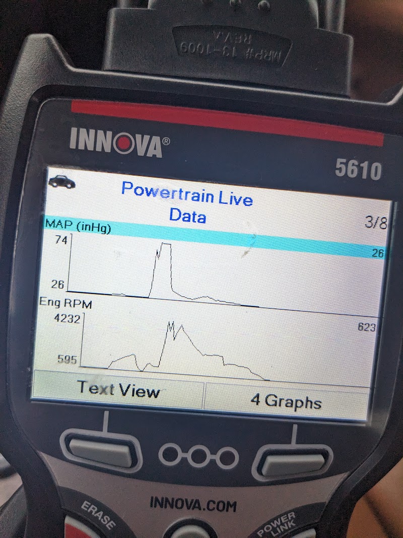

I have a w210 that I recently swapped for in an upgraded hybrid turbo (benzinjectors.com/product-page/om606-hybrid-turbo) with a Sean Tracy ECU to go with it. What is happening now is on even a mild pull the Check Engine Electronics light comes on and it spits a P0235 code (Turbocharger Boost Sensor A Circuit Malfunction). I got a data logging OBDII reader so that I could read/clear the codes but also I could use the live data & datalogging. What I am noticing is that I am hitting the 1.6bar limit on the MAP sensor and I believe that is what is tripping the P0235 code.
You can see in the graph that the MAP sensor is flatlining at 75inHg which translates to 1.54bar / 22.14psi. Keep in mind that MAP sensors read absolute pressure so we'd have to subtract atmospheric from the 75inHg to find the boost. I made an excel spreadsheet that will translate the MAP sensor inHg to boost pressure bar/psi (I am an engineer so excel is my native habitat).
What this feels like in car is as the car is building boost, at the mid-top end of a pull (~4000rpm) it starts to stutter hard. You can see that in the graph that I attached. Once the MAP flatlines the RPMs graph gets jagged. This was all done with the pedal on the mat.
