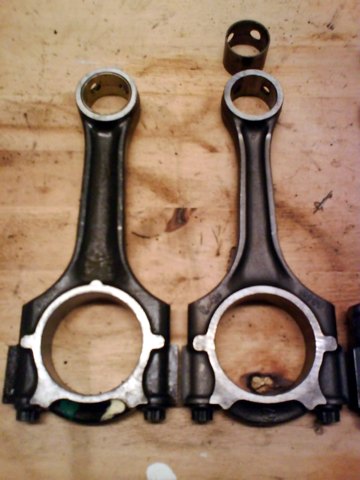

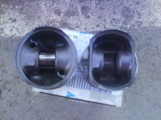

OM606 N/A have`nt got oil-sprayed pistons, neither a place to mount it, no Natrium-filled EX-valves, and weaker pistons and rods, the crank is the same, the rods are the same on 603/606 Turbo, but the pistons must be from 605/606 turbo-engine because of the pockets for valves and "nozzle".
