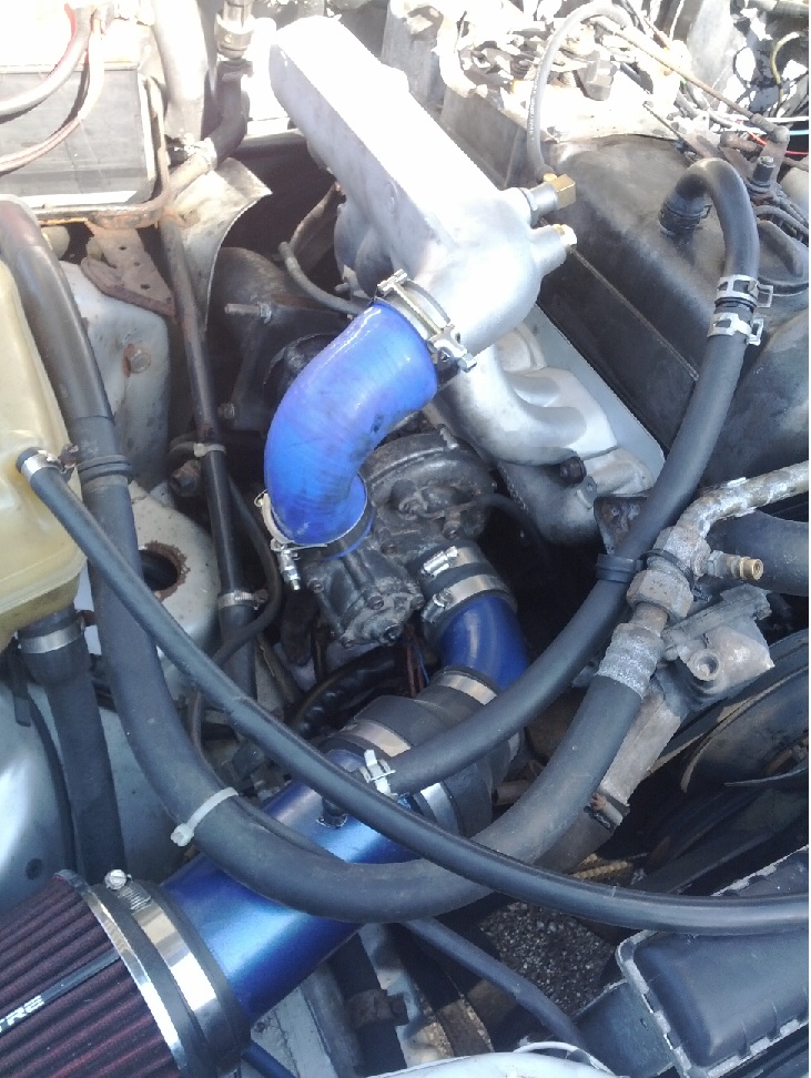

This pic is original w115 manifold no modifications. no grinding, smoothing anything out, just a stock manifold. The two holes I did play with. one hole in it take an m14 bolt, i used a oil pan bolt for some car. the other hole is like an m17 or something that i couldn't find anything for, I tapped the fitting that was there for oil blow by with the same tap I used for exhaust manifold pyrometer. 1/4 NPT. I found a brass fitting that would go into that and that goes to my boost gauge. Some people talk about over boost sensor, i dont know what that is so sorry.
The w115 got in the way of the oil feed line to the turbo. i must have missed that when I read everybody else's builds. I bent that bitch with my hands for over an hour to get it to fit. Can't believe it didn't break. If I were to do the project again I would have some steel braided hose and fitting ready for it. I will likely do that later.
The silicone hose I used was 2.25 to 2.25 with unmodified turbo compressor housing and unmodified w115 intake manifold. I have a kkk turbo but think the garret is the same size. don't quote me.

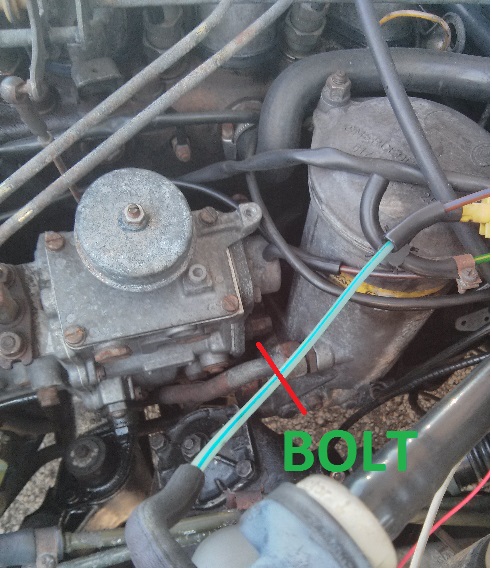

Been looking at vacuum diagrams today but can't find one that leaves the engine bay and goes.to the locks, ignition, etc.
Maybe I don't need a pic for the answer to my question. My car is still ghetto and doesnt shut off with the key. I'm wondering if I can simplify and just have vacuum lines for brakes and engine shutoff? I don't care to diagnose for leaks on this.beater.

RE: Another car, chicago, uhhh 300d turbo w/4 speed manual - JB3 - 04-19-2013
(04-19-2013, 08:22 AM)lgreeley83 Working on car soon :-)
Egr gone, no cruise control, manual trans,
I drove around for I think 5 years with a bit of a twig stuck in that particular boot and the line disconnected.
I can't remember where the other 3 lines went, I think to the other locks but don't quote me, but I can say that the the intersection you want is right on top of the oil filter housing, you usually have to move it aside to remove the oil filter. You can at least target the specific group and go from there tracing colors or coming back toward the main vac line and capping.
Another way to do is identify exactly what you need for engine shutoff, and 86 all the other lines, connections, and valves, really cleans up the engine. Do you have the usual 300D climate control?
For the brakes, as long as the main vac line is good going to the booster with no leaks, then you have power brakes, so keeping that is really about not creating holes in it.

I think this is my plan. I have standard climate control. if brakes and turning the car off is all I need I will go that route.
I think I wasn't clear, I know where the lines are but can't find a diagram cabin side of the firewall. Maybe I didn't look hard enough.

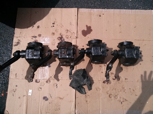

Also dug out the manual steering boxes. Drained them all and put fresh trans fluid in them. They all had a thick oil in them, didn't turn very easily. Now they move with ease. The online book I've seen says trans fluid so I'm cool with that. Might have been an egyptian thing or factory setup?
The ratios all seemed to be the same. The Boxes are all about the same just different part numbers.

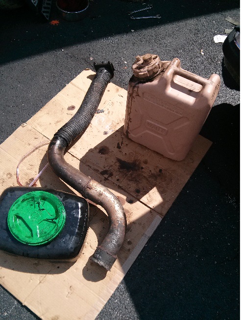

Went with a new downpipe, original setup just at 3". The one on there (prior owner) was ghetto as sh!t. Held onto turbo with a muffler clamp, flex pipe connected it the the rear of the system. Ugly.

Got the manual steering in with much fuss. Broke plenty o' stuff. Ended up replacing the centerlink and driver's tie rods at the same time. I much enjoy more engine bay space. If anybody needs a year old power steering belt let me know. My old gearbox garbage, lots of play.
A little tougher turning than I thought but overall I like it.

So installed that manual steering box you sent me in my 123, I love it. Nice and tight and really not a bother in daily driving. Only thing is I completely botched clocking the steering wheel properly.

Knowing well the back bolt on the IP was going to be a bastard I began that today with mentality that soon the pump comes off. That bolt sucks. I broke it loose but will try a ratcheting wrench.

So before i attempt removal I am concerned with clearance. I don't have a standard turbo pump on my car right now. There is a bolt sticking out of the back cover. Can I remove that along with the shutoff valve? What is it? I think with it there I probably don't have clearance to remove pump with oil filter housing on.
Bolt?
