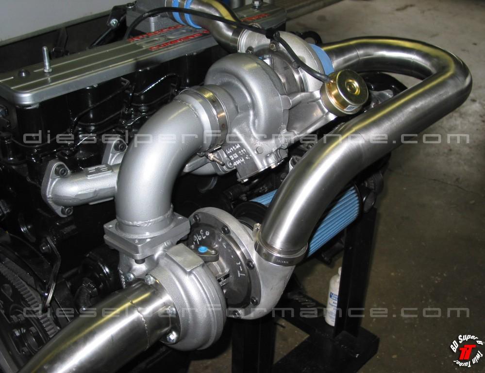

RE: TheDon's OM606 build - EDH_Performance - 03-27-2013
(03-11-2013, 03:39 PM)TheDon saving up now for my 606 NA linkages
[Image: 20121124_210547_zps1e97fe57.jpg]
Build your own, very easyWink
