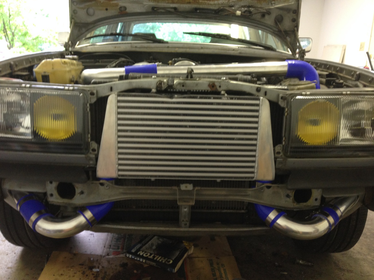

RE: Intercooler picture thread? - winmutt - 10-16-2013
Tito what size IC is that? Where did you get it?
Ray I did verify. The exception is for cars that have them stock which is a pretty stupid exception IMO. Since the wheel upgrade and the last chin tuck I have not had any clearance problems.

RE: Intercooler picture thread? - Tito - 10-17-2013
(10-16-2013, 05:36 PM)winmutt Tito what size IC is that? Where did you get it?
I actually don't know. I can measure if you want it? the outside diameter where the hose slides over is 60mm. That's the only thing I know about it.
I got it from a friend of my who works at a Volkswagen tuning shop. It was in the garbage bin but he took it home. Thinking he may use it some day. He currently building a BMW drift project and it's to small so he gave it to me. Made me very happy Big Grin I also got the 3" exhaust tube from him which i will be fitting underneath my car tomorrow with a Simons silencer.
It could be a home build IC, if i look at the welds. But the mounting holes tell me it's probably universal. I really don't know.

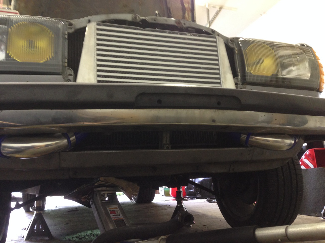

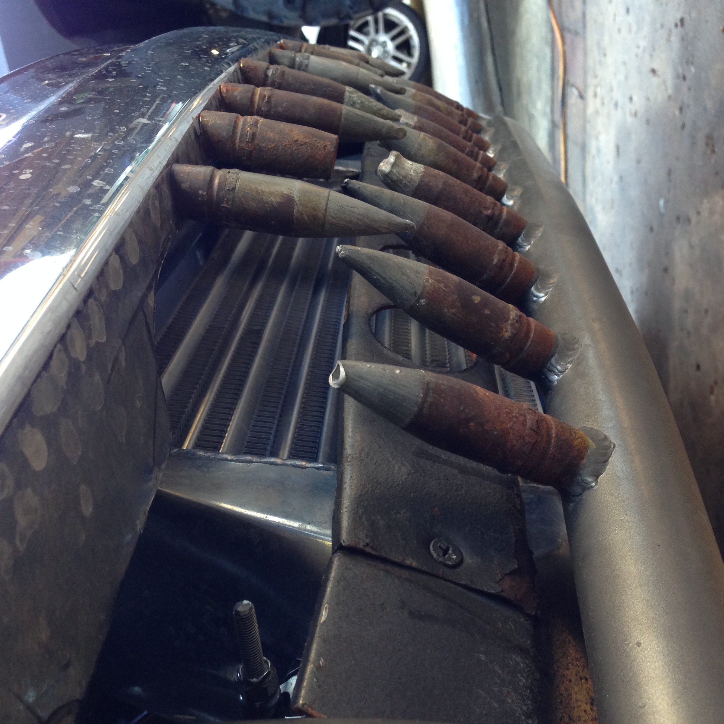

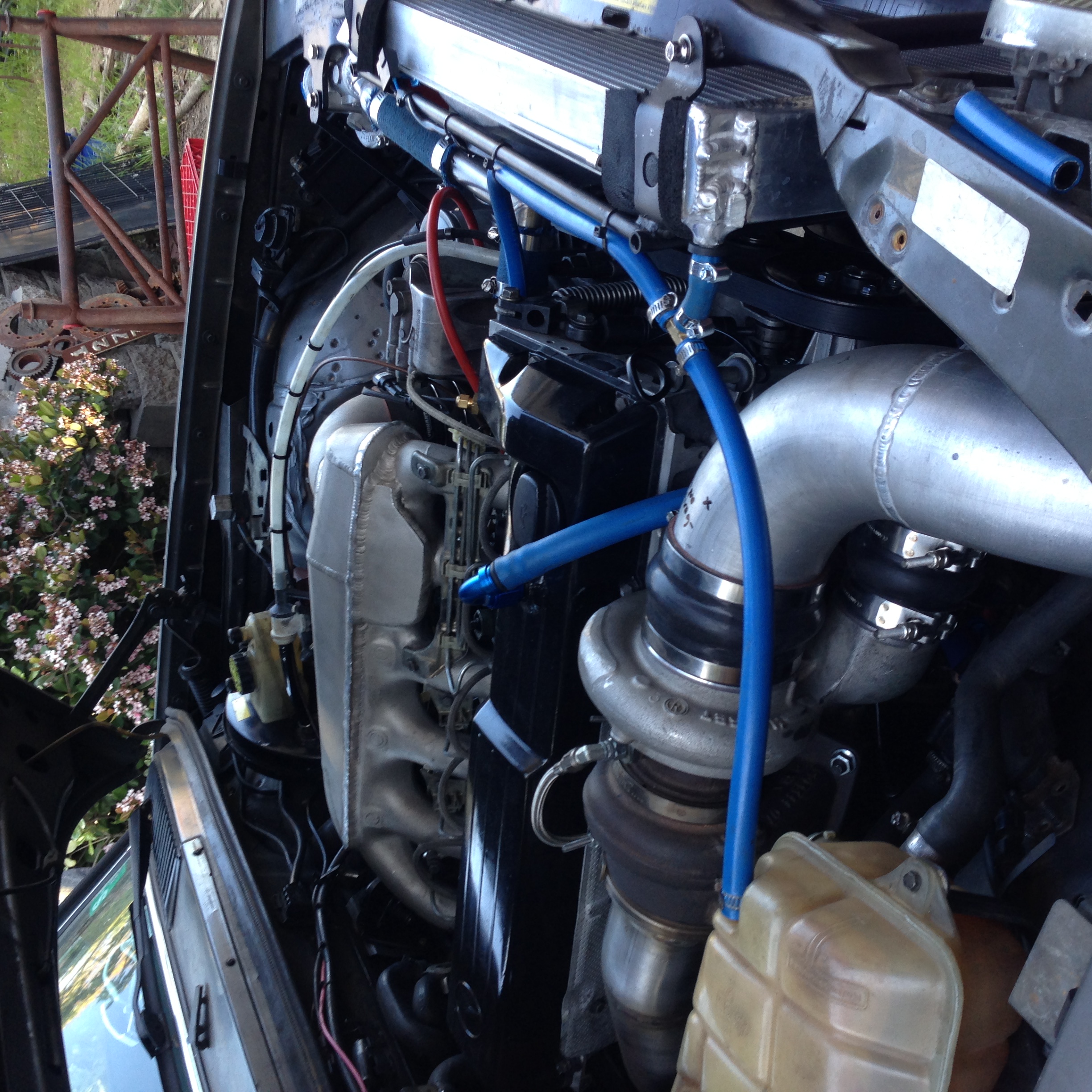

RE: Intercooler picture thread? - led-panzer - 06-04-2014
Front mount Air to Air intercooler on w123, OM617A
Intercooler measurements:
23.75" wide
13.5" tall
3" thick
2.5" inlets both on the bottom
