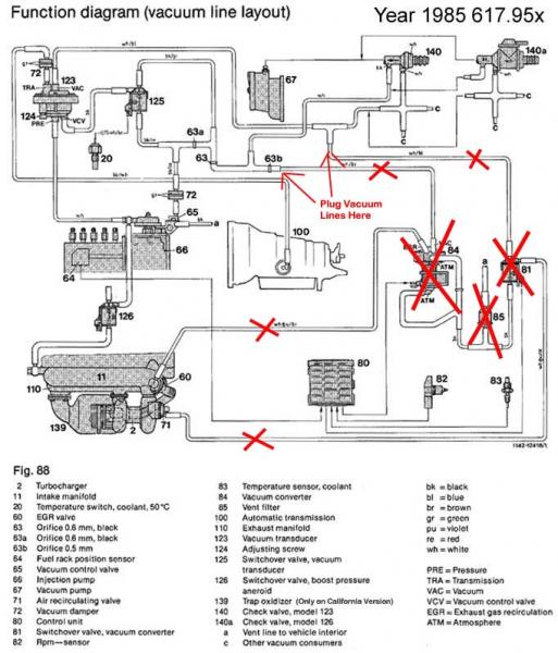

I have most of the engine conversion bugs sorted out from my conversion and am ready to start modifying the engine.
so I'm on to step 1.2 - EGR removal. (for testing purposes off course)
for those who don't know, EGR on the '85 Calif car differs from the earlier cars because it has the "vacuum amplifier" (#125) in the diagram that controls something on the 722.4 transmission. Also this model IP has a few extra inputs compared to the earlier ones (just on late MW pumps or are they all the same?)
The goal is to reduce the vacuum to a minimum.
- remove #60 - EGR pipe, actuator; cap manifolds appropriately
- unplug #71 - ARV
- remove control unit and associated wiring harness (will need to rewire tach,
boost aneroid switchover valve and misc other stuff that's included)
- unplug rack position sensor from wire harness
Still some questions:
This leaves me with a couple switchover valves and the vac amplifier for tranny which though simpler, will still be messy looking.
Do I need the vacuum amplifier?
Which parts of the MW pump do I need to keep hooked up?
'85 California EGR courtesy of Peach Parts
-Christian
RE: EGR removal for '85 California 300TD - DeliveryValve - 01-17-2010
Here is a diagram that I made up to remove the EGR and ARV vacuum line in a stock '85 300SD and 300D models. This leaves the transmission vacuum lines intact so it will have the same functionality as the factory.

(01-17-2010, 05:05 PM)DeliveryValve Here is a diagram that I made up to remove the EGR and ARV vacuum line in a stock '85 300SD and 300D models. This leaves the transmission vacuum lines intact so it will have the same functionality as the factory.
As far as the MW concerned, just leave #64 unplugged.
Wonderful! thanks. I'll ask the question about the vacuum amplifier in the drivetrain forum.
